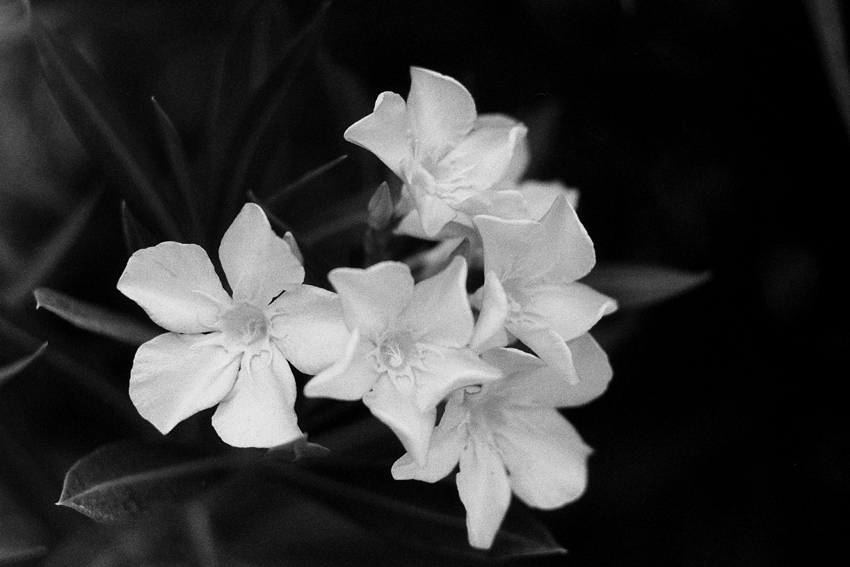

I have: 1 roll of Tri-X that was shot at EI 640, then halfway through was switched to EI 1250. Besides that, there's 1 roll of Foma 200 shot at EI 200, and 1 roll of Foma 400 shot at EI 250. I want to develop 2 of the 3 films together. Tthe Foma 200 is the ringer, I've had zero luck w/ that so far.
The Foma 400 is nice using F76+ for 7.40 minutes (see pic below), so one of those 2 other films is probably going into that same soup. Will that scheme work w/ either the Tri-X or the Foma 200? There's also Rodinal here, but the Foma 400 looked pretty bad in that the one time I tried it.

I went to the Massive Development Chart and decided on developing the Foma 400 and the Tri-X together: F76+, 1+8 for 8 min w/ gentle agitation, probably around 75-80 degrees.
They look great, especially the Tri-X at 640 and 1250. Who knew? I missed the focus on Eileen, she wouldn't sit still, but otherwise the keepers should print nicely. Elvis looks rough because he was taped to the inside of the donut case at the donut store (no surprise there, it a was fitting place for him).
Truly, the stuff looks real good, the tonality and grain look fine. I don't know which is which film w/o looking at the print sleeves, except for the dog. He and the first 9 other frames of the Foma 400 were shot at EI 400, just to see what that looks like. I prefer it at 200.

Looking at my old negs, the Tri x film likes this development, it has a very old school look to it. For the Foma, this was basically my usual development.
The Tri X shots (first one) can look pretty neat if the light is halfway decent, this was taken inside an an apt and I was shooting thru the doorway. It's duped here, I can't figure out how to redo the thread.
The other 2 are the Foma 400. This is a great film, very different than TriX. The sun was literally directly in the frame on one shot too. Grain is tight on the Foma and the Tri X is grainier but I like it. It will likely disappear on a print.
This stuff is scanned on a toy Wolverline "scanner" w/ no PP, and the Tri X was anything but flat. The negs look better w/ a loupe.
