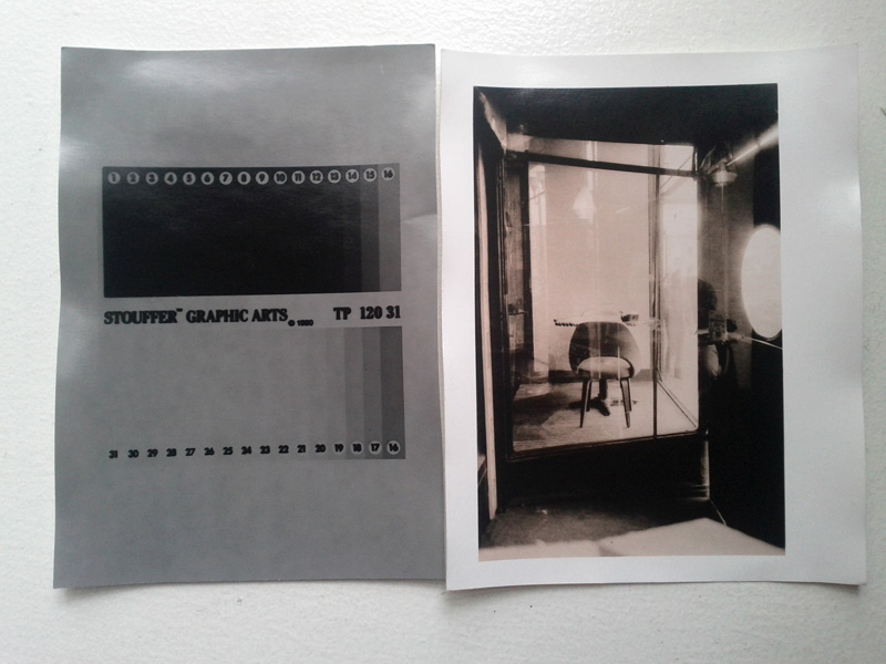

Here's an image I may have shared before:
Dektol with bezotriazole on the left, lith developer (probably LD20) on the right.
The print is not mine, it was made by a colleague of mine, who is a master lith printer if there ever was one. He saw me pitching a box of Forte Polygrade because I felt it was too far gone, and made this print with it.
Some paper can absolutely be saved by making lith prints with; certainly worth having a crack at.
