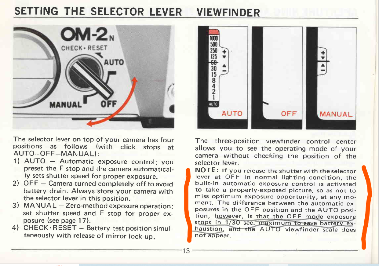

One of the reasons that the auto exposure, single digit OM bodies use batteries more quickly is that the metering circuits are designed to give automatic, off the film meter readings even if you just grab the camera, point it at your subject and release the shutter. Essentially, the meters are always ready for instantaneous use - no need for the operator to even turn the system on.
Still a design flaw in my opinion. I know the legend as to why it was made like that and even if true, I'd much rather have a power switch. Standard OM-2/2n, even when turned off, still manage to expose correctly at certain range of speeds. Can't recall if it was between 1-1/60th of a second, or 1/60 and above though.
On the other hand, can't say that I'm a fan of power switch on Nikon FM/FE either: wind-on lever poking into my face (I'm the left eye user) is not much fun.
The OM-2/2n use the same "always instantaneously available" auto exposure system.
From the OM-2n manual:
Even I, a staunch detractor of the OM System, will have to concede that this is a genius idea.
This also means that the electronics are never off, but that isn't a bad thing. Yoshihisa Maitani mentioned (on an interview regarding the conception of the OM system) that he prefers cameras that have no shutter button lock, because they should be always ready. I prefer shutter locks, however his point of view is totally valid. Thus, it's logical that the camera electronics shouldn't be able to be turned off.
