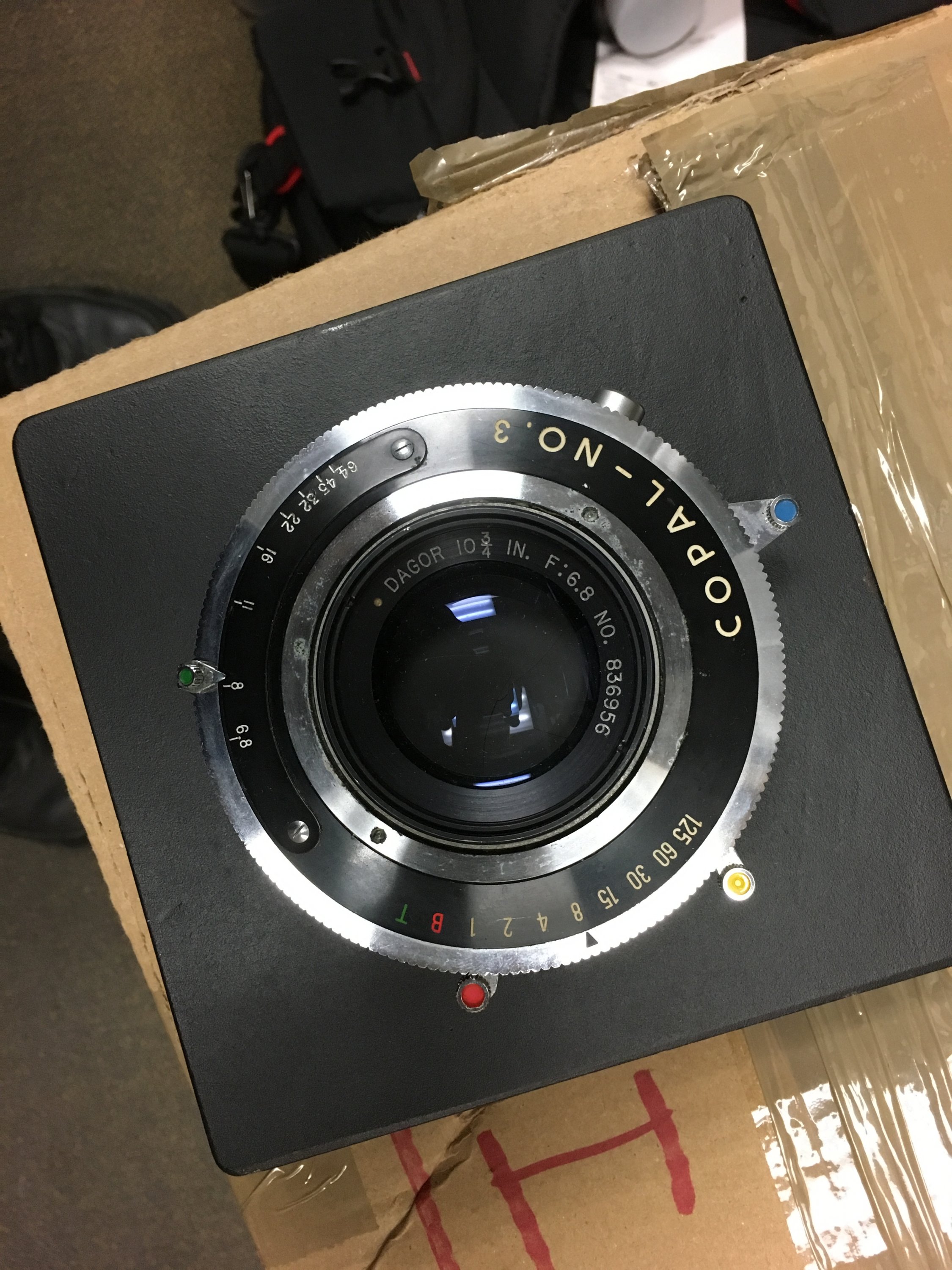

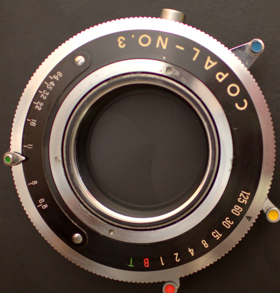

Once you have possession of the camera remove the front lens cell from the shutter, left hand threads, and post a picture of the shutter ensuring the center of the shutter and face plate are sharp.
There are several different ways face plates are retained to the shutter. The speed ring sits under the face plate. All shutters use the center threaded collar to attach the face plate but its not standardized. The speed ring and face plate have to go in precise positions. Levers and pins go into slots in the speed ring and are likely spring loaded so they will go beyond their slots when the ring is removed. I don't recommend opening it if you are not familiar with shutter servicing.

Here are the pics. It appears to have two holes for a spanner but it didn't want to move, but I didn't use all my force. I applied lighter fluid with a Q-tip around the edges and it freed it up a little for a few seconds, so I just think it's gummed up and taking the ring off and cleaning it should work.

If the speed cam is gummed up like that... so is everything else.
Please don’t...

Set the speed dial to T, aperture to 6.8, shutter released. This is the starting point when disassembling any shutter. Note the position of the speed indicator. Throw the lighter fluid away and get some 90% Isopropyl Alcohol.
Apply some nail polish remover between the chrome ring and shutter collar, let sit 5 to 10 minutes, use a blunt tip spanner in the indents in the chrome ring and turn counter clockwise. Count the number of turns needed to remove the ring.
Lift the face plate off the shutter then if necessary lift the speed ring off after taking a picture of it on the shutter.

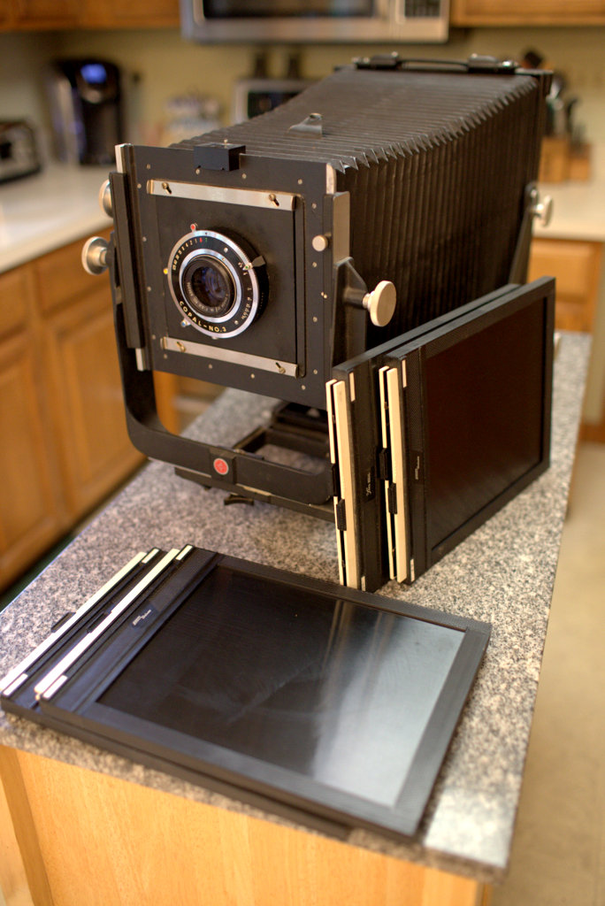

Here is what I bought for $321 including tax because of the shutter ring binding.

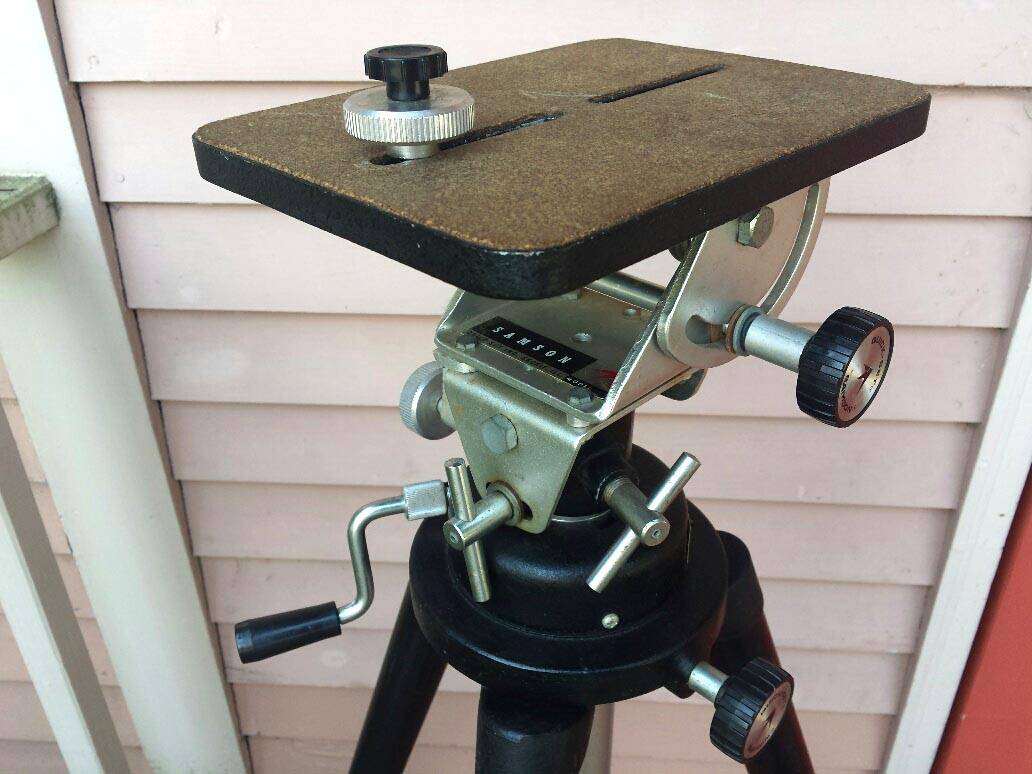

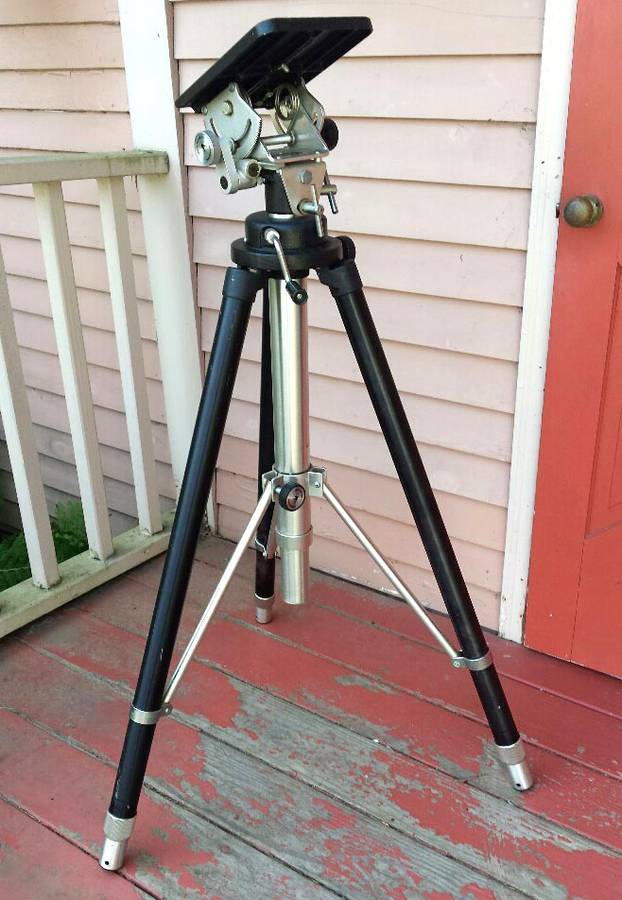

you might search ( here on this site ) surveyors tripods
you can get them for cheeps and modify them to work with your camera ..

Would this work and what would I have to get to modify it?
Well your significant other won't like the holes and scratches left by the spiked feet but the big problem is the 5/8-11 mount thread and the hand truck to move the tripod about. Cameras have either 1/4 - 20 or 3/8 - 16 threads. The camera mount can't be increased so you will have to reduce the 5/8-11 or replace it, likely easier said than done.
