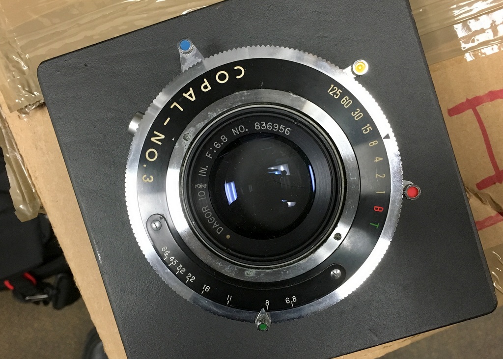

I am picking it up tomorrow at lower price because of the stiff shutter ring. I read somewhere that the ring may just be gummed up and easily cleaned. Here is a picture of the actual lens and shutter. Does anyone know how to remove the ring for cleaning? It looks like there might be two screws.

Repair information and guidance is available on the internet. It is often discussed on forums. Google around and you’ll find it. But the shutter sounds like it needs a complete overhaul. Pay now for a pro repair and reap the rewards of years with reliable service.
Dagor looks nice and the Copal 3 looks pretty clean, I'd definitely get it professionally CLA'd, but that’s just me. Just about every LF shutter that I use regularly has been CLA'd. For the price of film and my limited time for photographing I like to have nice running shutters that I can rely on. It also protects my investment in the shutter, properly maintained these shutter will last a long time.

Once you have possession of the camera remove the front lens cell from the shutter, left hand threads, and post a picture of the shutter ensuring the center of the shutter and face plate are sharp.
There are several different ways face plates are retained to the shutter. The speed ring sits under the face plate. All shutters use the center threaded collar to attach the face plate but its not standardized. The speed ring and face plate have to go in precise positions. Levers and pins go into slots in the speed ring and are likely spring loaded so they will go beyond their slots when the ring is removed. I don't recommend opening it if you are not familiar with shutter servicing.
