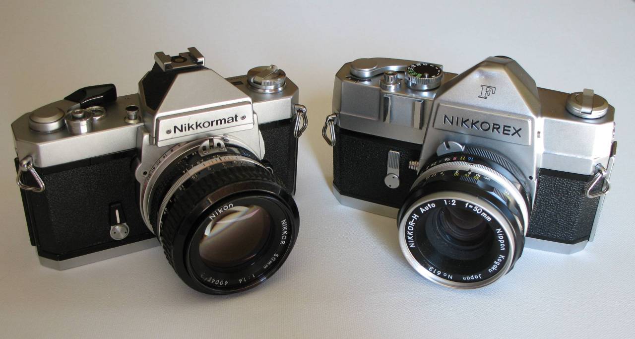

Nikkormat FT3 and Nikkorex F
I always wanted to have a Nikkormat when I was a teenager. By the time I was in graduate school I settled down by a FE and then got a used Nikon F. After many years, now I restarted BW film processing again and I have a renewed interest to obtain the older Nikon bodies. First I got a Nikkorex F next to nothing from the auction site then I won a Nikkormat FT3 body paying again next to nothing. The sellers description was "Works Fine" which really meant shutter was working, actually the AI ring was jammed and the battery was oxidized so meter wasn't functional. Anyway I took my chances and disassemble the F mount, re-seated the AI ring and tightened the inner screws, put a new silver battery in and cleaned the sticky foam particles from the mirror. Now the camera works like a charm and the meter agrees totally with FE. By the way there is no comparison to Nikkorex F (the shutter sounds like a shot-gun) and compared to FE I think Nikkormat was very robust and made with more precision like Nikon F.
lxdude
Apr 8, 2009
7,094
Redlands, So
I love that the shutter speeds are set by a ring around the lens mount. Is it so fun!
Careful now, don't handle an OM-1 or you'll be swooning! :D
I love the way it handles (and its viewfinder), and while I need more cameras like I need a hole in the head, I have this feeling that an OM-1 and some of those little Zuiko jewels will have to become part of my life eventually.
Sorry to subvert the thread. On topic: I used to have a Nikkormat FTN. Solid and serious, is how I described it. Sold it when I got F2's.

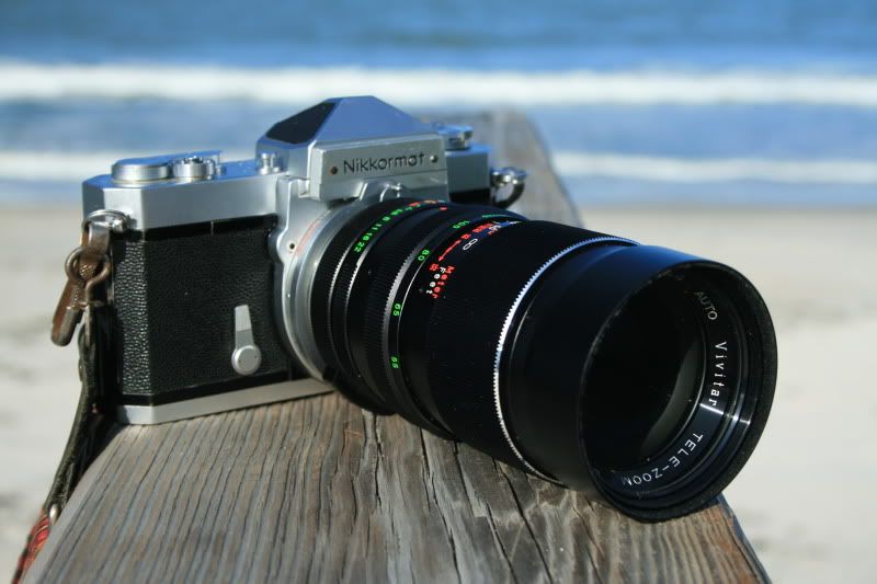

Here's mine. Just polished off a roll of Kodachrome KR64, 3 more in the mail coming and two of them are going in this camera, the 3rd is for my Minolta Maxxum 4 which is the sharpest 35mm in my group (haven't developed anything off my Canon Elan7e yet)
There's a datestamp from Jan. 1990, I think it had a CLA done because the seals are like new and everything is smooth as silk. I've put about 10 rolls through it.
Lenses are:
55-135 f3.5 Vivitar (pictured)
50mm Nikkor-H f2 (needs SERIOUS love)
28mm Albinar ADG 2.8 macro
35mm f2.8 Nikkor
28mm f3.5 Nikkor-G
28mm 2.8 Rokinon
80-200 f4.5 Rokinon

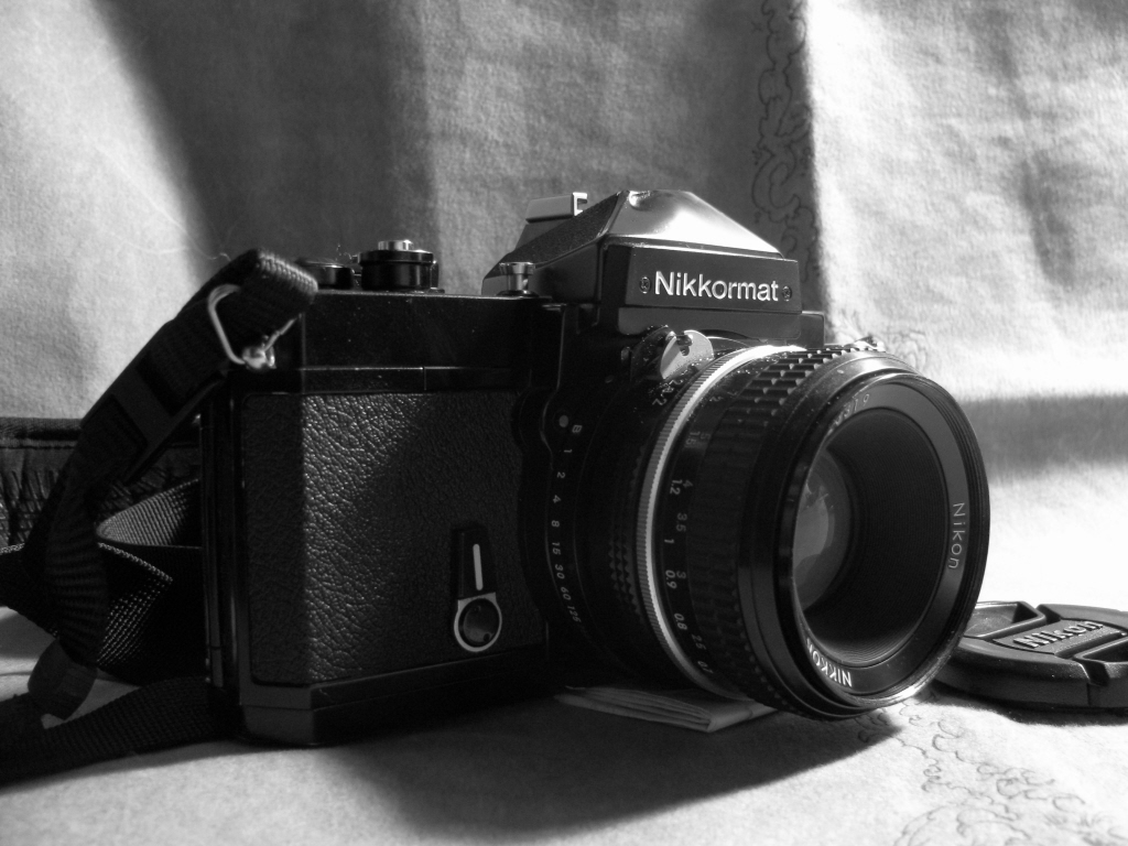

This summer I was given a silver Nikkormat FTN a Nikon F and Nikon FG along with a few lenses.
The Nikkormat is a beautiful piece of work. It is very clean, solid and works great. The period lenses for the F and FTN are the Nikkor-S Auto f1.4 50mm and the Zoom-Nikkor Auto f3.5 43mm-86mm.
The eyepiece for both cameras are missing. For the Nikkormat, I bought a rubber o-ring of the appropriate diameter at the hardware store and glued it to the camera so it can rest against my glasses.
I wasn't sure how I would like the shutter speed selector, but have adapted to it quite easily.
