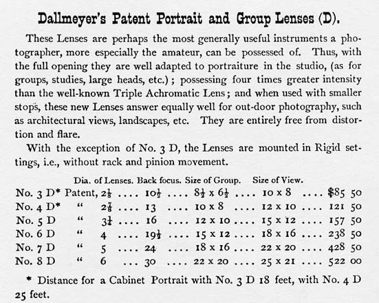

I have a Dallmeyer 5A (f4) from 1870 which was rated by Dallmeyer for 15"x15" plates. This lens has a 127mm front lens. Dallmeyer recommended 19" lenses for 10x12 plates, so we can assume that this lens would have a 120mm front lens. Still quite big...
When stopped down, the petzvals cover without too much coma. So Dallmeyer even sugggested in the 1870s that a 19" lens for 10x12 stopped down a could cover 12x15. I am not quite sure that I would agree with Dallmeyer here, as my experience suggests that Petzvals illuminate a field slightly less than their focal length.
Attached is a Anthony's catalogue from the early 1870s (provided by Sean MacKenna) which lists coverage for Dallmeyer 'D' type f/6 Petzval lenses.
