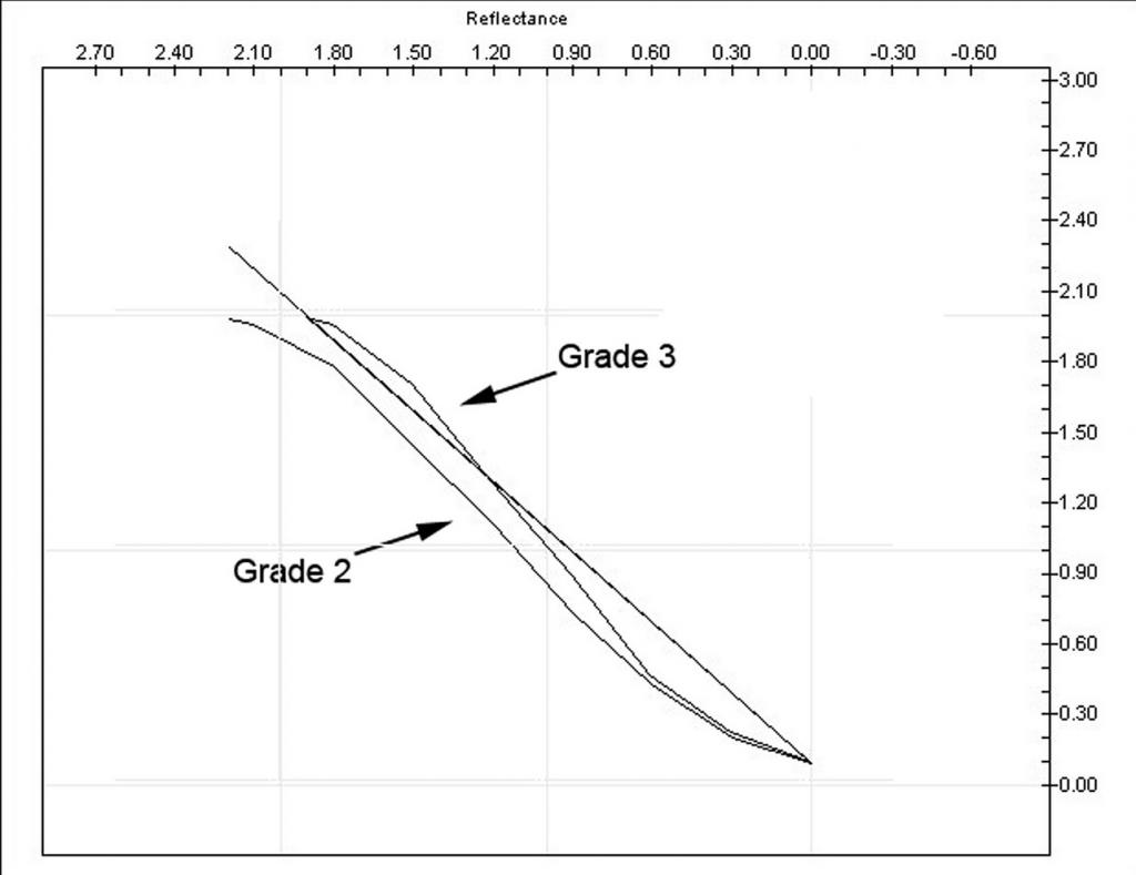

Not much to gain or lose by favoring Grade 3. Here are Grade 2 and Grade 3 tone reproduction curves posted by Stephen Benskin a while back.
I assume the curve represents the results from a single (common) negative calibrated to grade 2, rather than two negatives with one calibrated to each paper grade. If it were the latter case then the illustrated curves should (nearly) match.
Sounds like you are calibrated to grade 3 Ilford Gallery DW fiber already. :wink:
Sorry, I posted the wrong curve.

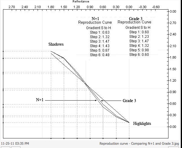

Correct curve from Stephen Benskin for my post above. Shows tone reproduction curve for same scene and two different negative developments (N and N+1) and two different grade paper (2 and 3) (Image Reference: (there was a url link here which no longer exists))
That makes more sense.
