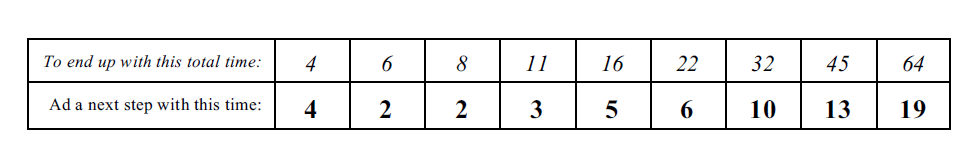

Foot switch user here, and here is my 1/2 stop progression test strip guide:
And yes, 6 is a round-off of 5.6.

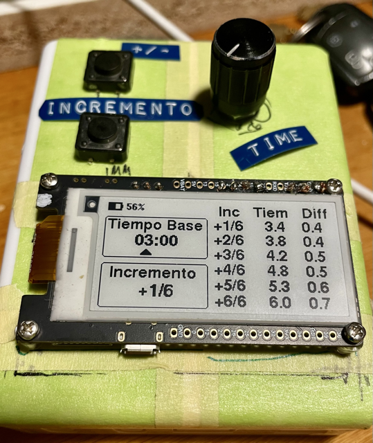

I wanted to share a simple design I put together using modern tools. The paper might be basic, but this e-paper display is absolutely awesome for the darkroom! Right now, I’ve set it up with f-stop increments for 1/4, 1/3, and 1/6. The rest is super easy to calculate, and I even added a button to switch between (+/-).
It’s all based on a starting time, and everything calculates from there. I’ve compared it to the tables, and it’s spot on. I’m really excited about how well it’s working!
