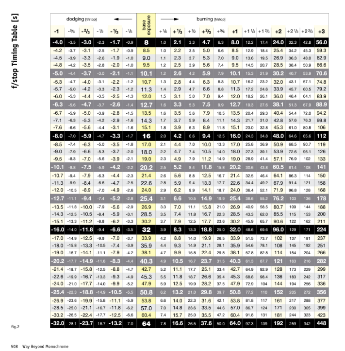

Matt feel free to post it here or anywhere. I prepared it for the darkroom community to help, but I need to stress that an f/stop timer is a precious investment, making the process much simpler and more enjoyable (and no, I'm not being paid to say this).
+1
I spent a year working from Ralph's table pinned right next to the enlarger, with the added time calculations penciled in. Worked quickly and wonderfully, as after a while you have the amount of time to add at each interval memorized.
Finally got an f/stop timer. Not only did it simplify the process, it made it much more precise. Even the usually dreary task of making contact prints is now a breeze, and I always quickly nail the perfect exposure for them.
I would have to concur. When I finally learned about f-stop timing and ultimately bought one, my thought processes on print exposure manipulations began, rather quickly, to be uniquely linked to the one-stop zone changes that define the exposure scale from solid black to solid white, as well as those fractional changes in print tones. It played out for me just as @MattKing indicated in his post. Whereas before, I knew I wanted an area to be lighter or darker and I would dodge a few seconds then burn here and there a few seconds to try and get what I wanted by just estimating how long a manipulation I should give. I have to give DA a shout out for their f-stop timer..........and no, I'm not being paid to say this either, it's just a fact. I understand the percentage approach, but it doesn't carry with it.....for me.....that mental link between stopping down and opening up of the aperture and the action of setting, say, a one stop more or less change of print exposure on the f-stop timer.
Happy to do so. Both as a graphic in the thread, and an attached pdf.

+1
more than glad o hear that.

I'm still on the hook for adjust contrast grades and stuff correctly. But we'll see how long I keep printing for with the current setup before I figure out a pattern I mess up often enough for me to justify finding a way to pull that into a unified control interface...
My timer runs its EV scale backwards, and assumes f/1.0, but that was just for convenience of the notes and interface. My timer doesn't have a link back to the enlarger's aperture, I have no desire to use my enlarger at less than 1 second, and dropping the negative sign saved me a character on the LCD, so it works just fine for a compact time notation that scales easily.
And I'm another user owing thanks to Ralph Lambrecht and their chart. While I'm not directly using the chart anymore I still have a copy next to the enlarger. They helped me put two and two together on the whole 'an enlarger is just an inside out camera', and it just makes sense to work with it by stop values.
snusmumriken
Jul 22, 2021
2,704
Salisbury, UK
I’m a scientist, so I’m in favour of precision. But you guys must be incredibly quick getting your hands or dodging tools into place if you are measuring fractions of a stop with a timer. Or maybe you have a foot switch. Myself, if I have to dodge or burn, I use a metronome. It isn’t terribly, but to the eye the result is repeatable. And I use seconds rather than f-stops. I guess I’m just a heretic.
