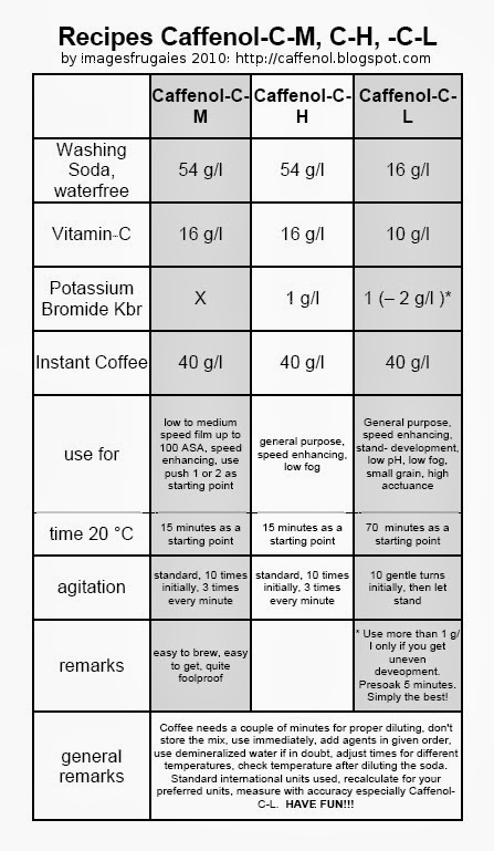

If you want to keep it simple, try the Caffenol-C-M recipe for B&W films up to ASA 100. This recipe doesn't need Potassium Bromide (KBr) as an ingredient. Just dark, strong coffee (Robusta type), vitamin-C and the right kind of soda. I've used this recipe with great success for Ilford FP4+ and Fomapan 100.
BTW: Use washing soda, not backing soda. And if you can't find waterfree soda just use 3x the required amount (compensating for the incorporated water). The results are the same. For more info see: http://caffenol.blogspot.nl/2010/03/soda-myth-and-truth_07.html
Here is a simple table for Caffenol recipes:

The Potassium Bromide (KBr) is needed for some films (like Tri-X) to control/avoid fogging the negatives.
That's why the Caffenol-C-M is only suitable for films of 100 ASA or less.
