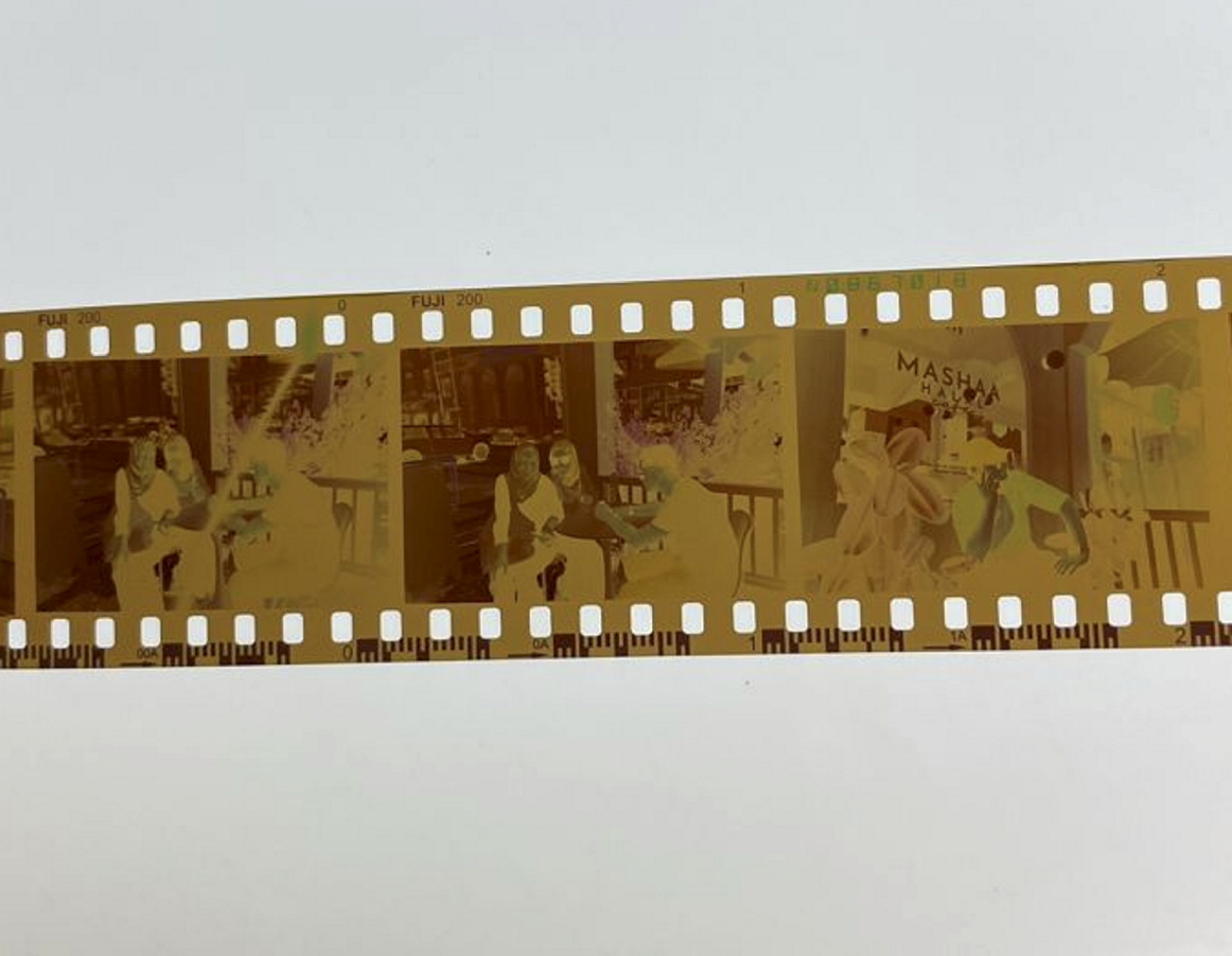

Hi there ..
i got inquiry on my developing film ... im using noritsu v50 machine ..just replace with new developer (CD) >> refill with fresh on replenish tank and Main CD TANK (18.1 L) .. i maintain BLEACH, FIXER and STB chemical at the machine .
i put in Starter 120ml ( 6.7x 18.1 L = 120ml) .. and i Heat the machine back .. start for developing ..
and i dont understand why the result like this .. what's problem
for reference : below was 5 days back , negative on the top is the latest

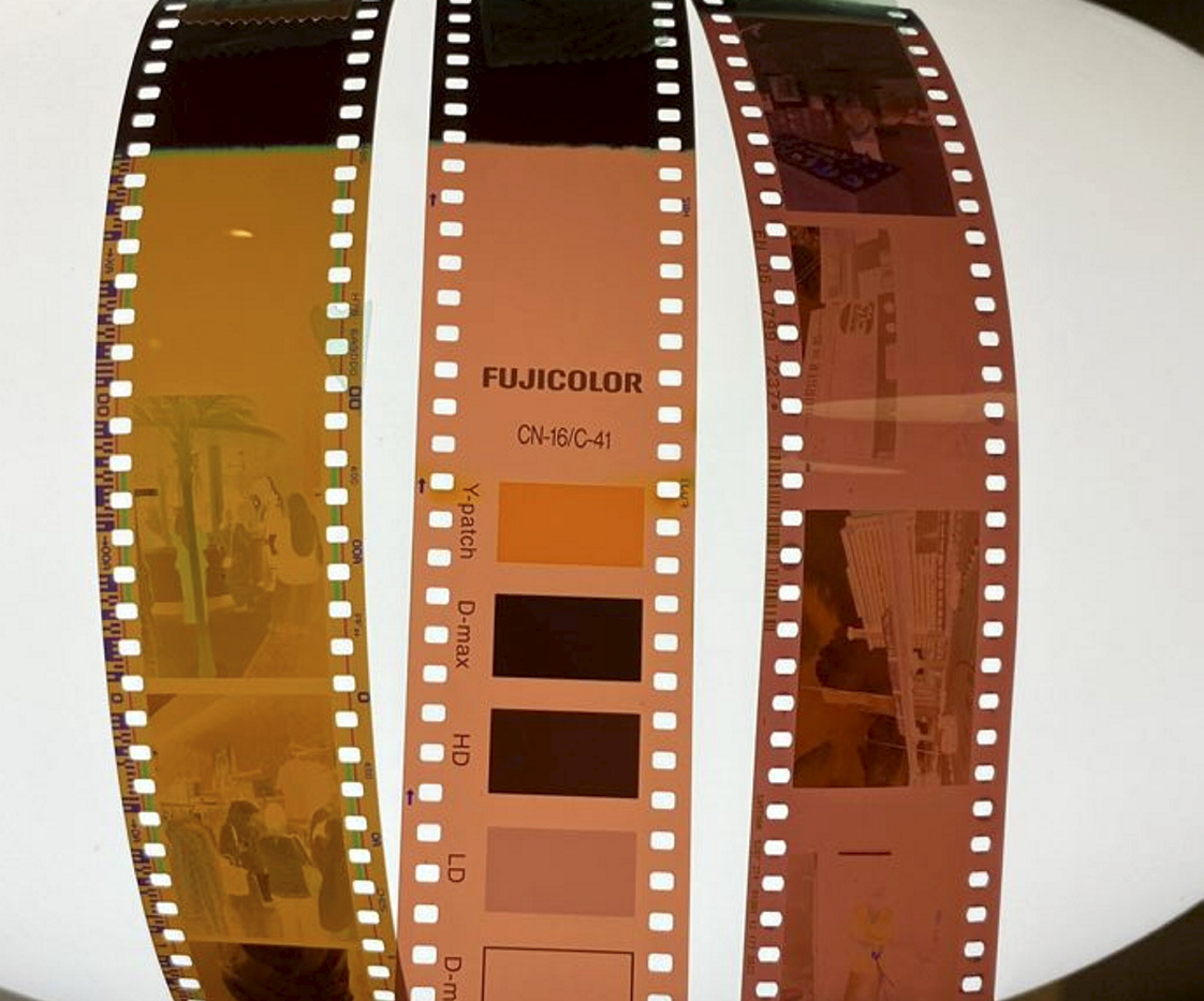

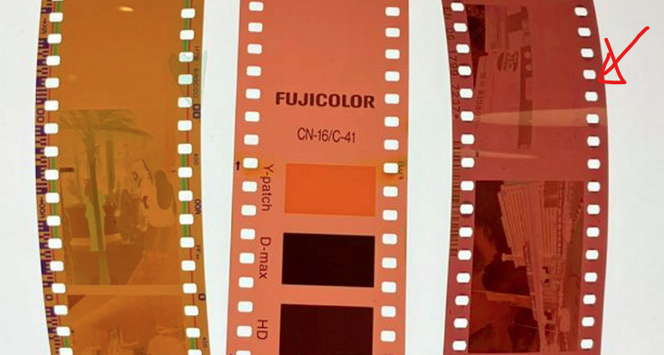

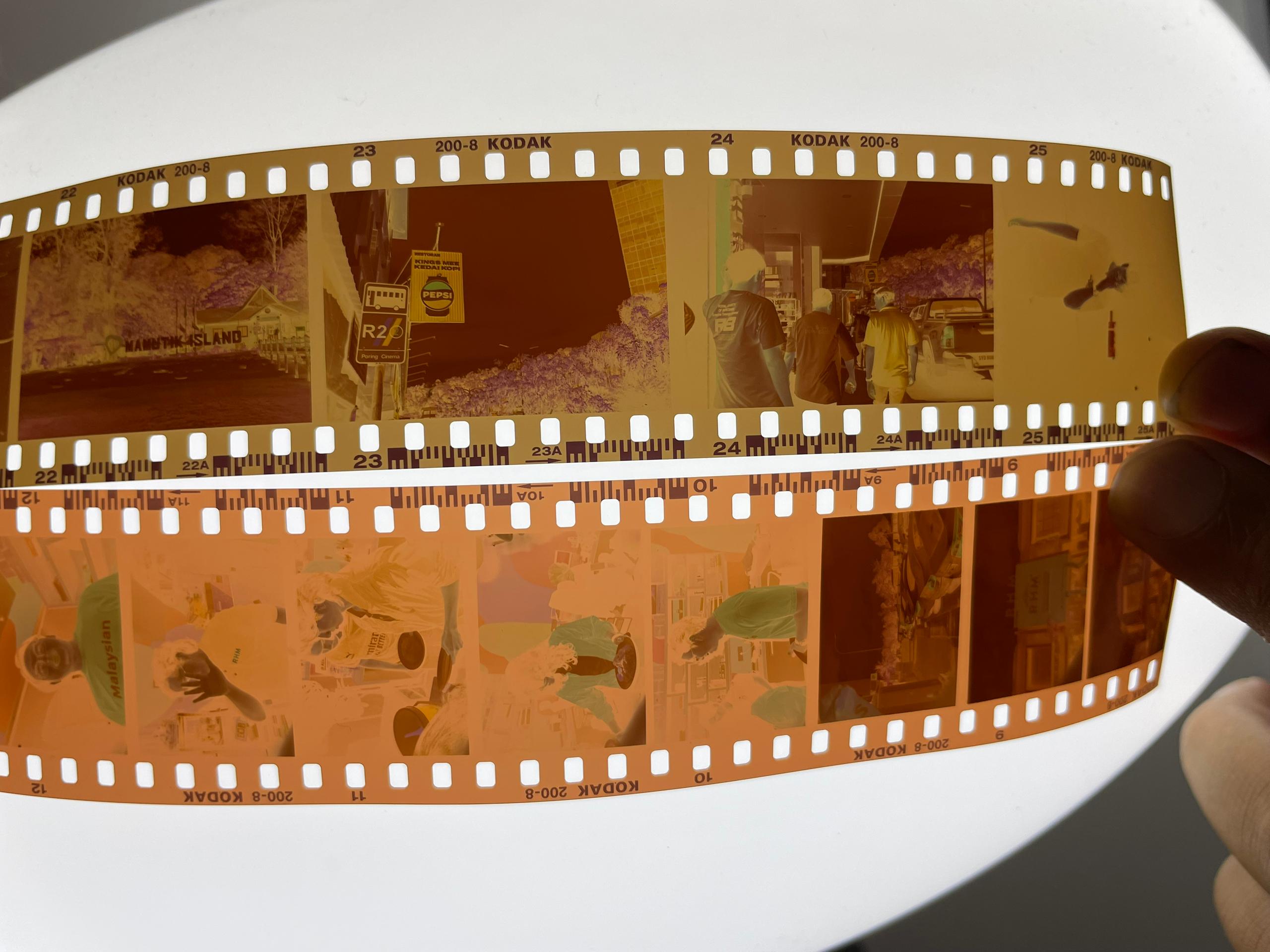

i attached 2 photos of film negative ;
- first photo : from left ; result of negative from my last develop yesterday, middle negative is a control sleeve, and on th right , my negative film after i drop out Bleach 1.8L and top up with fresh bleach .. the closest color to the control strip .
- 2nd photo : the next film negative after the first one was develop ..

my question here , does any indication we can identify the problem based om color of negative ?
This one:
That's a strip of Kodak Vision film, i.e. ECN2. Its base color and gamma will be off if you run it through C41. It's an unfortunate comparison with the C41 strips to the left of it. Stick with one type of film during testing; you'll drive yourself crazy if you also include wildly different kinds of film in your testing. Get everything to work reliably with just regular C41 film first.
If you see a dramatic reduction in quality shortly after replacing the bleach, it implies that there might be occurring a big amount of developer carry-over into the bleach. Have you verified that this isn't happening and that all rollers etc. function properly, are clean and free of damage?

Sorry, I can't tell you where the problem is only based on the photos of the film strips you've shown. You'll have to come up with a lot more specific information.
ohh yes its true .. the c41 negative comparison are kodak Vision Film with remjet removed .. but the the second photo are KOdak Colorplus .. u managed to spot it .. damn good ..
It's easy to tell; the sprocket holes are different. And I recognized the red base color. Btw, the red base on the Vision3 film looks pretty normal for Vision3 processed in C41. But because it's so dense, there's a good chance that the problem that you saw with the next roll was already there and it just wasn't visible on the Vision3 roll.
