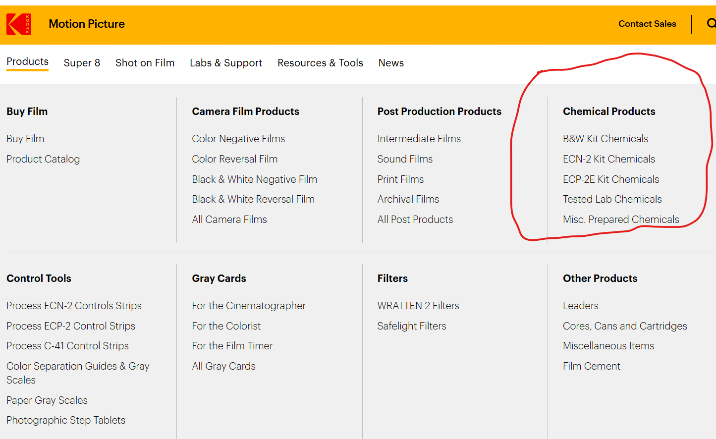

Better to use the past tense like Rudeofus, Eastman Kodak doesn't manufacture photochemicals since very long time ago. Companies like defunct Tetenal or current Photo System purchase ingredients and mix them according to a recipe. Synthesis is done by chemical companies normally in Far East plants.
This isn't quite true, as there still is some "production" of motion picture chemicals - see here: https://www.kodak.com/en/motion/home/.
And in particular:
And specialty chemicals in general: https://www.kodak.com/en/advanced-materials/product/specialty-chemicals/
