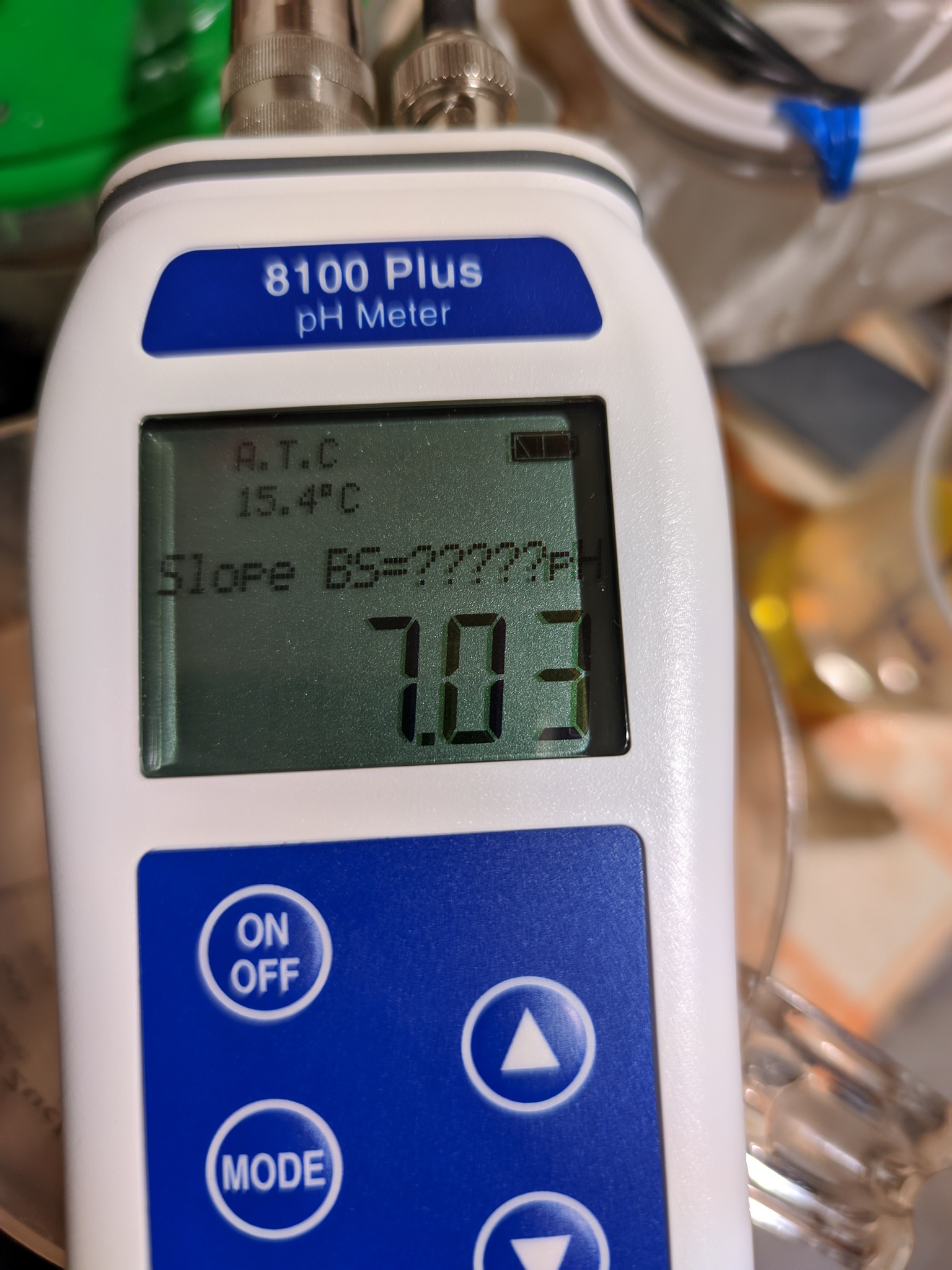

lamerko
Oct 27, 2022
830
Bulgaria
There's the problem - because of the big deviation, it can't be calibrated...

I have a PH meter, but at the moment I have problems with it - it gives a deviation of about +0.3-0.4 and because of the large difference it refuses to calibrate. The electrode is new, but there must be something wrong with the stay or delivery - I will torture it with cleaning fluid, if not - I will order a new one...
Hi, I'm not familiar with that meter, but typically problems with "drifting" are due to the electrodes. In the distant past I used to 1) read a lot of photo chem pH values, and 2) do a lot of troubleshooting of pH electrodes.
That said, I don't know what kind of electrode(s) you are using, but there oughta be some sort of instructions for it/them.
As a very brief primer, there are two electrodes involved. One is the pH electrode, and typically uses a very special glass in the tip; it's thin and delicate, and should not be "messed around" with. The other is called a reference electrode, and... well, let's say that many use a "filling solution" which slowly leaks into the sample, while others use some sort of "gel." If yours uses a filling solution (typically a strongish KCl solution) then you must be sure to keep it adequately filled, and always be sure to keep the filling solution at a higher level than the sample. (If there is a "plug" for the fill hole, remove the plug during use.) Sometimes these can "clog" at the "junction," where the filling solution meets the sample. The electrode manufacturer will typically have instructions on how deal with these things.
Now, many cheaper systems will combine the two into a single physical electrode so it appears that there is only one; but functionally there are two. Where I'm from we would always use separate electrodes (pH vs reference) largely for the ability to troubleshoot by swapping out individual electrodes.
All this aside, here's what I would try, in your position. First, never "wipe" the electrode, but you can blot liquid off the tip, if needed. I note that your photos show a temperature of about 15 C, which is colder than I ever used. Photo chem pH specs are typically given for something like 20 or 25 C; this is where I would be reading samples. Also I would wonder if a "room-temperature" saturated filling solution might be partially precipitated in the junction.
I would try soaking the electrodes (in the manner of taking readings) in a slightly warmer (say 25 C) pH 7 buffer for a couple of hours, then see if this helps. When you change buffers (or samples) I'd lightly rinse down the electrode with distilled water from a plastic squirt bottle, the kind where you squeeze the bottle and water squirts out the nozzle. Then either shake gently or lightly blot to take loose droplets off the tip. When you put it into the next sample, gently swirl the sample container to help mix things up, then let it sit motionless for the reading.
For some more detailed information look at Kodak publication CIS-121. Note that they recommend constant stirring while measuring pH; this is not normally needed for general use. (If you are using a research-grade meter that reads out to 3 decimal places then constant stirring might improve results.)
Many people think it's easy to take pH readings, but there's a lot more to it than meets the eye. Color developers can be especially difficult, with misleading results. If someone wants to be sure they are getting proper results with a C-41 developer I would recommend first mixing an official Kodak mix (as a known-good reference) then take that reading as your future aim.
Best of luck.

I'm not too sure what type the electrode is - it's labeled "general purpose pH electrode (823-501)" . There is not much information about it (PDF), but it is a clear tube with another thin tube inside. At the bottom it ends with a guard and a glass ball. There is no plug for pouring liquid, at least I can't see. Above the glass ball is something like an insulator between the two tubes. Attached to the electrode is a small plastic bottle - probably with liquid for storage.
One thing that struck me though - the little tube looked almost empty with liquid residue visible on the TOP. Yesterday I left it vertical and this morning the fluid in the little tube seemed to have gone down. I'll take pictures tonight...
Mr Bill
Aug 22, 2006
1,530
Hi, thanks for the additional info,, but it doesn't seem to tell much. Looking at info for the meter they have something under "sensor type" as "combination electrode." So I presume that it is a complete unit (both a reference and pH sensor are built into a single unit).
The company doesn't say anything about "filling solution" so I presume nothing is needed; no maintenance.
So it looks like nothing else to be done; just plug it in and use it. I would personally try warming up the pH 7 buffer to around 25 C and let the end of the probe soak for about 2 hours (or more). Then try again to see if it will calibrate with a pH 10 buffer. If not I'd probably try contacting the seller to confirm things.
Fwiw a pH 10 buffer is not stable when exposed to air; the pH will drift. So you want to do that part of the calibration within a half hour or so of pouring out the 10 buffer. (The pH 7 buffers ARE stable; no problem with them.)
That is most likely the special (and delicate) glass for the pH sensing part of the probe. With these it's normal to need to "hydrate" the probe before using. This is what the soaking in the 7-buffer is for.
In our operation we always had out two of the pH electrodes (the very expensive ones spec'd by Kodak in the day). One was in daily use, always in the 7-buffer. The other, also sitting in a 7-buffer. Every day the electrodes were alternated (they tend to get "fatigued" with heavy use). By always being in the 7-buffer they remained hydrated, and ready for use. In addition to this we had a third, new in box, pH electrode on hand. This could be used in an emergency, knowing that it would need a couple hours to hydrate (in a 7-buffer) before use. Eventually the pH electrode response will degrade outside of a "normal" range and gets trashed (discarded). We know this because the electrode needs an excessive "slope" adjustment. There is a theoretical pH electrode response; pH 7 is like a "zero" setting for the meter. Then the 10-buffer gets a "slope" setting. If the actual slope requirement, for a real pH electrode, differs from the theoretical by more than a few percent, then the electrode is considered "bad." Now, in one of your photos, the meter display indicates "slope error..." So it seems to think that something is wrong here. Perhaps (hopefully) the glass pH bulb was just not hydrated enough (?) I'll keep my fingers crossed for you!

+1 for the postings by @Mr Bill . In addition, your probe should have come with a small container that screws onto the bottom of the probe, and that container should have enough "storage solution" in it to cover the bulb. Using it, your probe is always hydrated. But when it's screwed on, never slide the container upward on the probe, as that will force storage solution through the junction, harming the probe.

Small update
I left the electrode upright to make good contact with the liquid in the small bottle for 24 hours. I then left it in the 7.0 pH sample - the effect is that it went down to about 7.21 pH but not enough to calibrate. I don't currently have a 10 pH buffer - I will buy one, but I have no hopes. I wrote on the manufacturer's website about the problem, but I guess a new one will have to be bought, which is an additional expense and time. It's probably under warranty, but I'm in another country and getting it back to the UK would be ridiculously expensive.
Update 2
The guys at ETI sent me a new electrode directly. It will take a while to ship - hope all is well :smile:

I hope I didn't miss it, but has your electrode got something like a rubber plug somewhere towards the top of the glass shaft? Mine has a rubber band instead.
It needs to be open during use. And, obviously, don't dip the electrode to deep. Sample must not go in there.
When open, it will allow the hydrostatic pressure to push a tiny amount of electrolyte out of the sinter channel at the bottom of the electrode. That prevents sample from getting in there while still making an electrically conducting connection.
You also should have a small bottle of electrolyte, which can be used to refill through that hole.
Of course you may have a zero maintenance gel electrode. Then ignore what I said. Probably. I never used one.
Hi, well hopefully this will resolve things.
In the meantime I was gonna ask if your exact calibration procedure was correct, but I expect that you already went over this with ETI. I did d/l the operators manual from their website, and note that they DO allow adjusting for a slightly different value for the pH 7 buffer. So I wonder if you may have accidentally set this to a different value? Might be worth rechecking this if you have not already done so.

Hello,
The second electrode arrived. Unfortunately, the readings were very close to the old one. And also - again without the possibility of calibration. I bought new batteries and then remembered to leave the pH meter without batteries for 24 hours. This seemed to give some result - again the readings were very off (about 0.20), when trying to calibrate - it gives an error, BUT the difference is that it actually calibrates now! I will make a video of my actions tonight. In the box of the new electrode was written what was in the small bottle - when I get home I will write. Also managed to find DTPA-5Na - I'm waiting for delivery :smile:
