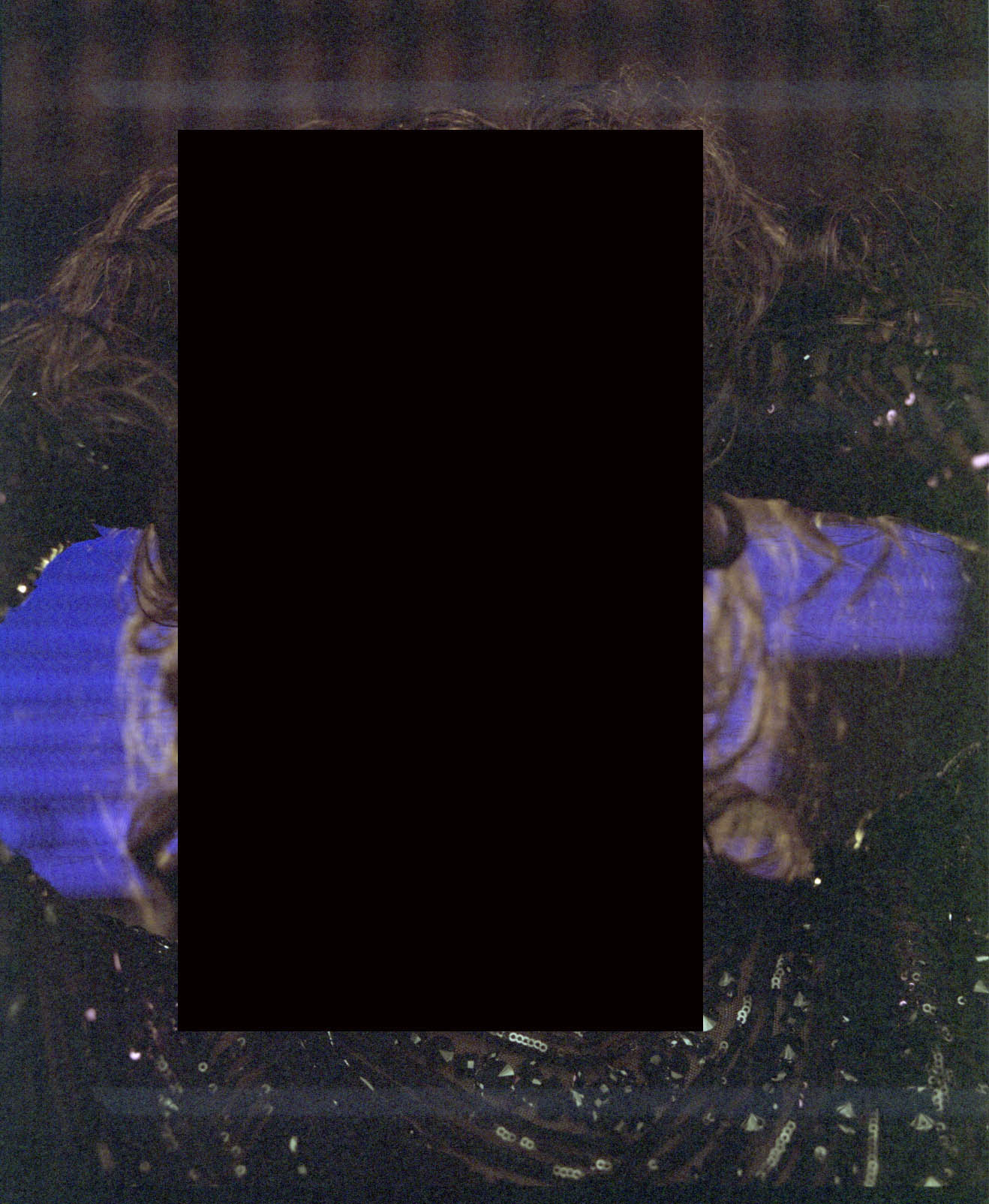

Hello,
I have a similar problem so I thought instead of opening new thread I can ask here.
The issue is grey bars repeating through whole roll of film. It is not cause by scanner as i can see it on the film itself and it show on darkroom prints as well.
Kodak Portra 400 120 pushed 3 stops
developed in Tetenal Colortec C-41 kit, fresh mixed working solutions, development time 4:45 (3:15 is standard plus 30sec. for each stop push), Bleach Fix 4 minutes, Stabiliser 1 minute. No pre rinse
I have recently bought the Job processor hoping that it make the processing more easier and consistent and this is my first film developed. Before I was developing in Paterson tank and agitated with the stick provided. I tried few test rolls after and never experienced the same problem but would like to find out why this happed so I know what to avoid in the future.
I will very appreciate your advices.
This is my first post here, but I already found lot of useful tips here in the past.
Thank you
Ps: pleas excuse the poor scan quality, I tried to emphasize the bars.

Truzi
Mar 18, 2012
2,676
When first posted I was distracted by the background banding. On second-look, I think it is the horizontal bar near the bottom of the picture. If that is is, it might be a bit too well defined and straight to be a chemical artifact.
