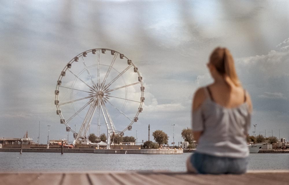

Important facts at a glance:
Film: 35mm Portra 400 shot at 400
Dev: Tetenal Colortech C-41 at 38° (Temperature constant at about 37.9 to 38.2, I measured at the beginning and the end)
Dev Time: 3:15m (1st film in fresh developer)
Agitation: Continuos motorized rotation in vertical position (Maybe too slow) in a Patterson Tank
Does anyone have an idea what could cause these streaks ? I think its bromide drag, but I´m not sure.
Many other images from the same roll of film came out ok.

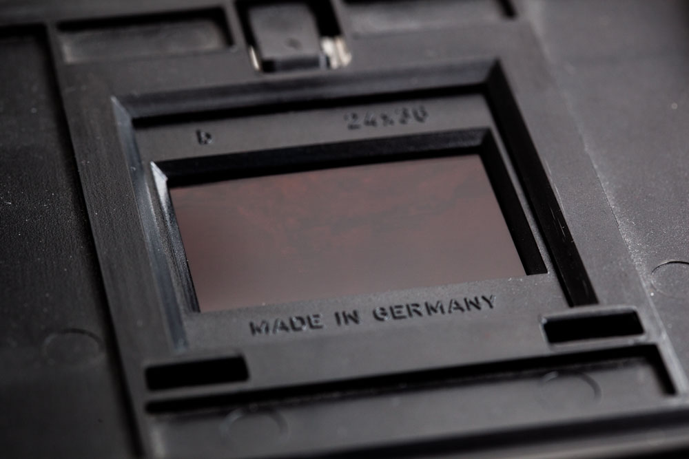

Do you have a photo of the negative, using a phone camera? Can you describe or post a photo of the equipment used for vertical rotation? It does not sound like Jobo, is this correct? What equipment was used for scanning?
It looks to me like either a chemical mark, or the film was not flat during scanning. If it was a chemical mark, it could have been made if the chemical was not poured smoothly enough or quickly enough. If the film is not flat in scanning, lots of defects can happen.

Thanks for the reply. The Film was flat in an enlarger negative carrier (Kaiser System V) and was digitized with a 5D 2 and 100mm 2.8L macro and a repro stand. Lightsource is 5000K calibrated. I'm not new to developing and analogue workflows. Only this phenomenon is new to me, especially it isnt affecting the whole Film. The negative looks OK, No lightleaks whatsoever PP. With a Loupe density variations can be Seen though. Everything apart from the development can ne ruled out.

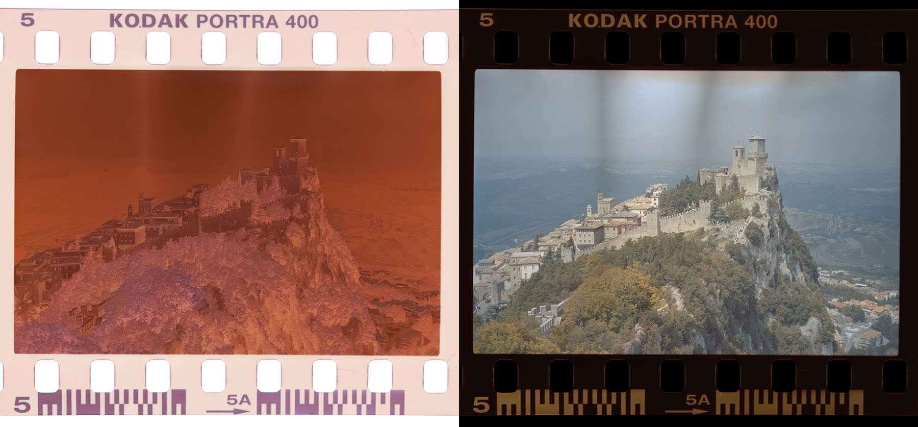

Can you scan the film including the sprocket holes of that frame and the frames on each side? This would help.

Here you go. I hope its sufficient to see what might have happened here. The positive is absolutely not corrected in any way and is a flat inversion of the negative.

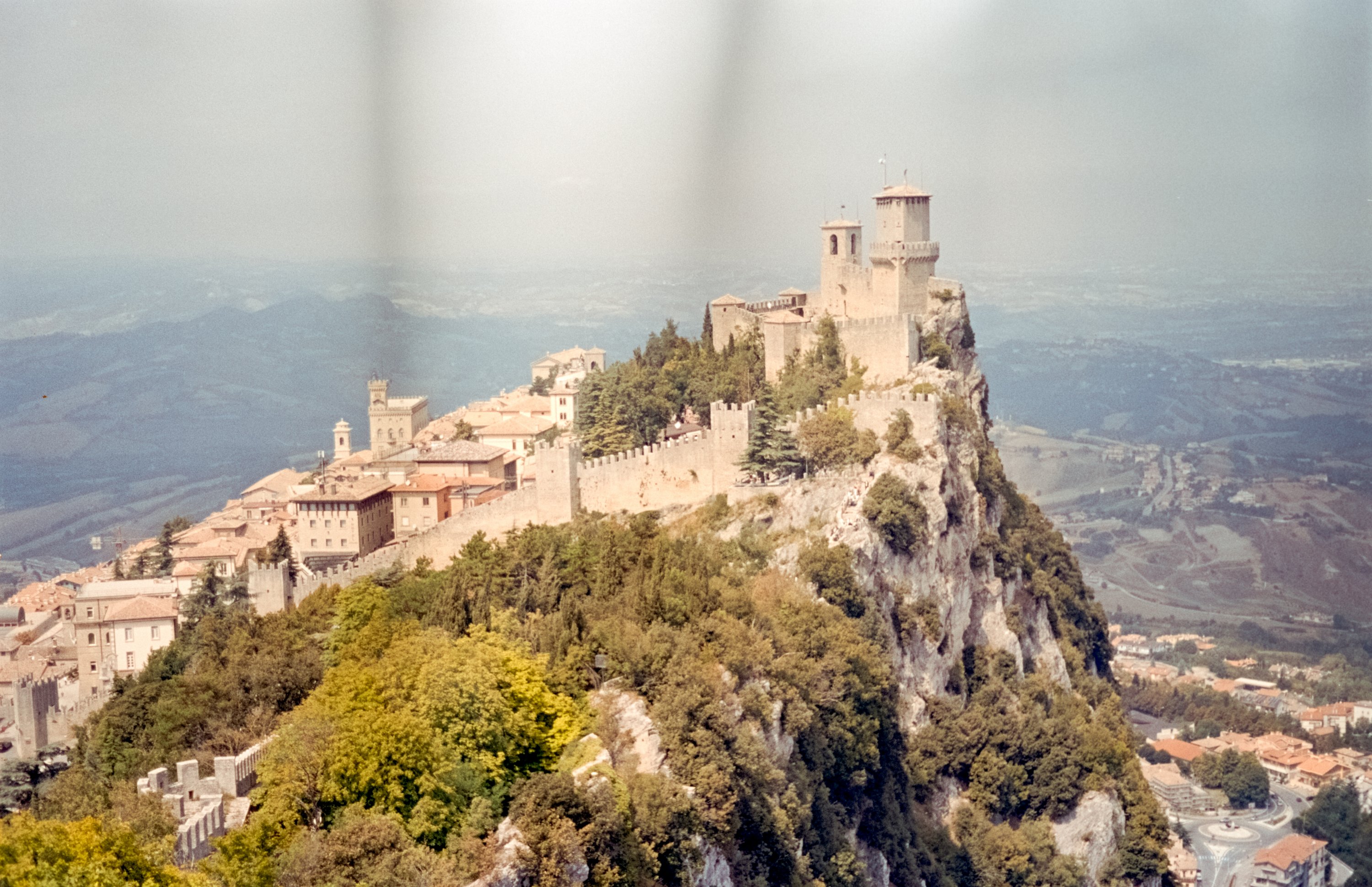

Thanks for the photo. It looks like and unlike bromide drag. Given your method of agitation, the streaks should be at an angle to account for the constant unidirectional agitation. Actually, bromide drag usually is found when there is insufficient agitation but in the rare cases where it is due to too much it appers at a slight angle. Also, it appears more often than just a few places on a negative. It looks more like a process problem involving good stop in the step after development.
However, all of that being said, your agitation method is not recommended.
Sorry I can't make a better call.

would a minute or so bidirectional agitation before the unidirectional agitation for the rest of the development bring any advantage ? This does look more like the "symptomatic" bromide drag you worte of, doesn´t it ?

The second sample does indeed look like bromide drag, but it is still not assured. It can be a stop problem which induces flow related marks or it could be bad bleaching or fixing due to the rotational agitation. Not sure. Generally, you see a mild "halo" around the sprocket holes that accompany the streaks.
