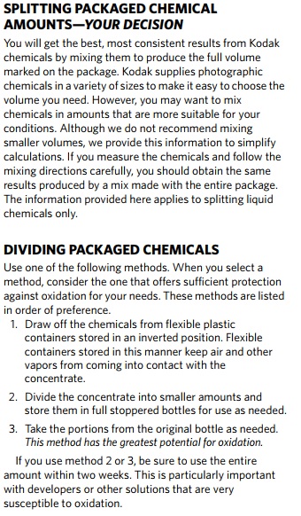

BVY, thanks for the information and list. I see your recommendation for mixing everything follows Kodak's suggestions. What is the longest you have stored the mixed solution in the smaller bottles and still used it to develop film? Do you refrigerate the stored mixed bottles? Have you always done it this way or have you tried any other approaches. I didn't know if there would be any advantage to mixing the developer solution, storing that, then at development time adding the water and starter solution.

If you are interesting in shelf life, concentrates have a much longer stability than working solutions. I have used a Tetenal Colortec kit for over nine months doing partial mixes without major problems. There were some minor color shifts with different working solutions but nothing really important and easily corrected with the digital edition or enlarger.
I've used working solution developer a year after mixing it with no signs of degradation. Others have reported longer. I store it in a cabinet at room temperature in my basement. Refrigeration really isn't necessary. I absolutely would NOT mix it as needed from concentrate. Two reasons: The concentrates don't keep well at all, but the working solution stored in good volume in bottles filled to capacity (glass or thick plastic) are quite stable. Also, you're unlikely to mix with the same accuracy every time. Part C is the critical component and a very small bottle. So if consistency is important, prepare it all at once.
