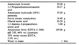

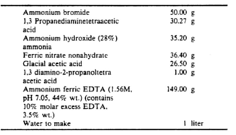

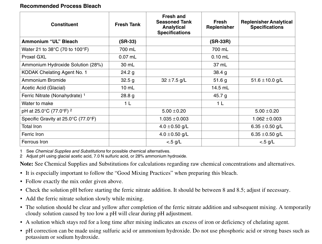

Both the Ammonium Ferric EDTA and Ammonium Ferric PDTA bleach formulas contain quite a bit of Ammonium Bromide.
I checked the availability of this chemical in Poland, and it's not very expensive. Around €17 for 250g of 99% pure Ammonium Bromide.
This could lead to replenishment of the bath to extend its life and increase the number of negatives that the can be bleached without extending the bleaching time too much.
You can find both recipes in the attachment.
The Ammonium Ferric EDTA Bleach recipe was provided by PE in this thread:
I've enlarged the image slightly to make it more readable.
The Ammonium Ferric PDTA Bleach recipe comes from a Kodak document "Processing KODAK Motion Picture Films, Module 7"
