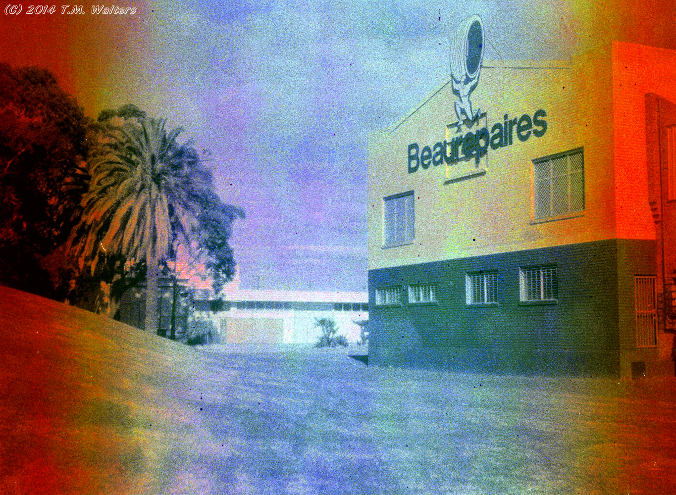

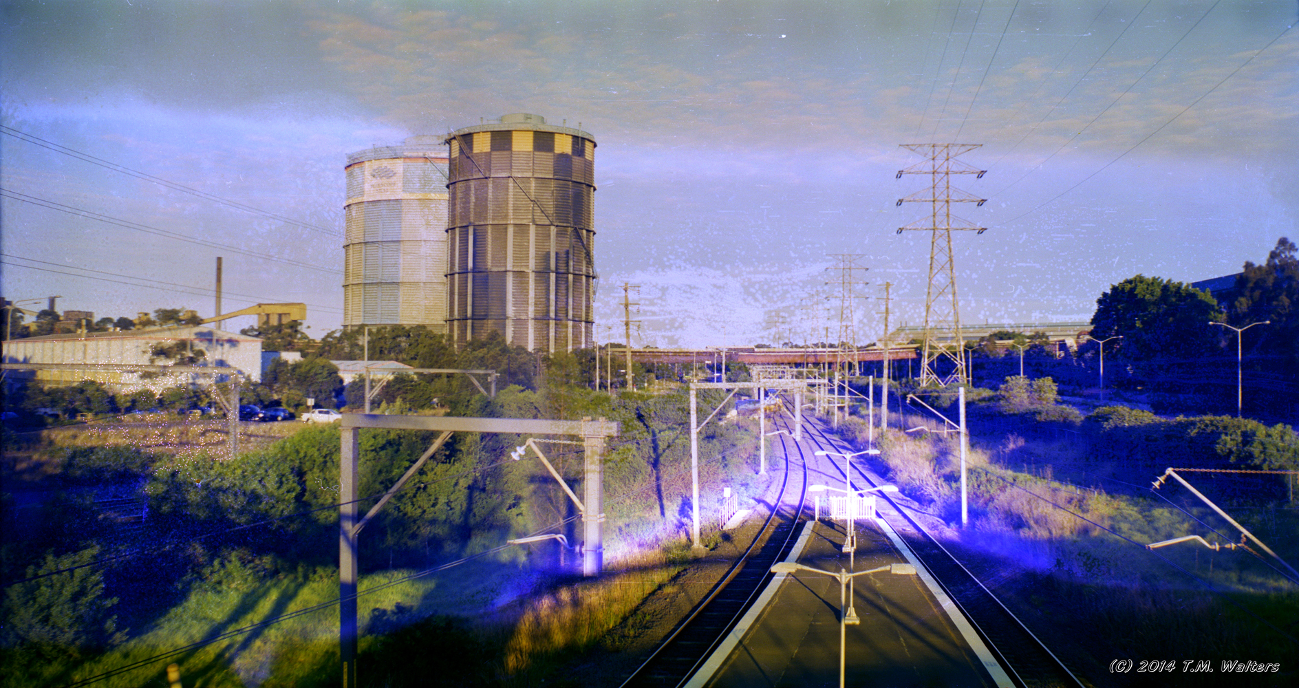

Troy Walters (@typicalaussiebloke) did a lot of experiments with C-22 film development. Here are a few links:
I tried cold C-41 on several rolls of "mystery" film. It worked to a certain extent. I got pictures and I got colours.
