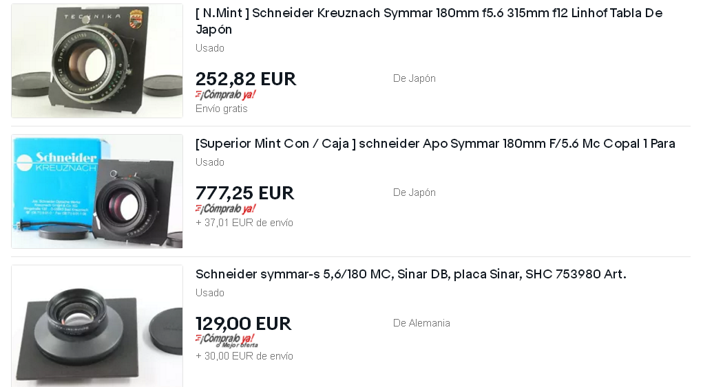

See those offers:
You may get a Convertible lens with shutter and pair of Symmar S cells for the half an APO version may cost.
The APO Symmar version is quite expensive, but I frankly doubt that the APO Symmar version is much optically better than the bare Symmar S version. LF lenses were APO before APO commercial letering was stamped in the lenses, for example the APO Sironar N was mostly the same design than the non APO stamped, with time the "APO" version received some minor incremental refinements that made them slightly better in average, but sure many Non APO stamped Sironar N lenses are better than many APO stamped, as in production some variability happens in the peak performance, anyway this is very, very dificult to be noticed in practice.
Sironars and others may have a shim to adjust the inter-cell optimal distance for each particular lens. With used lenses it may happen that those shims are lost or wrong ones are in place, some sellers around may assembele a lens from to broken lenses, not the general case but it may happen.
An important factor is shutter, take one that it is in shape, and ideally get a (cheap) shutter tester to check speeds, in special if you are to shot slides.
