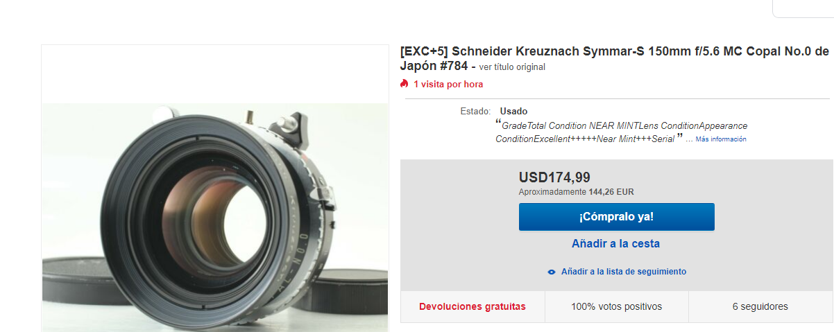

I bought just the Schneider 150mm APO Symmar. It was rich enough for my blood at around $500 from Japan, They wanted around $1400 for a Symmar S. Once thing be careful about is Schneideritis, which seem to have white spots inside Schneider lenses along the barrels. Some people claim it doesn't matter. But I'm not too sure. MIne doesn't haven't them.
Schneideritis has no impact in the image, it's a purely cosmetic issue. It may look problem is in the barrel inside, but if it was that it could be painted again... so it's not that easy to solve ! Problem is in the contact between the glass and the barrel, then the glass has to be extracted from the barrel to paint that contact area, so IMO better not trying to fix it.
Usually APO versions are more expensive, see this S one, at $175 looks a steal...

Bob, thanks for your explanation. The single Technika stamped lens I have is a convertible Symmar 360, it is crazy sharp, I was suspecting yet that a Technika stamp was not merely decorative.
The ad came up in Spanish. You have to be Spanish to use it. :smile:
