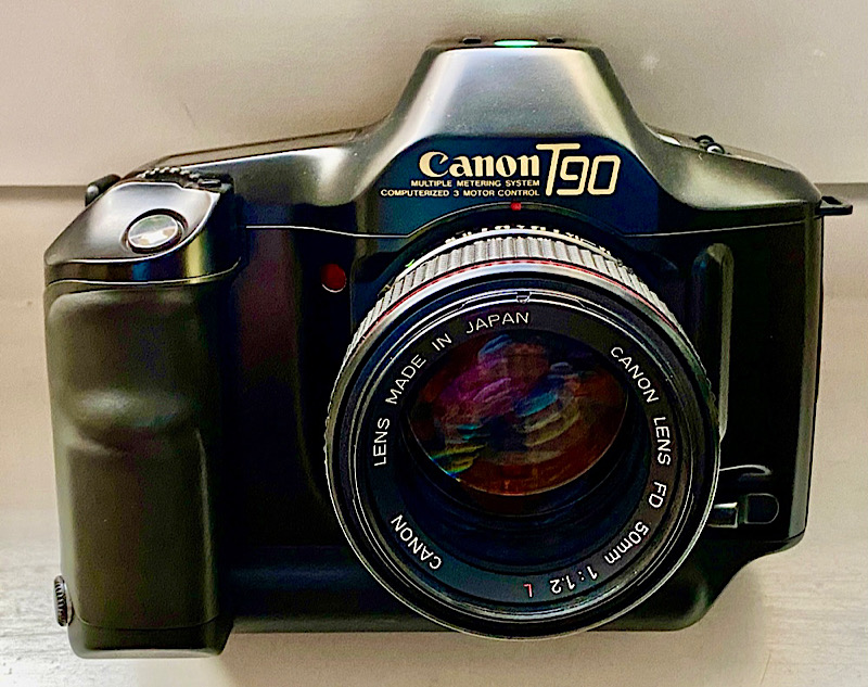

Herald of the EOS generation: the mighty Canon T90.
The Canon T90 from 1986 is described as the most advanced SLR that is focused purely manually.
It is largely fully equipped and part of the Canon FD system with a large number of excellent lenses.
Due to the many functions - including a sophisticated spot metering, several exposure modes and advanced flash exposure - it still takes some time today to get to know all the possibilities.
If you want to, because with the T90 you can also take photos almost fully automatically.
„The tank“: Solid construction on a die-cast housing, built for serious work.
The plastic housing should not disguise the fact that the T90 is based on a metal chassis and was designed to withstand use and load. Its nickname „the tank“ is not undeserved.
