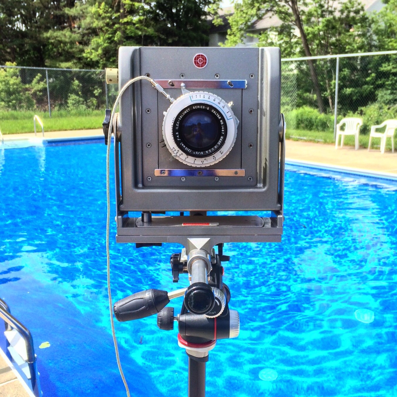

Check immediately that the bellows is light tight. This is a deal breaker.
Okay, basic test:
bellows fully extended, dark room, led flash light through the back with the shutter closed, not light leaks. When I open the shutter a beam of light comes out and it appears to escape nowhere else. The inside of the glass looks like this...

Return it or ship it to a professional for a full rebuild/check through. Sheet film gets expensive fast, especially when your equipment is ruining sheets as fast as you are while climbing the learning curve.
No offense intended here but you don't seem like the type to accept anything less than excellence in appearance- and well maintained-gear so why give yourself the heartache?
Buy local so you can see/touch it, spend a little more so you aren't scraping the bottom of the barrel and get yourself a nice kit. "Do it once, do it right" comes to mind.

You need to put the torch inside the camera and shine it outwards (as if trying to shine through the bellows' fabric). This is critical in the folded corners. You are looking for any light shining through pinholes in the fabric. These are usually in these folded corners.

To add to LJH's suggestion, stretch the bellows all the way out and in a darkened room check for pinholes with a flashlight (torch in Australia).
If the bellows is light tight and the camera works properly then you did get a fair deal. You might explain to the Seller about the shutter needing a CLA and not as advertised. He may give you a partial refund. Don't worry about the film holders because you can buy nice used ones for dirt cheap.
That Caltar lens is in an older shutter but it has nice glass.

1. That camera in pristine condition with that shutter freshly CLAed would go for $350 on ebay easily + shipping and $450-$500 in a local store.
2. I charge $85 for a shutter CLA.
3. Mount the camera on a tripod, remove the focus panel and lens board, extend the standards as far as the bellows will allow. Spray the exterior of the bellows with Windex. Using a soft cotton towel or paper towels wipe the exterior clean/dry while supporting the area being wiped with your other hand from the inside. Once the entire bellows are clean spray them down with Pledge furniture polish, the yellow can Pledge only, let sit for 15 to 30 minutes then rub the Pledge in while wiping off the excess supporting the bellows as when cleaning.
4. Place the camera in a dark room and shine a bright light inside the bellows while looking at the exterior of the bellows. That bright light can be your LED flashlight, a cfl in a small table lamp or open socket trouble lamp or similar. Be careful not to touch the inside of the bellows with a hot light source as you most likely will burn a hole in them.
5. Any pin holes can be repaired by painting the inside of the bellows with Golden Heavy Body Artist Paint #1040 Carbon Black or Tulip washable fabric paint, black or ebony. Both are available at craft stores and can be diluted with water up to 50%. Apply in two or three thin coats with an economy artist paint brush. Tears in pleat seams can be repaired by gluing tight weave black cotton or nylon cloth to the inside of the bellows then painting as needed over the tear repair if it is not light tight.
6. Most returns on ebay require you to pay the return shipping. All cleaning and patch supplies can be purchased for the cost of the return shipping.
7. Post a picture of the tripod socket. It may be a pressed in insert in a metal housing or a striped wood block of which either can be repaired without great expense.
8. Remove the darkslides from one film holder at a time. Blow out the darkslide slots with caned air. Clean the film plate and darkslides with Windex and clean paper towels. Blow out any lint with the caned air then replace the darkslides. The edges of the darkslides can be rubbed with household wax if needed to get them slide easily after cleaning.
Send me a pm if you want me to do the CLA.

I have to say, shutterfinger is right. I will reach out to him about the CLA after I check with my local guy to see if he can do it for less than 100. I will contact eBay for a partial refund because this is not as advertised but still usable for sure.
UPDATE:
i spent all morning with the camera. I constructed a makeshift dark space in my closet and loaded two sheets of ilford 100 into the cleanest and most acceptable holder. I went outside into my neighbor and carefully made two exposures of not that interesting stuff. It caught the attention of three of my neighbors, I was approached twice and one of these neighbors introduced himself as a fellow film shooter, kinda funny. I cannot explain how much I enjoyed the long drawn out process of calculating these exposures. It is like I imagined, an even more complex version of shooting with my Mamiya RZ67, and a new learning curve, I love the process and challenge.
I Will stick with this low cost calumet, service the lens, get new holders. Depending on how these two shots come out, I have more decisions to make but I can't wait. I think I might need a better tripod, this one does wobble a bit but everything is tight. The kit Came with a nice case so I am totally in business. I have a lot of work to do but it's worth it, this is great. Ill be sure to share those shots no matter how bad they are. Here is a cell phone shot of the kit in daylight. By the way, both exposures were shot at f22-1/100th.

this is an interesting point though I hate to be categorized as an inexperienced photographer. Ten years with film and I'm just now trying large format, maybe I could have learned more before asking around here but photography is not a new concept to me by any means, large format however, different story.
i am hopeful that the 1/100 was close to accurate, though it does seem a bit slow. Shutterfinger sent me the details on his CLA service and I should be taking that offer unless local proves to make more sense. We will see how it fares after that.
