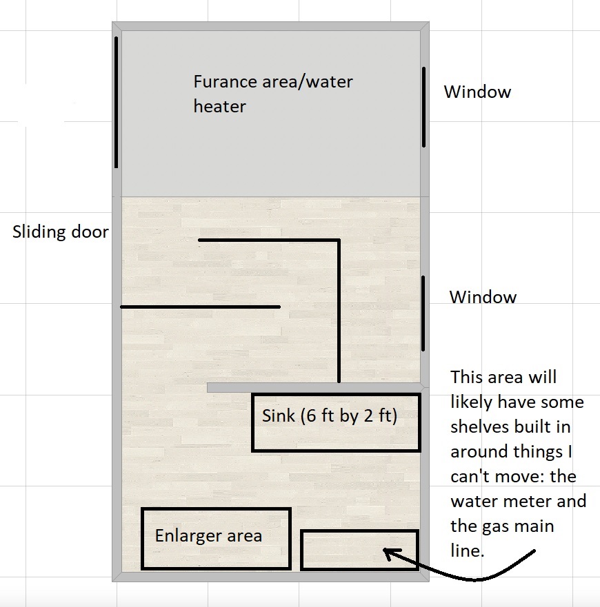

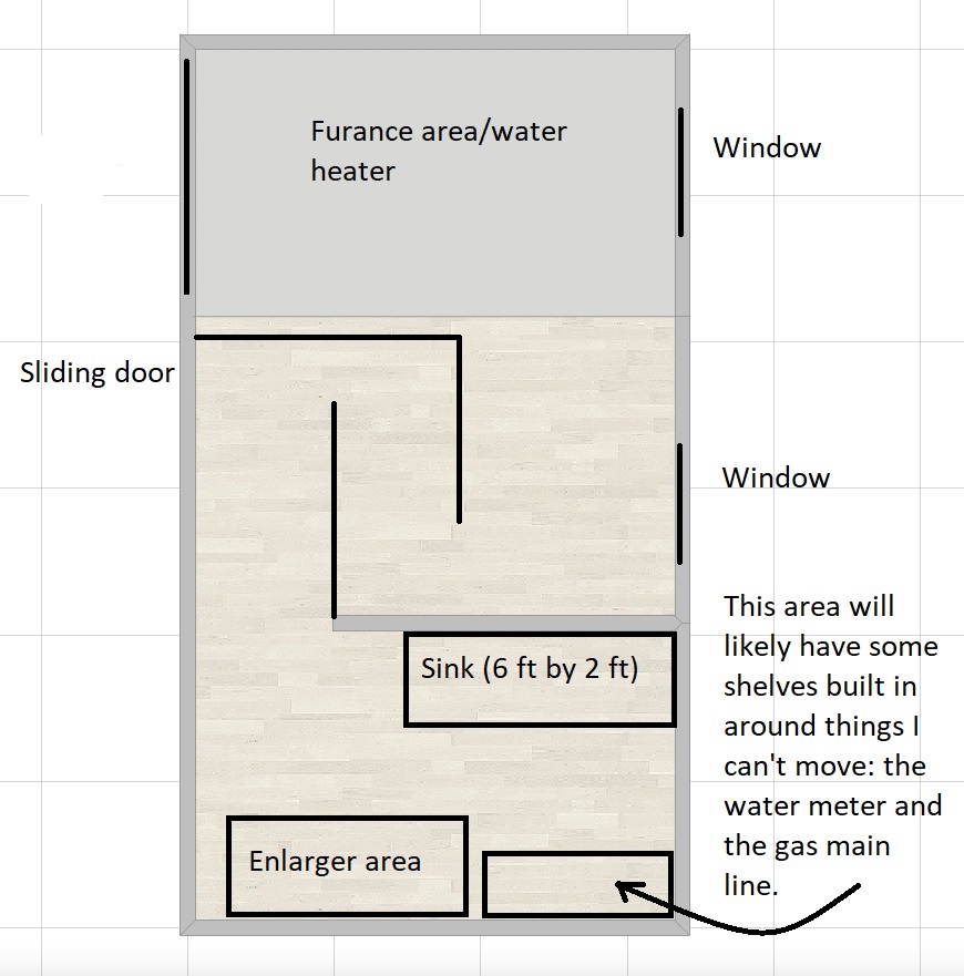

Hello,
I've been reading threads in this forum for months and have finally registered because I feel dumb and need some help. My Google skills are not helping me, and neither is The New Darkroom Handbook or the Kodak publication.
After wanting my own darkroom for 20+ years, I'm finally getting one in my basement. My brother is doing the work for me, and I can basically do whatever I want within reason. I would like a light maze entrance for ease of moving in and out, and because knowing my family, being able to move freely would be awesome for us.
My question: I can not figure out how many turns a light maze entrance needs to work. I see S-shapes and U-shapes. Is there a reason to choose an S over a U if a U works? I have room for an S but it would make the rest of the space pretty unusable, so I'd like a U if possible.
These are mostly to scale proposals. There's a room off of the furnace room that is 11' by 6'10". I have about that amount of space on the other side before running too closely to the water heater and furnace. There is a sliding door entrance to the furnace room (the vertical black line on the left; my label shifted down), and two small basement windows that I would like to leave uncovered if possible. I can use the space outside of the dark side for additional storage, etc.
Do either of these ideas work? Would one be better than the other? (Like the one where the entrance doesn't directly face the window?) Is there a length the U should be? I'm usually so good with spatial reasoning, but this is really throwing me off for some reason.
Thanks for your help.

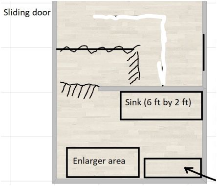

I use curtains that I can pull back around my entire darkroom, exposing the entire area to fresh air and light when not being used for dark purposes.
So I think a maze is a waste of space. I would instead recommend darkroom3.jpg with the straight part being a curtain. You can have flap curtains over the imaginary door and at the end of the straight curtain.
By making the three pieces curtains instead of walls, you can turn the outside area into a proper studio, just by pulling back the drapes.

Nice idea, Bill -- I would put a worktable (and storage) under the window for activities not needing safelight conditions -- frees up clutter in the actual darkroom.
One could also stick pipes through the wall behind the sink and put a second, smaller sink in for print washing, etc to free up the darkroom sink.
I agree and also, the u-shape will work just fine.If the walls are painted in a flat blacken light is getting through; as Bill said, if there still is a problem ,you can add curtains but, that somewhat defeats the purpose of having free entrance; getting the curtain out of the way while having something in your hands is a hassle.
Exactly what I was thinking, a finishing desk outside the darkroom.
I just spent about an hour reconfiguring my darkroom to setup the “studio” which has to be in the same place because I don’t have room like that. So I hope you can use the outside space.
Keep in mind though - people will put stuff there. You have to let it go and just clean it up when you want to use it. (Note to self, stop complaining when people put stuff in the sink).

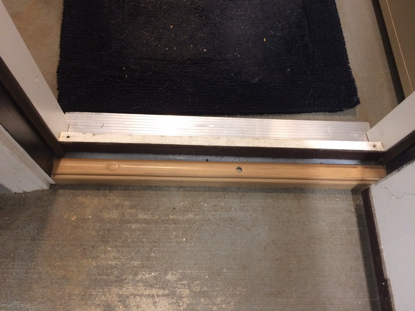

I've built three darkrooms and have never had a room for a light maze. Since I'm the only one ever in the darkroom I use an exterior door with a sill and just weatherstrip around it and put a piece of wood across the bottom to act as a light trap and paint the seating surfaces black. A community darkroom is one thing, but for a private darkroom I've never found it necessary.
This simple solution is the best. If you are the only darkroom user this works fine. After about 10 minutes in the dark your eyes will pick out tiny light leaks. I've never had a problem .

When building my darkroom, I decided a revolving door I had for my entrance would take up too much real estate, so I opted for good weather stripping on the sides and top and a Zero International door seal on the bottom. zerointernational.com. Might be a potential solution for you. Bill "In the Dark" Barber
