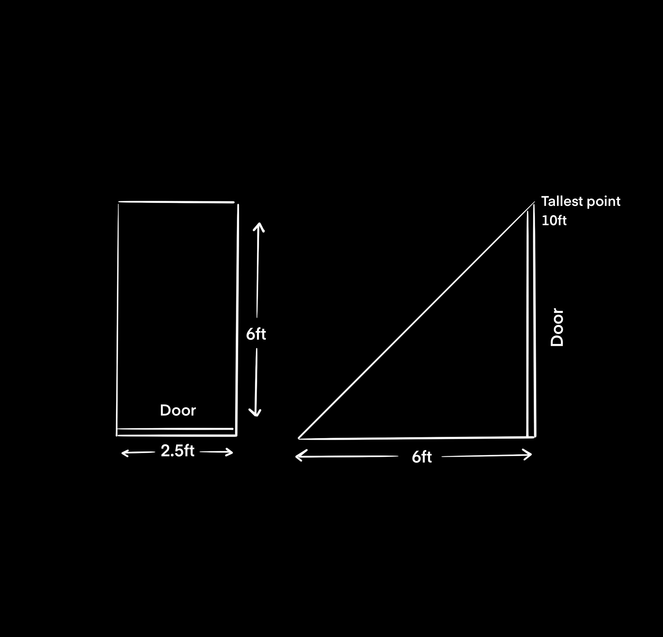

I am going to be moving into a new house this week and there is a small closet under some stairs in the garage that I'm hoping could work as a darkroom for printing but wanted to get some opinions on this.
I've attached an image (not to scale) that shows the basic layout of the closet. It's 2.5ft wide and 6ft deep. Since the closet is under a set of stairs, the ceiling is at an incline. Going from the floor area to it's highest point at about 10ft.
I have a Beseler 23C II XL Thats about 3.8ft tall. The base is about 2ft deep x 1ft wide.
I will be printing 8x10 but would like to have the option to go up to 11x14 too.
Just curious, based on anyone's experience, do you think this is even doable? It seems like the width of the room would be super tight. Thoughts or tips on making this work?

Sine the door is on the narrow end, your limitation is how far in you can place the enlarger. You are going to need at least 2.5 feet between the door and the enlarger to stand, ideally a bit more. I think, given the baseboard depth of the enlarger and the space for you, the enlarger is going to be low. I was thinking of placing the trays on shelves below the enlarger, but I don't think you have the height.

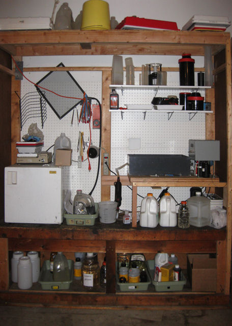

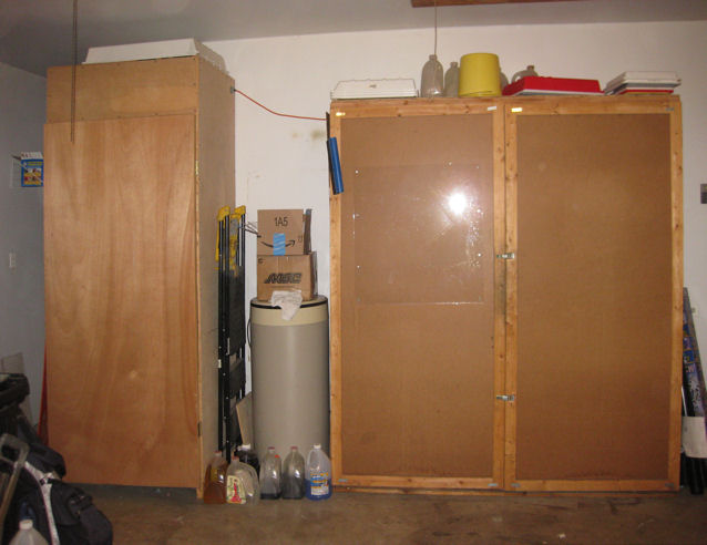

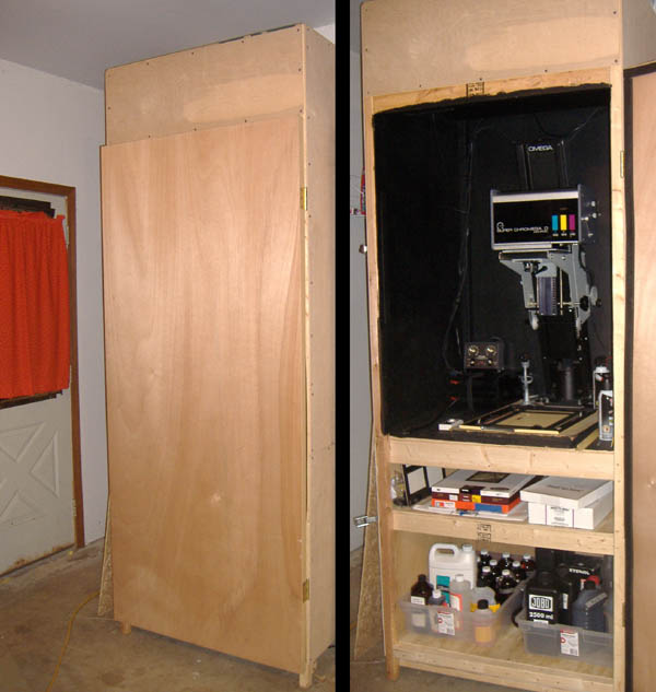

Black out the garage and just store stuff in the closet. My solution has been to build a cabinet for the enlarger and another for developing film. (The cabinets keep the dust off things.) When I print, I pull out a large folding table and the print washer lives in the attached laundry room.

Seems like the height is the biggest problem here. How far into the room do you maintain a six foot minimum height? I think you'd want to put your enlarger on the "back" wall (perhaps on a lower than usual table) and still have room for a shelf on which to place your trays. That's going to be a tight squeeze and make for an uncomfortable work area. But it theoretically ought to fit if the ceiling height is really ten feet at the entrance and the stairs slope at a 45 degree angle or less.

On paper it looks possible, but uncomfortable. The enlarger could sit sideways on a shelf about 16 inch wide 2 or 3 feet above the floor and running from the door to the sloping back wall. The enlarger would sit sidewise on the shelf nearest the door. Four trays can be stacked vertically next to it. You could sit to operate the enlarger and stand to process the prints. I did this for many years. The bottom tray can be a deep tray from a department store or home and garden store. It can hold many fixed prints to be completely washed in the laundry room sink. Many years ago Richard Mfg. Company of Fernandina Beach, FL, made a Tray-Rak that stacked three trays vertically, but it might not fit in such a small darkroom. My 16x12 version certainly won't. The trays were supported by the edges being turned down towards the outside. Many trays wouldn't work. I have heard that Calumet made what is called a try ladder which might be similar.
That looks like an ideal space! The garage is pretty big and there are multiple windows throughout so I'm not sure if trying to black out the garage is going to be a good idea as I have a feeling thats going to be a bit harder and I'd rather not create anything super permanent, but good idea.

That's a great question, I would say 75% of the room would allow me to stand up (im 6ft tall). Yeah, I was thinking the same thing having my enlarger on the back wall (if it fits and is comfortable) and then having a shelf somewhere for the trays.

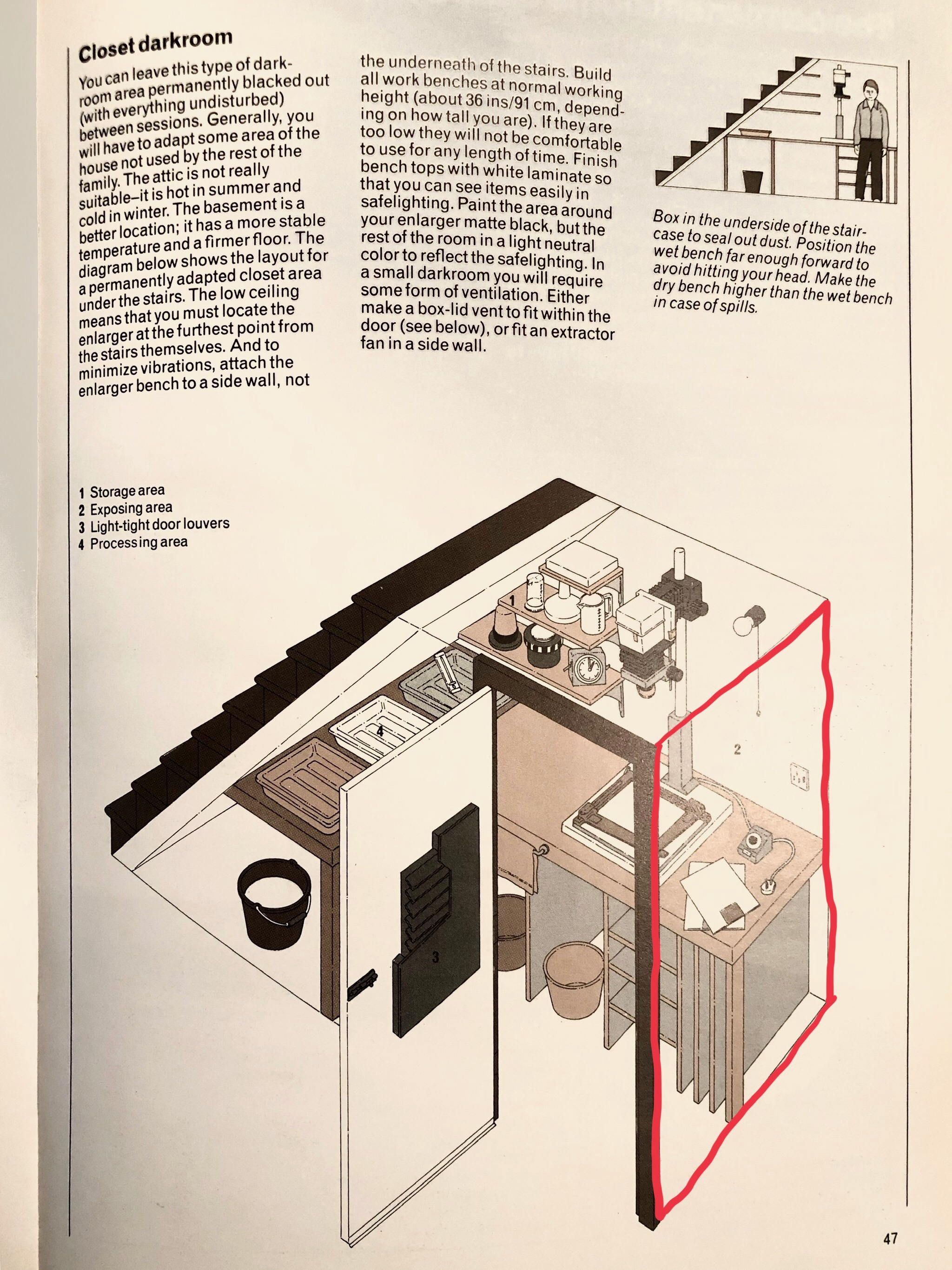

Thanks a lot for all the tips everyone, never ceases to amaze me how willing this community is to help a stranger think through something like this. In one of my darkroom books, I found this image that's pretty close to the layout of my closet. You'll see that I've highlighted in red where the door actually is at our house, so it's slightly different. I like the idea of putting shelves next to the angled wall under the stairs.
That's a great idea! I like the idea of having the enlarger siting sideways as I think that makes the most sense given the space.Thanks for the tips on the trays, very helpful!
