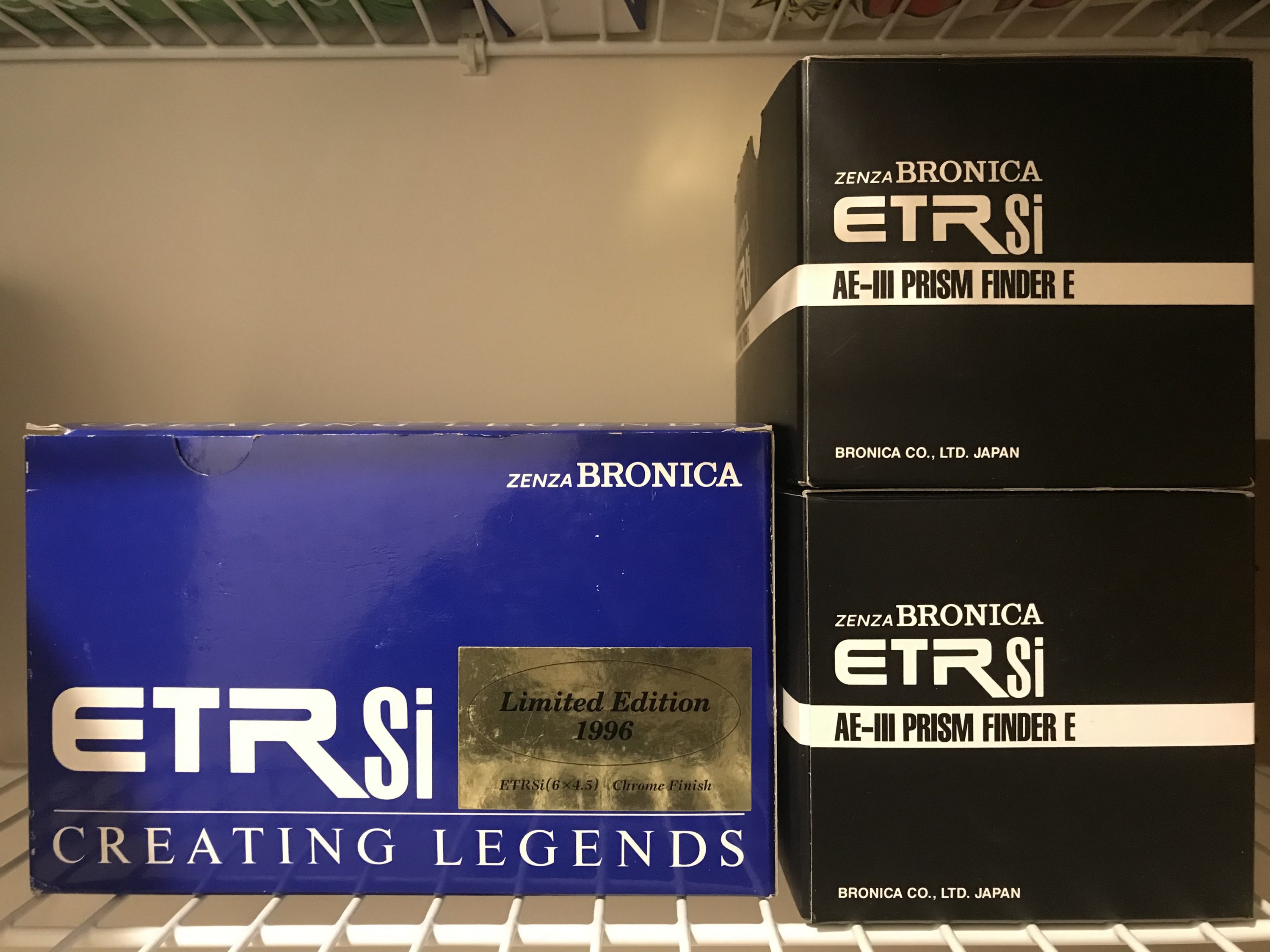

A year ago I was lusting for a 1996 chrome Special Edition Bronica ETRSi on ebay but in the end it was about 1000,-
I have this one in box. Still brand new. I also have the special edition in brown leather. I've sold several special edition camera kits. Have owned and seen pretty much all of them.
This is the reason I do not like to argue with some people who have never seen them in person.... They do not even know the differences of all the bodies and film backs. When we tell them, they do not listen.

A nice collection you've got !
I'm was very happy when this ETRS(i) thread came up, because I really like the Bronica camera systems. But I'm a little bit dissapointed about what we have now ... There's no need to argue. Enjoy !
The good items do not go down in value and prices.
