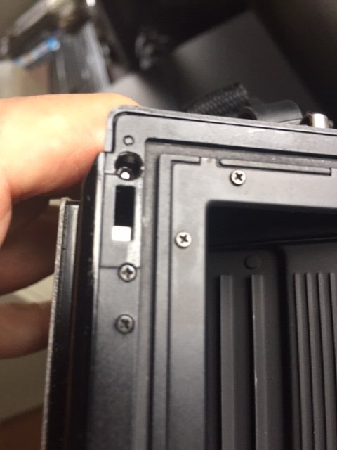

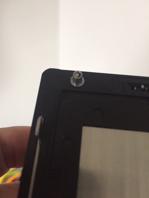

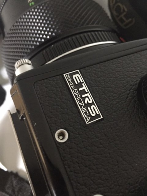

Two questions from my other observations though please. Both the pin showing in the cable release socket pic A plus the pin to the lower back of the body pic B when the film back is removed are both solid. Should I be able to use say an old paper clip to push either or both of those pins in at all or should they be solid?
Any other suggestions would be welcome and if it gets down to being unusable, is there at least a way of releasing the lens as a friend would be able to make sue of it.

In reference to your earlier picture of the back of the body with the pin deep in the hole.
With either my Etrs or Etrsi when the back is removed that pin should be up out almost
flush to the body . However , even with this pin pushed in I was able to remove the lens .
Peter

On my Etrs body , the cable release pin is 9/64"or 3.5mm down from the edge of the body.
the end of the lens release knurled button is 7/32" or 5.5mm from the outward edge of the cylinder it moves in .
Hope this explanation is clear enough or I'll see if I can take some pics later if need be . Peter
These measurements are with the back removed .
Hello Peter, did you manage to take any pictures of the cable release pin in its hole and if possible, the position of the pin in the hole at the lower left hand side of the camera body once the film back is removed.
I was hoping that the lockdown here in the UK would be lifted soon and I could get the camera looked at but we have at least another three weeks of it athe moment and probably longer.
thanks
Paul
If not clear enough I'll try again , but I think they should give you an idea of where the pins are with the back removed . Peter
Thanks for that Peter and perfectly clear.
As you can see from my equivalent pictures of my ETRS, he pin to the cable release is similar to that on your's, however the one to the lower back of the camera (with the back off) shows the pin much further down. Unsure what this may indicate at the moment but it gives me a further route to follow.
