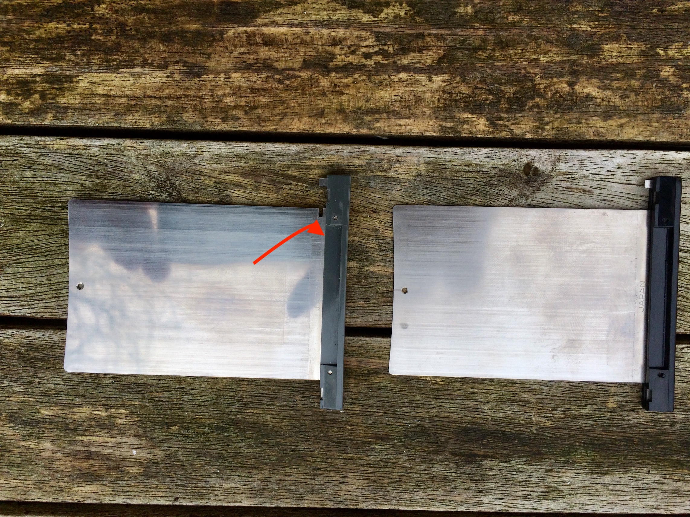

Have you compared black vs grey handle dark slides side by side? If what you experienced is intended by design, there must be an obvious difference. I assume that same back with grey slide does lock shutter and the black slide with thumb wheel back also does?
The black handle darkslide only works with the older back; the grey handle one works with both backs.
Grey vs black handle darkslide to see the difference:

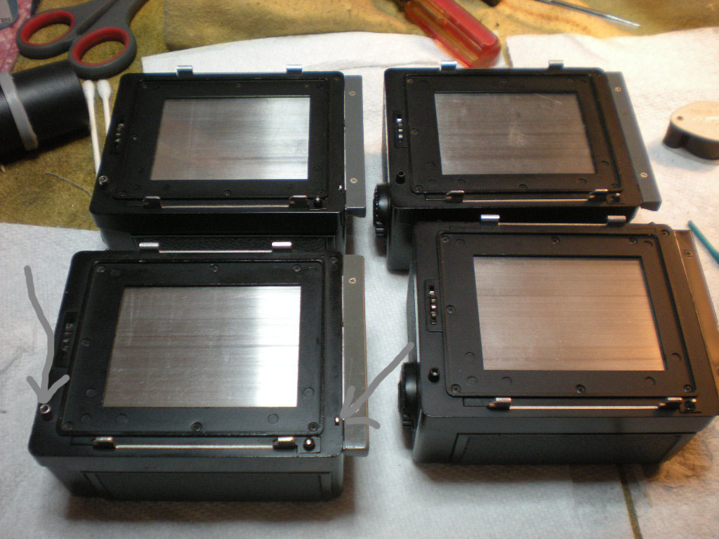

So as a follow up , the two backs on the left have a serial # starting with 83 . The right arrow indicates the tab that locks the dark slides that have a small notch . The tab on the
left hand side is also metal instead of plastic , as on the right hand back with serial # starting with 81 . The dark slides without the notch fit well in both backs , but don't lock with
the backs off , so be careful.
