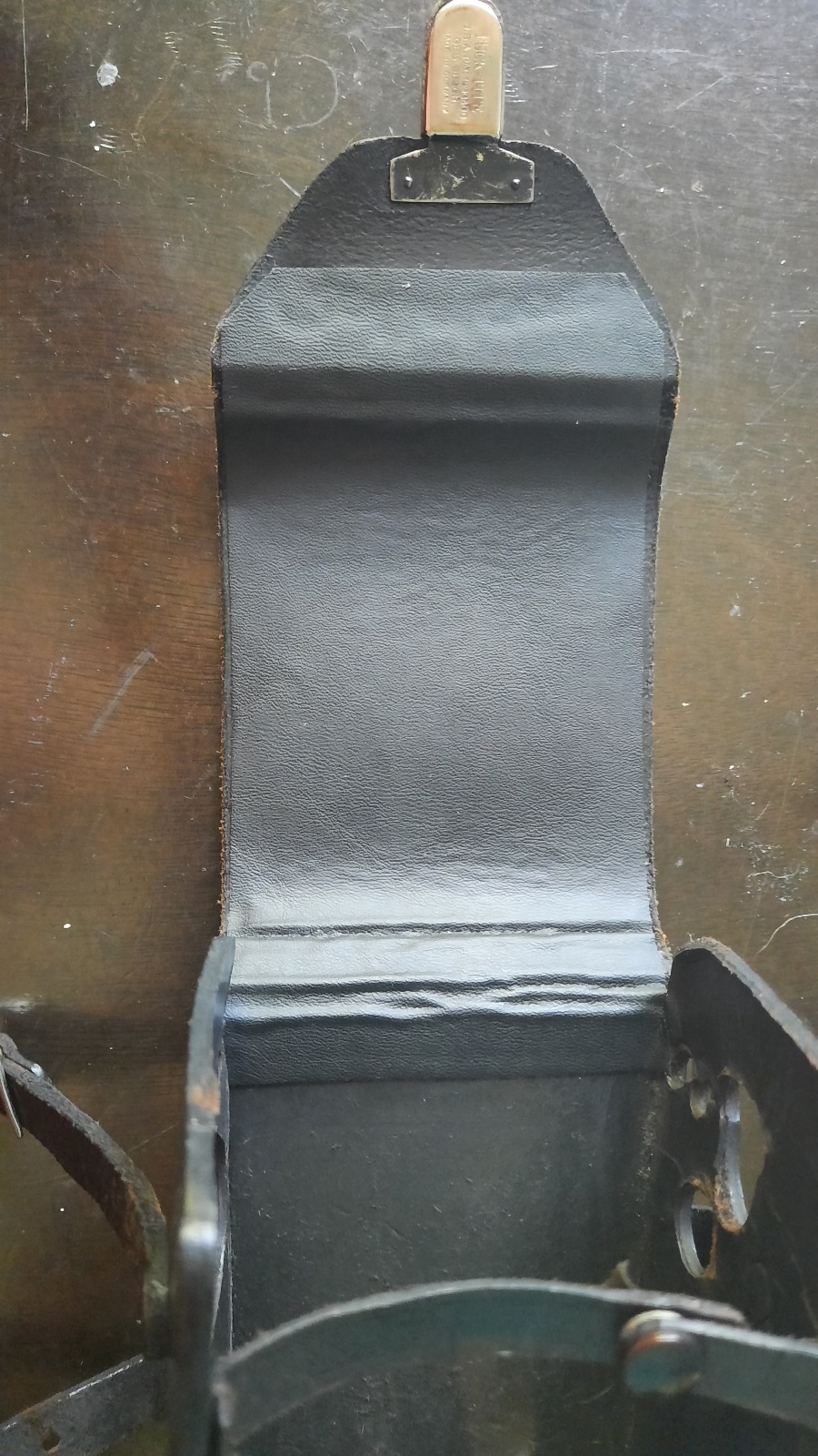

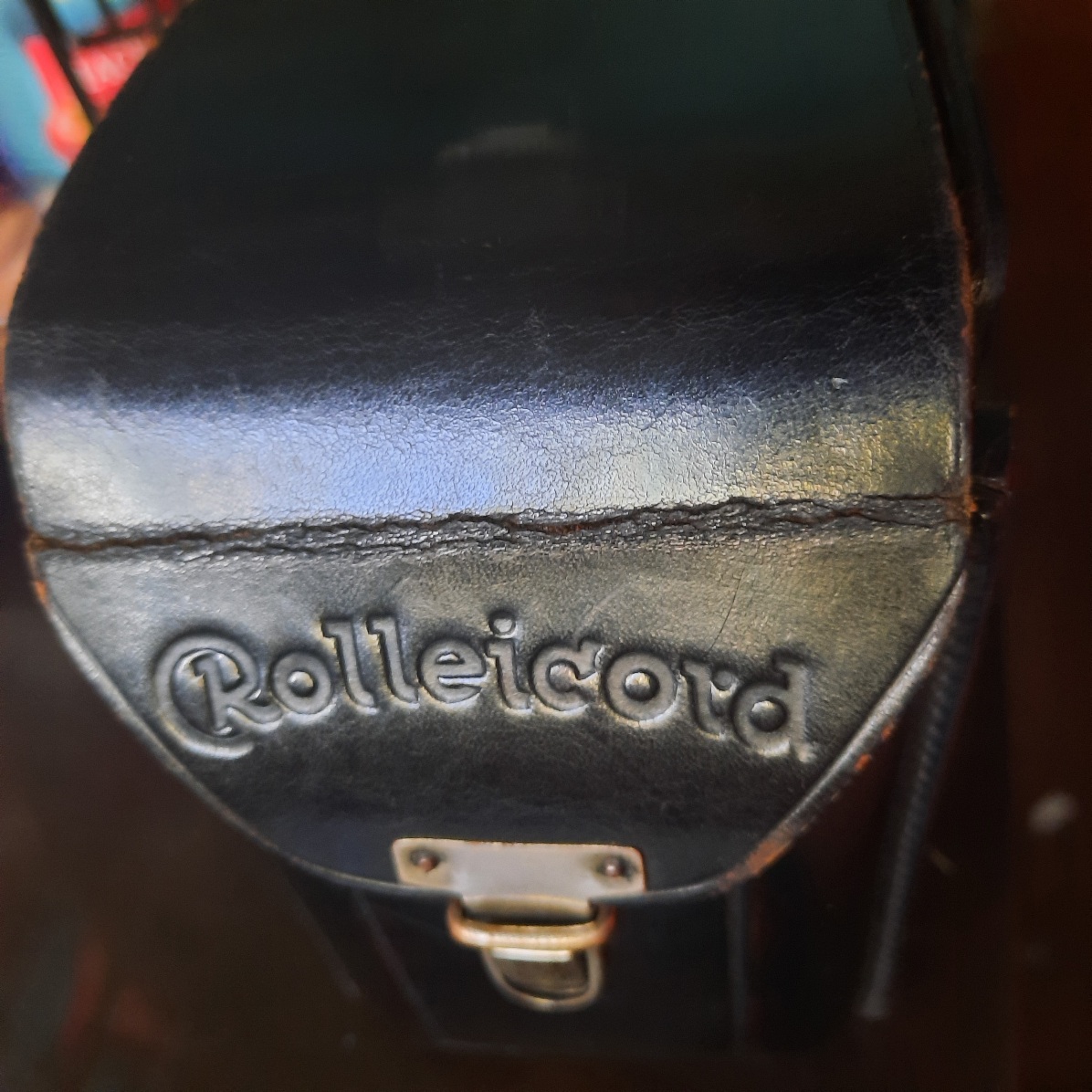

Used some self adhesive vinyl over the nearly torn flexable edges. Seem to of worked well.
