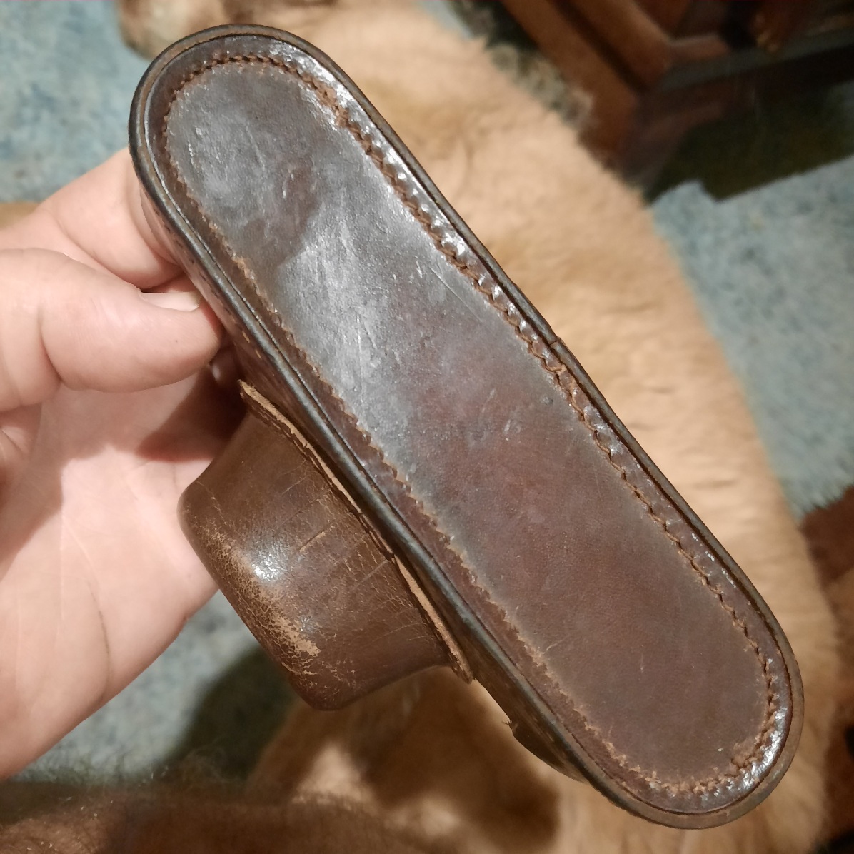

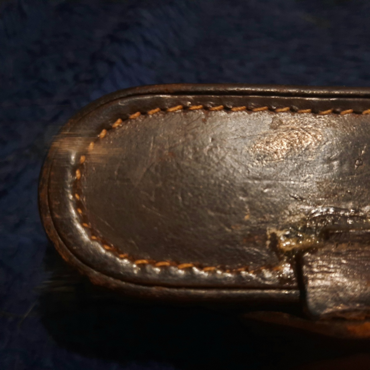

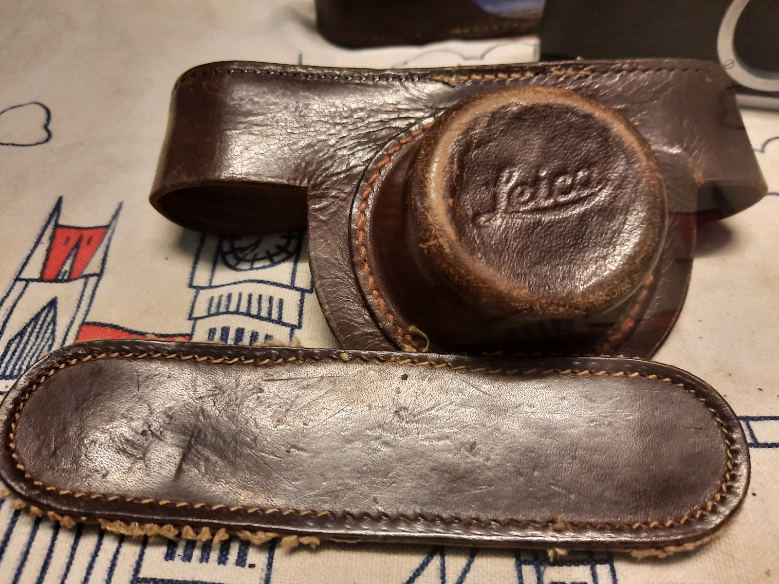

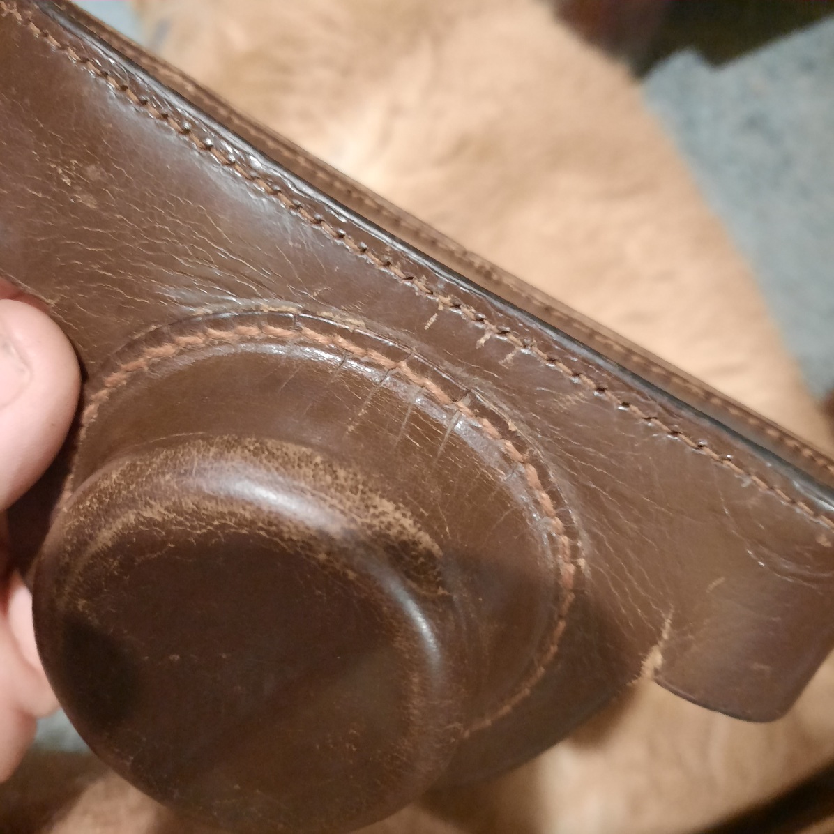

Sad old Leica arrived today.
Threads come out much easier than the Rollei, just need a bit of a tug. Need to reattach the front part as well as replace the side lugs.
There is really almost nothing to learn. Clean out the old thread. Line up the pieces. Then pull new thread through the old holes. It is bordering on trivial.
Yep that sound about right. Im just repairing, not restoring.
I have to replace the shutter curtains as well on the old leica, probably have to put a warning so not create too much more anxiety.

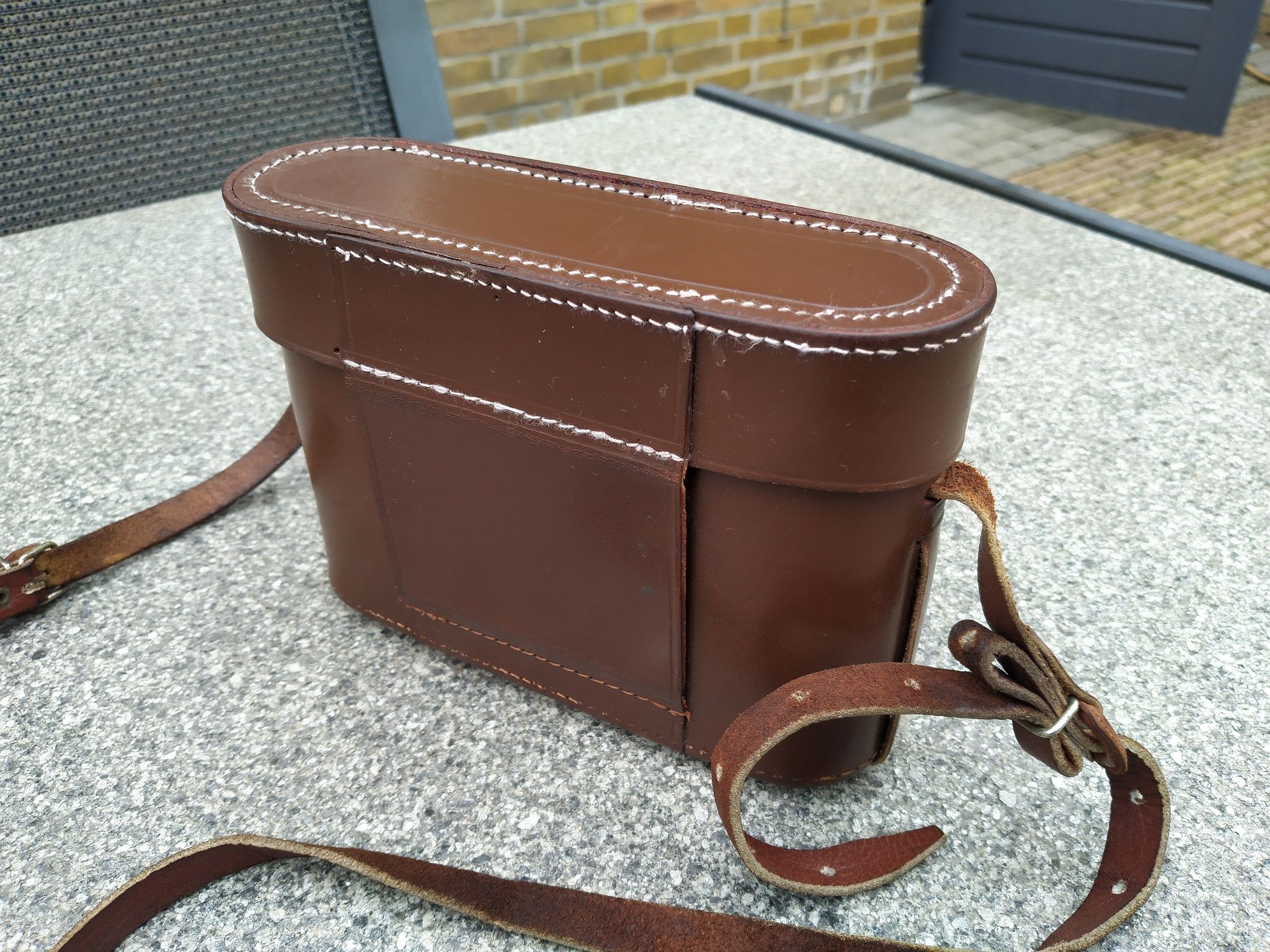

A Zeiss Super Ikonta case I recently stitched up using regular needles and threads in a double sine wave (as shown on the previous page)
No points for neatness, but it'll do the job.
Removing the old thread was a bit of a pain.

Well done.
Got too types of waxed book binding, one was a little too thick, the other was a little thin, but was ok for the job. The two needles I ordered were too big, but I managed to pinch a couple of needles from the resident seamstress.
Once I worked out the process and got a rhythm happening was pretty easy. Apart from constantly having to rethread the needles and pricking myself.
Try the Rolleicord next.
Looks good!
Concerning the thread thickness, a thicker thread would have filled the holes better, but also would stand out higher on the leather surface and thus gets more easily rubbed through.
Looks like nice work! I need to get to this on my Daiichi Zenobia case.
A bit of matching color shoe polish on those white threads will make it look a lot less of a patch job. Ive done similar repair work with a stitching awl using a locking chain stitch recommended in instructional videos. The awl handle makes the needle a lot easier to push through a tight hole.
do a search for "Speedy Stitcher" - inexpensive, you can do all kinds of stitches with multiple different threads material.
Not sure you can match the box stitch and the needle looks too big. Certainly too big for the Rolleicord.
Isnt hard at all to do box stitching once you get a rhythm going
