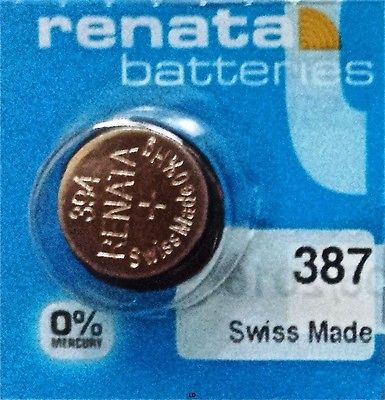

Also, once you get it going, don't trust the needle in the center to mean OK exposure... sometimes it means the "power" is off. At least that's how mine works. I have to make sure the needle is going up and down with changes in f/stop and shutter speed before I will trust it.
Bill just by the way (because I gave the SP500 of a friend last week back to him)
What kind of cell does this model fit?
I tryed a portfolio of 30 usable cells but no one was correct.
He wanted to ask at Riccoh but I doubt on it. His best friend is at Riccoh image. But he has to do with coppy machines or something else (Not photo service) Pentax service was suprime from my point with many old parts they offered.
But now they are closed.
with regards
E. von Hoegh
Sep 14, 2011
6,197
Adirondacks
with regards
An MN400, which is obsolete mercury chemistry. Try a 387 silver oxide cell.
