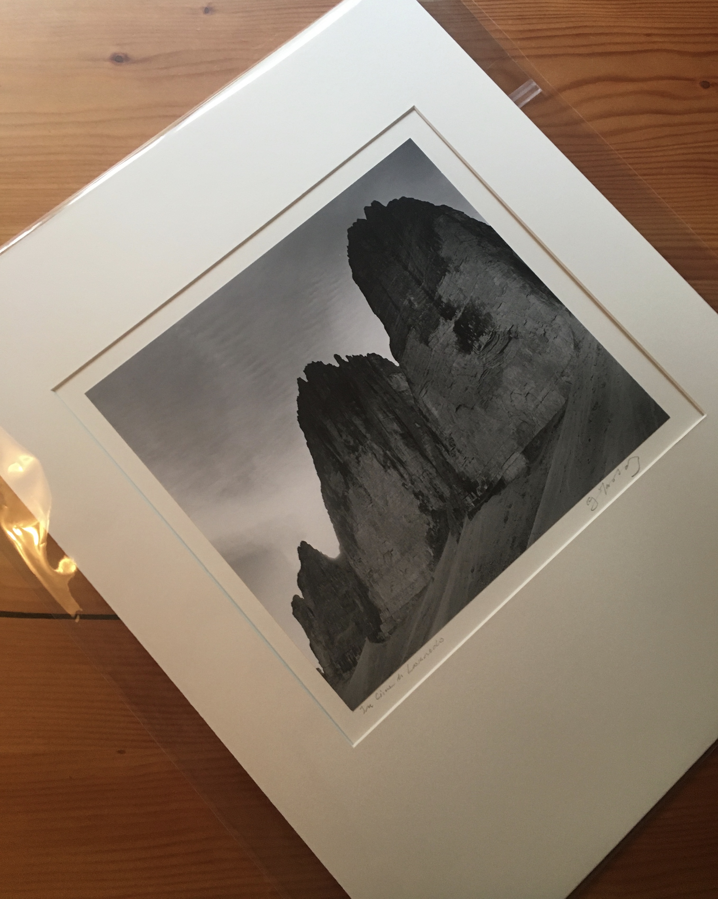

When I print, I usually either do a full spread with no borders, or thin borders like this, to be able to fit the photo inside a passepartout/matting :

Thanks, I see, so, this is related to framing the prints, with no matting, and therefore making an aesthetic choice in now the final print will look, framed, with just the photo directly under the glass?
I can understand that, but I seem to have seen some print like this, even when they are matting the print, and it seems to be so common, so I was basically checking to see if there is some theory/advice or guidelines that I have missed here.
I agree that a huge print with a 2-5 mm border may not look that cool until it is matted and framed (that is why I mat and frame all my prints), at the same time, it seems like an awful waste of paper, if you were to print huge, with even bigger white borders.
Well, virtually none of my prints end up behind glass, so the point for me is also to make those enjoyable or at least acceptable.
As to borders on the paper even on framed/matted prints: consider that a matte acts as a limit or border around the print. It boxes in the image. It just feels totally different to have the same image with some space around it, and then the inner edge of the matte, or the inner edge of the matte straight up to the edges of the image itself. Try it out and see. And again, if you don't feel a difference, don't lose any sleep over it.

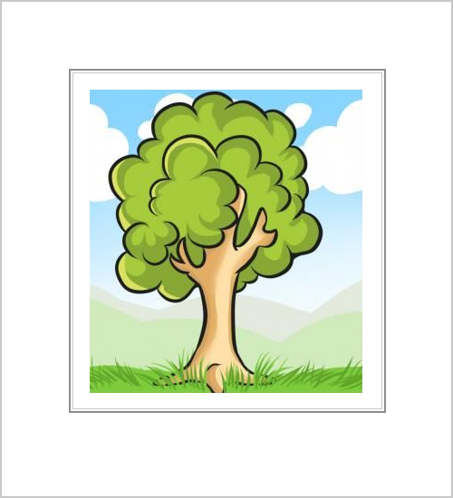

But there's a difference between these two:
View attachment 357104View attachment 357105
Sure ... if that is what you'd do. Cut the window with no white border around photo, but cut it where you want within the frame. I don't want to "steal" your work and edit it, but I'm sure you see what I am getting at. With right photo, there won't be even any drop shadow around it either.
@Hassasin there are many ways to do this, but even if you matte over the edges of the actual image so that there's no unprinted paper around the actual image, the matte acts as a border, as a literal 'bump'. This does something, visually. It may be OK or even desirable in some cases. It may be detrimental in other cases. I think there are very good reasons to (sometimes, or in my case, usually) print with broad borders.

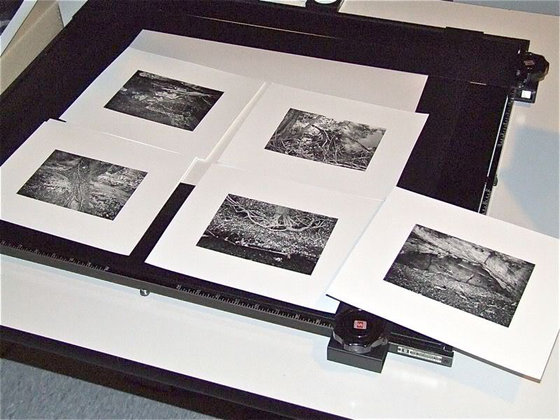

I almost never frame prints (except for exhibition) so I make a pleasing border during the printing process.
Notice ic-racer's easel. I have 2 Saunders 4 blade easels and print each picture it's own size and shape with fairly wide, often asymmetrical borders.
It gives the picture the space a mat would without cutting one.
I've done books this way.
