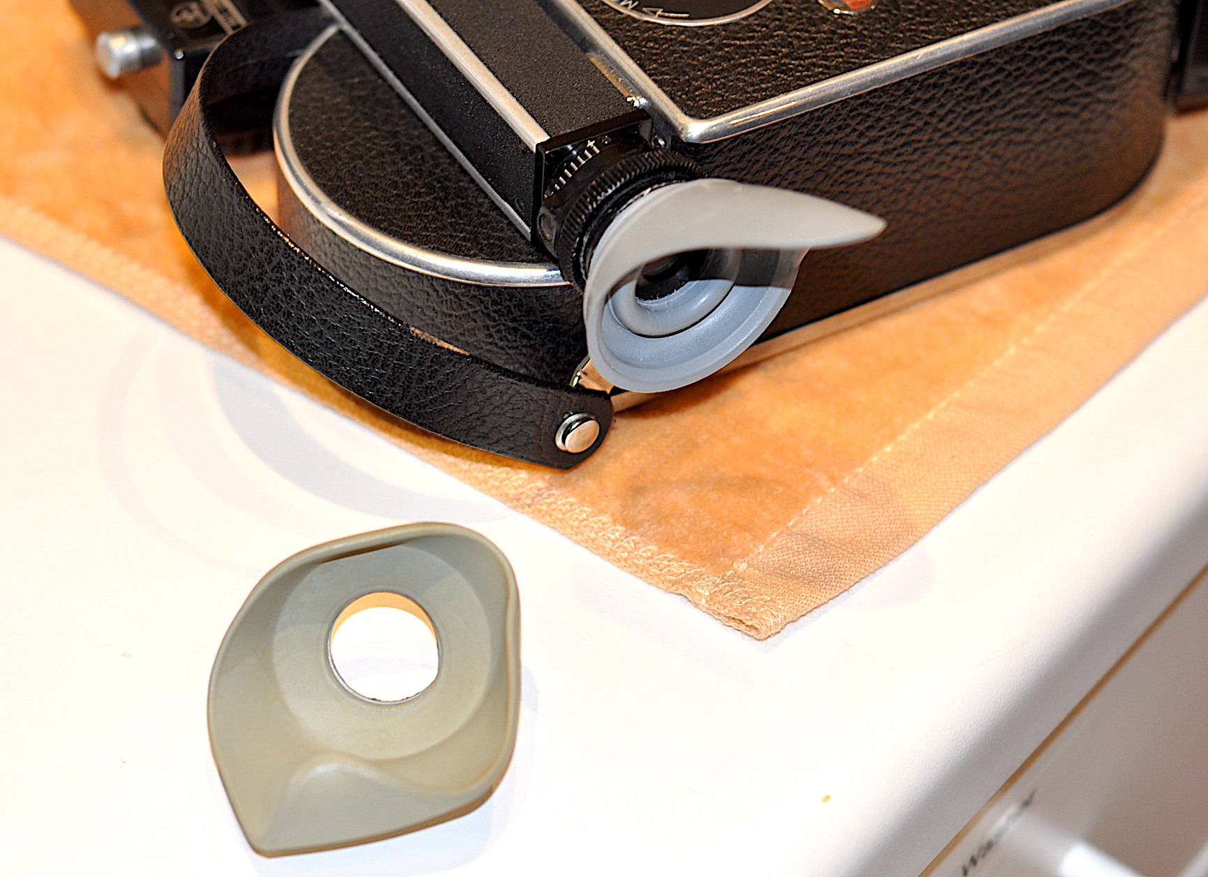

Got a new eyecup for my BOLEX H-8 REX.
The eyecup is essential to limit light exposing the film from the eyepiece and also the single-lens-reflex image is dim. The image is dim, both because of viewing at working aperture and the limited light available from the beam-splitting prism that is always in the film path.

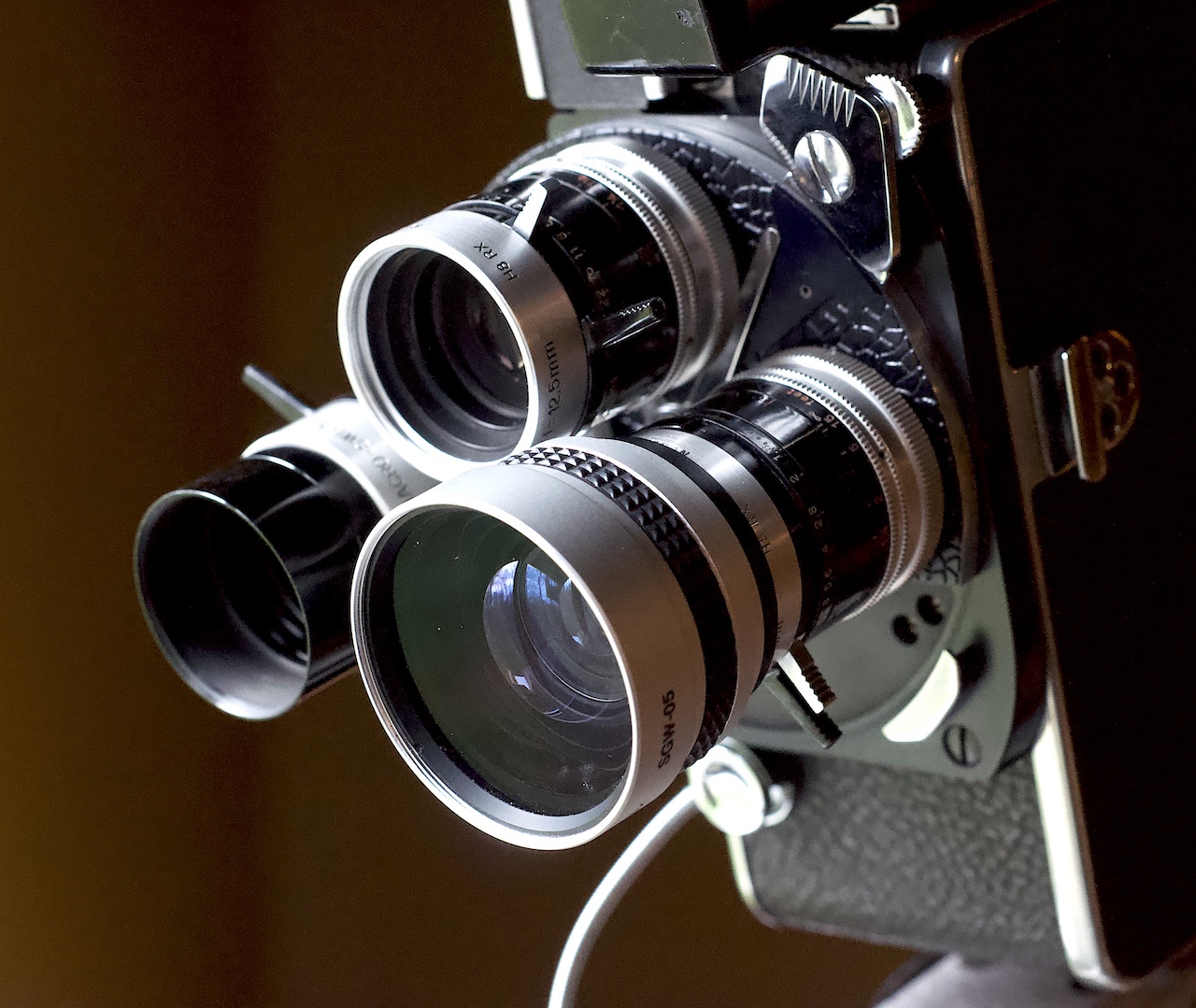

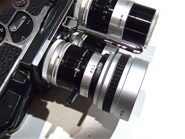

With the tiny lenses for 8mm I try to never stop down past f5.6 as image quality really degrades with tiny apertures. So I have ND filters for all my lenses for outdoor shooting. I use ND 0.9 (3 stop).
The REX cameras have the variable shutter, but it is only calibrated for reducing one stop maximum.

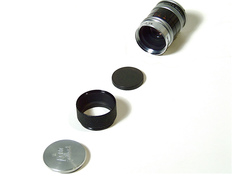

In case you don't know, many Switar and Yavar lenses use 'drop in' series size filters that are held in place by the lens hood.

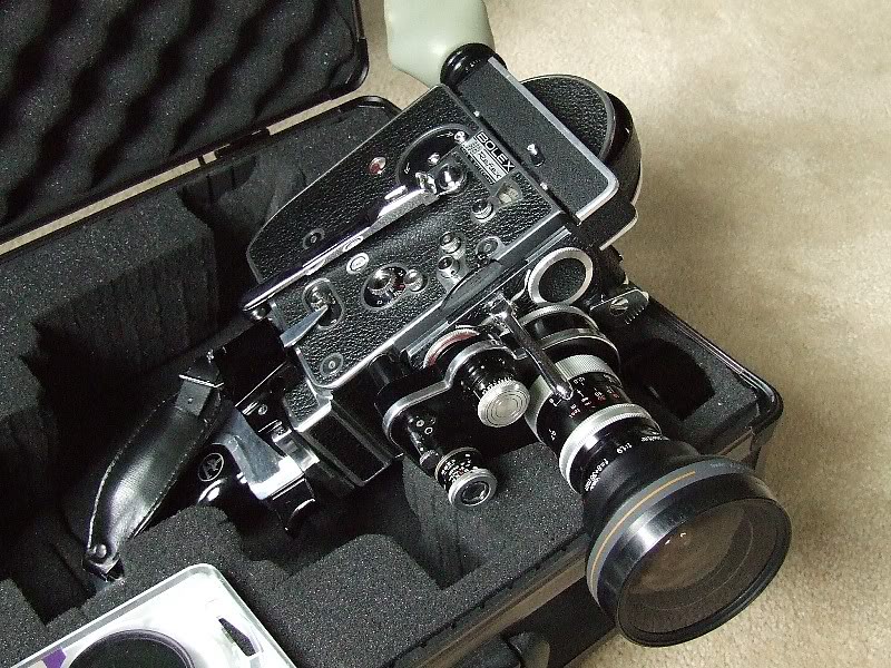

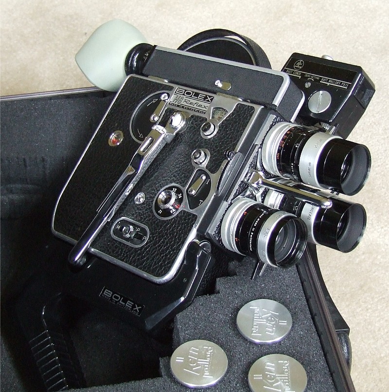

This is the one that got the new eyecup in post #54 above. An early 'round bottom' 8mm REX. As far as I know, these were the only 3 primes ever made for the 8mm REX series of cameras. So I have a Kenko 0.5 Wide Angle adapter on the 5.5mm lens to bring it down to around 2.5mm.

Tell me how do you use the fixed focus 5.5mm lens?
Cant find anything about and I don't have a D mount in reflex to look through the view finder.
The 5.5 mm lens came with a 5.5mm adapter that slips over the end of the side-mounted viewfinder. It extends the 6.5mm view to 5.5mm. I do have this for my non-Rex camera but it needs to come off if using the longer lenses and there is not good place to store it. Maybe I need to make some 3-d printed part to hold it to the camera when not in use.
