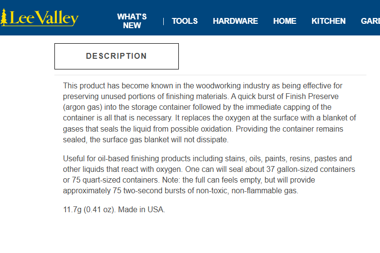

Guess I am the archetypal rube who doesn't read the fine print: 1.2 grams of Argon per can. The cans do feel empty and the gas pressure is low.
Live and learn (or do I ever?), I just hate that I could have bought a boat load of Butane for what I paid.
I am sure there are customers who are satisfied with the product and amount, but I don't think I will be a repeat customer.
