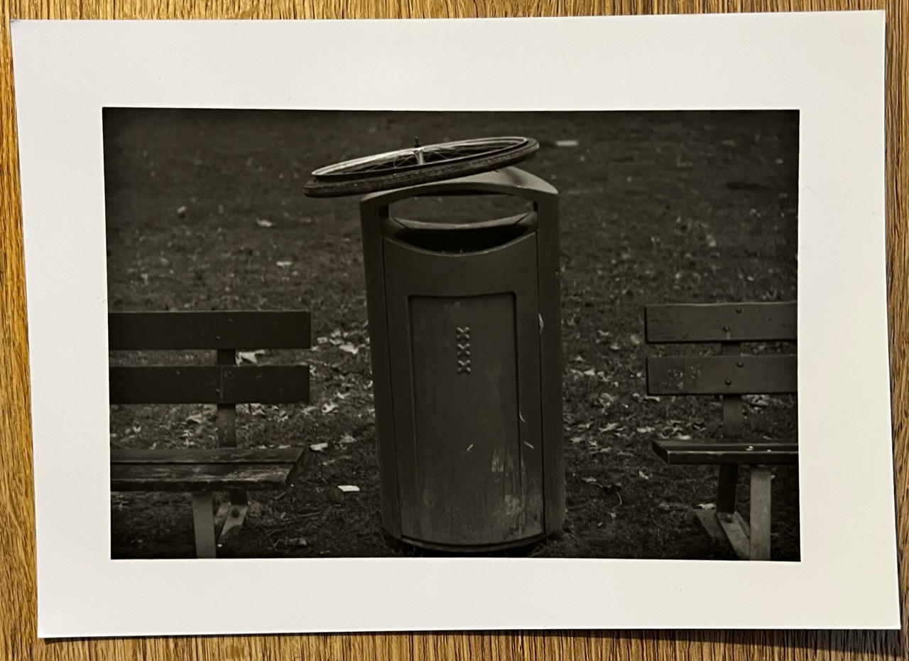

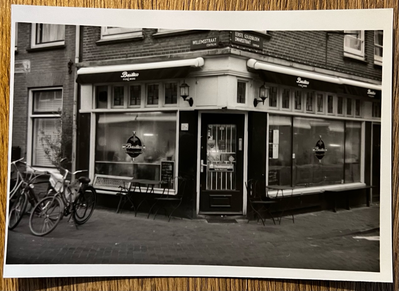

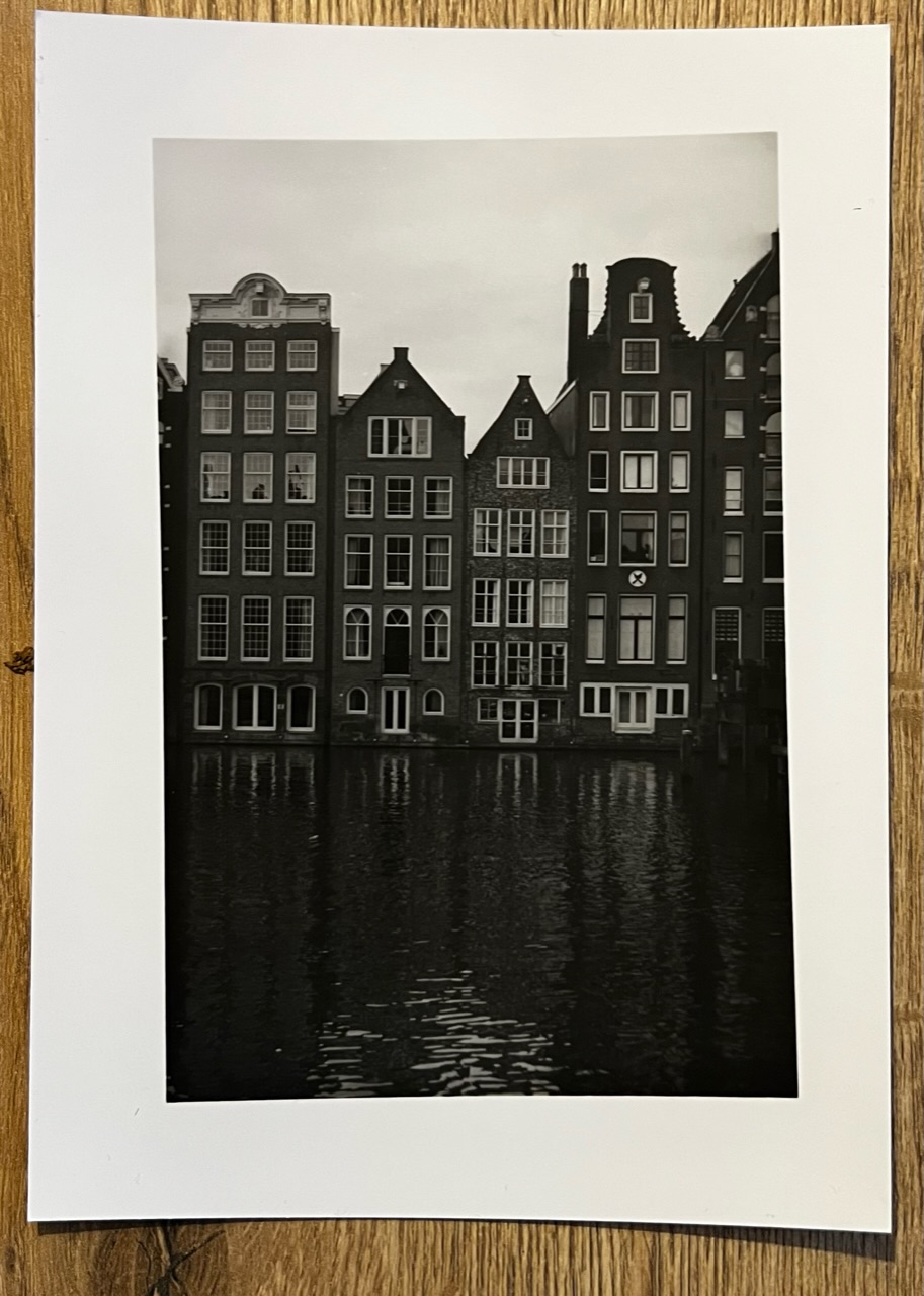

Hi all,
First of all, thank you again for all your support and help. While I’m super excited about the analogue & darkroom journey ahead, I’m in awe for finding such a supportive and collaborative community here 🙏
I applied some changes into my processing:
- Realised that I had thin negatives - underdeveloped my film rolls
- Distanced the trays to avoid potential splashing/contamination from stopbath to developer
- Simulated two stops ND filter with my enlarger’s CMY filters
- Increased to f11 when printing
- Did not pull the print from the developer until it was really done
- Were more careful handing my papers (avoiding fingerprints etc)
The results? Printing for 10 seconds and developing for ~1min 20 sec, no distortions & “visuals” at all!!
Still a ton to learn but as I like to think…progress over perfection. Thank you all once again. Have an awesome day!

Fantastic! What a satisfyingly positive outcome! (Pun intended.)
About tray spacing… it isn’t fixed. I keep my trays an inch or two apart to allow rocking, but while I am holding up the print to drain off excess chemical (which for example can take 20 sec for a 12x16 sheet) I shift the current tray and the next tray close alongside so that any drips from the print during transfer fall into a tray rather than onto the bench. Helps to keep the darkroom un-contaminated. I’ve seen folk in online videos splashing chemical about gaily, but that’s not cool.
Excellent! Lots of progress in one session. Nice prints!
