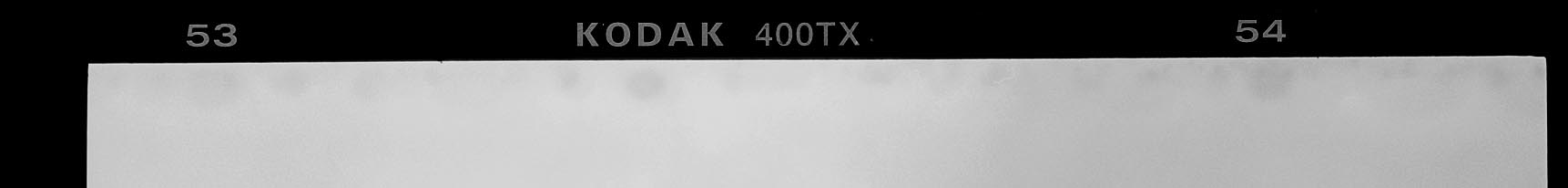

Hello All
I've taken up development again, and after getting my hands wet with a 40+ years old System 4 Universal tank and 2 old reels, I decided to get a new, modern Paterson Super System 4 3 Reel tank and four new reels .
But with the new tank/reels, I'm experiencing some odd markings near one of the negative edges (see attached).
Is that an agitation issue (I do inversions), an issue with two reels in the tank of is it the reels who are at fault?
In tried to develop two more with the old reels in the tank, and I can't see this issue with those films.
I hope somebody has previous experience, and can point me in a direction to resolve this.

If that was the upper edge of the film on top you might not have had enough developer/fixer or both.

Neal, thank you.
Wouldn't too little developer/fixer in the tank mean that the top part should be underdeveloped along the edge? The negatives don't have a light patch running along the edge, only the lighter areas at the edge have these blobs/eddies. I'm just trying to understand.
I'll check if the top edge is above or below the edge of the spool.
Michael
Are you are only using two reels in a three reel tank? Are you placing an empty reel on top to keep the others submerged properly? You may be getting some foaming that sticks to the upper film if you aren't using enough chemicals.
That's not from too little solution -- those look like foam marks. It's the same problem I had when I upgraded to the three reek Paterson tank. I wouldn't be surprised if you said you were using HC-110. It was foaming like crazy for me even with the gentlest agitation (inversion in my case). Granted, more solution at the top would alleviate (or eliminate) the problem, but I think you have coverage of the film -- and you can only fill those tanks so much above the top reel. This was the beginning of my migration to stainless steel tanks.
Check to see if your developer is foaming excessively. If so, perhaps try figure-8 agitation whereby the tank is never turned upright.
Edit 1: If you're using two 35mm reels in a three reel tank, trying using the maximum volume of solution that the tank will hold if you're not already. (I see you're using 120 though, so this wouldn't help.)
Edit 2: If your reels were previously exposed to PhotoFlo or some other drying agent and not rinsed properly, it's possible that they're retaining some of that and helping your developer to become sudsy. I've not experienced this and you say they're new reels, but somebody will inevitably mention this.
There has been a thread on this before, can't recall the title, but the consensus was that these marks are caused by developer foaming. The solution is to have the top edge of the top reel low enough below the foaming developer. I have had these marks when doing 2 rolls of 120 in a Paterson 1 liter tank. I tested doing 2 120 rolls in a 1.5L tank with about 1.2L dev and there were no marks. That was Rodinal so I don't think it's specific to any particular developer.
Rick A; 2 120 reels in the tank, yes. No space for a third reel.
bvy; it's D-76 1:1, I haven't seen any foam, but I'll try figure-8. I've been looking into steel tanks, but can't see where to buy them here in Europe... any suggestions?
I've just checked to see if it only was the top reel, but no, both reels in a single run shows the issue.
Michael

I have experienced the same kind of blobs when loading my Paterson tank with two 120-reels. I concluded that the blobs are due to foaming and have since then been very careful with the use of PhotoFlo. I now rinse the reels/tank very carefully after each use. Additionally, I have now also a 10 inch wooden stick (approx 1 inch in diameter) in my darkroom that I use to "knock" multiple times and all around the side of the tank; I do this after each agitation sequence. My thinking is that these knocks will induce "sonic waves" on the liquid surface that will either explode the foam bubbles or shake em loose from the reel, seems to work....

You might also try a "dry run" -- load a reel with film (exposed or sacrifice a roll), prepare your developer, and go through the motions as if you were developing. Then visually inspect what's happening inside the tank at various intervals. If there's bubble or foam, you should see them.
Use one or two drops of Edwal LFN in your developer should the stop foaming issues. Also, use a clip or wrap a rubber band around the center core of the tank to stop the reels from climbing when inverting during agitation. If this doesn't help, switch to stainless tanks and reels.
The Super System 4 tanks give you enough room to cover two 120 reels completely with developer, plus a good bit more, with room still for a bit of air. Take advantage of that.
Consider a pre-wet as well. I think it helps a bit.
Don't let your reels get close to Photo-flo. Take the film off the reels and put it into the Photo-flo loose, followed by a bit of see-saw agitation.
Make sure that you load the film past the ball bearings, so it can move slightly within the grooves of the reel.
Bubbles. After you invert to agitate in a film development can, bang or knock the can to dislodge the bubbles. All my NIKKOR cans have banged up bottoms from setting them down hard.

Thank you for all your comments and suggestions, please keep them coming. I haven't had time to run a test run on Tri-X yet, with pre-soak.
I've been reading up on foam issues, and the images I've found matches my problem. I guess I have to change my agitation technique.
Just to clarify/respond to some of the suggestions.
The tank is 1 liter, holdes 2 reels of 120. The liquid covers the top reel. The top reel can not move upwards because of the Paterson design, the center rod is flush with the edge of the top reel. I always rap/tap the tank after agitation to dislodge any bubbles, three taps each time.
I've been kind of obsessed with the cleaning of reels and tank, using toothbrushes and dish brushes, and a lot of water.
I've seen the blotches on both the top and bottom film. And it's also occurred on C41 films. It doesn't occur with my very old reels, only the new ones. The design is slightly different.
I'll be trying "half-inversion" e.g. from vertical, rotate my wrist to the right to horisontal, back to vertical, and likewise to the left. I'll be turning the tank so it's not the same edge that leads and creates less repetition of the fluid movement.
Again, thank you for your help, all advice and every comment is appreciated.
Michael
I tackled this problem pretty aggressively last year. Did a number of tests. I won't bore you with the details, but I can distill it down to the highlights:
- Even the gentlest inversion agitation still produced foam.
- No amount of banging on the tank (bottom or side) helped.
- Presoak did nothing.
- Adding PhotoFlo did nothing.
- Adding Edwal LFN did nothing. (I bought it for this purpose based on Rick's and others' suggestion.)
- Figure 8 agitation did alleviate the issue significantly, but I think caused unevenness in other ways.
As far as adding wetting agents to developer, I would only consider it as a last resort. I wouldn't be surprised if different emulsions responded to them in different ways... And if the reels really do retain these agents, remember they're sitting in developer much longer than in a final bath.

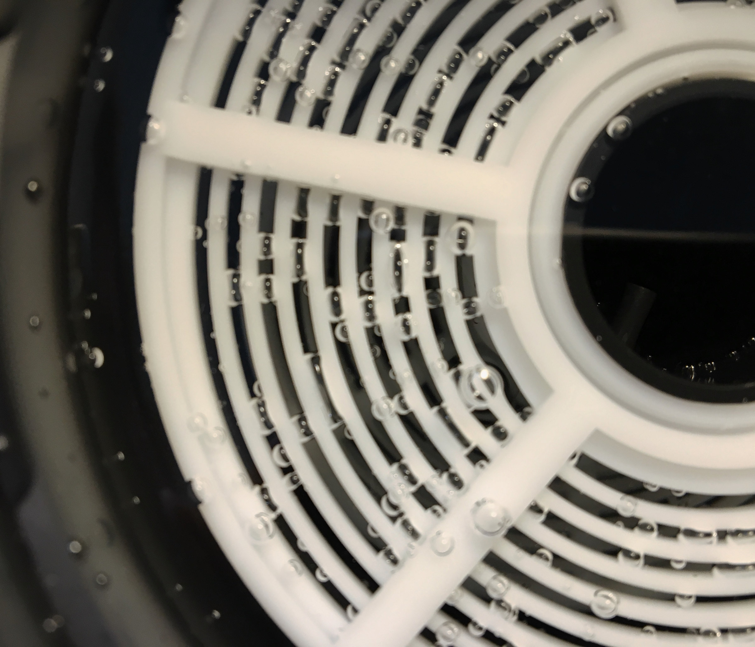

So, my investigation (and a ton of online reading) have me thinking the issue is air bubbles clinging to the new reels, like this
This is in demineralized water, no wetting agent. I tapped the tank 5 times hard after all the water had evacuated the funnel down into the tank.
The problem doesn't seem to be foam, which stacks the bubbles on a larger portion of the image, and not just in a single row at the edge of the frame.
Across the internet, some people are experiencing the same with Paterson Super System 4 Multireel tanks, and it seems to be solved by changing the water. So I'm ditching the (expensive) carbon-based calcium-filter, and I'll look for other options. Trying to track down where to get distilled water here in Copenhagen, Denmark.
Also, I'll be testing adding a wetting agent, as suggested by Rick A, to soften the water.
As always, any suggestions and hints are very much appreciated.
