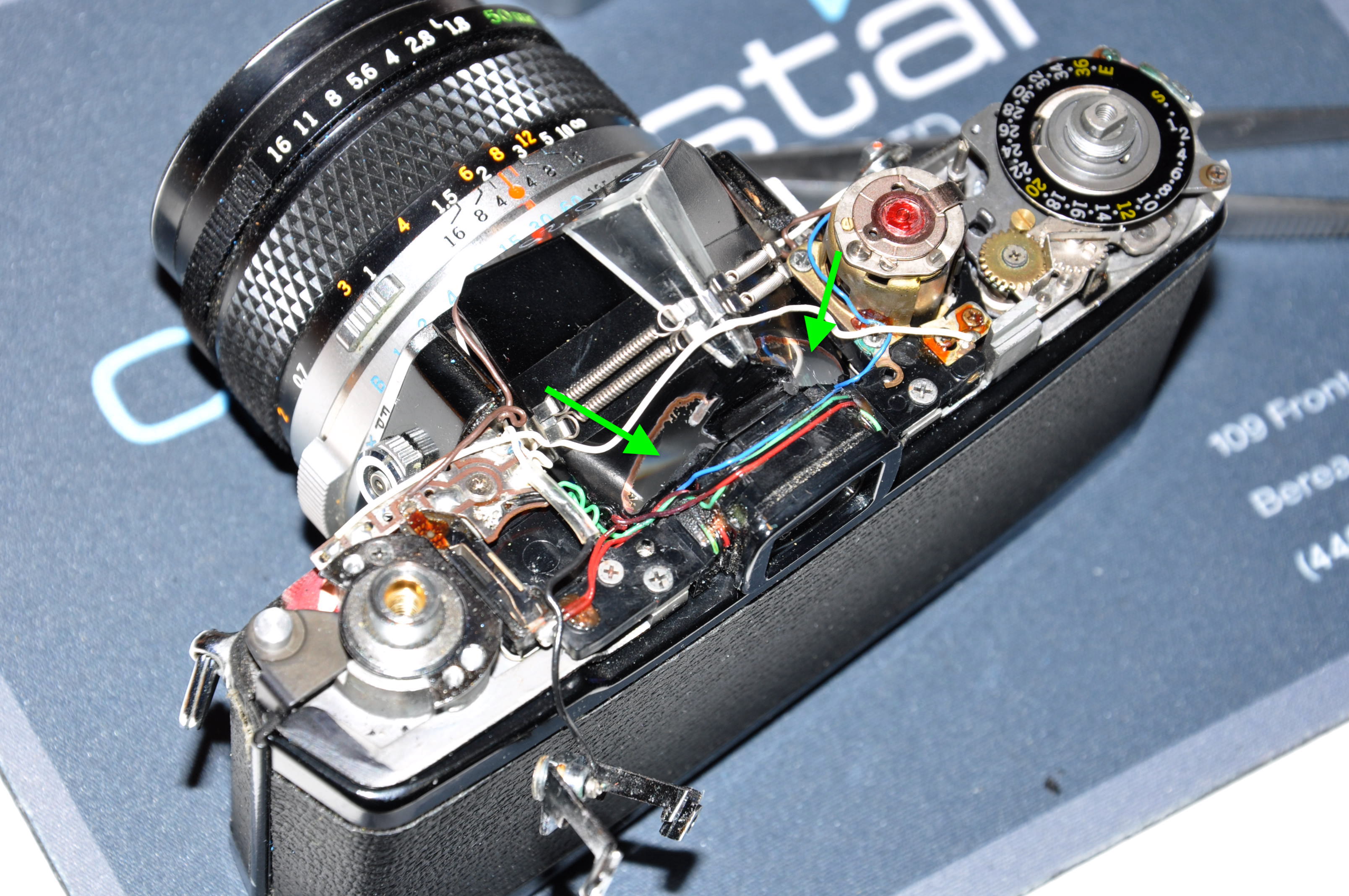

What makes you think anything is wrong with the prism? Looks to me like a piece of foam has broken of and fell down and landed on the top of the focusing screen. All you need is set of Vessel JIS screwdrivers off ebay and a youtube video showing you how to take off the top panel and knobs so you can get to the topside of the focusing screen. Childs play. GL

Desilvering was mentioned. When I looked up that term I saw the same condition that I have in my finder and it led me to threads talking about the prism needing to be replaced. I'm still new to all of this repair stuff. If it is just stuck foam then that will be a relief. What I'll do then is just get the screwdrivers and open up the top and see what is what. I'll keep updated.

Might be desilvering, but Idoubt it. I've worked on more camera than I can count and never seen desilvering look like that. Looks to me like a piece of foam has fallen on top of the focusing screen. All that old Japanese foam has decomposed and turns into a mess. The beauty is that the K1000 was a camera they made a trillion of. They're not a bad camera at all, but they have no market value. The only wat to find out is get a set of cheap JIS screwdrivers and maybe a cheap ebay spanner wrench set and open it up. Nice camera actually. I'm not disparaging it, so don't misunderstand. But for years it wast the most popular 35mm and they made a trillion of them. What have you got to lose by opening it up for a look-see? You can pick up another K1000 for practically nothhng.GL and Regards
The viewfinder photo you showed exhibits deteriorating polyurethane foam used for light sealing and as a top cushion between the pentaprism and the piece that holds it in place, There are light seals about the base of the prism where it sits in its receiver. The piece at the front edge of the focusing screen serves as a cushion. It decelerates the mirror at the top of its travel.
I see no evidence of a de-silvered prism. That looks quite different. I heard the following advice when I was young, “If it ain’t broke—don’t fix it.” It made sense then. It still does.
On the picture in the OP, you can see a symmetry line of sorts in the centre, with the sides of the black stuff slightly less in focus. That's the roof section on top of the pentaprism; the silvering has deteriorated in that area.
I guess it could be desilvering along the top crest line of the prism, especially of the factory had put a layer of foam contact with it. The Japanese in all their design and manufacturing expertise made these fine instruments, but the devil mimself got in on the act with his foam. God thing this was about the most popular SLR to come out of Japan. Plenty of parts cameras cheap as dirt.

On the Olympus OM1, one can just clean off the goop and the desilvered portion is hardly noticeable in the viewfinder.
