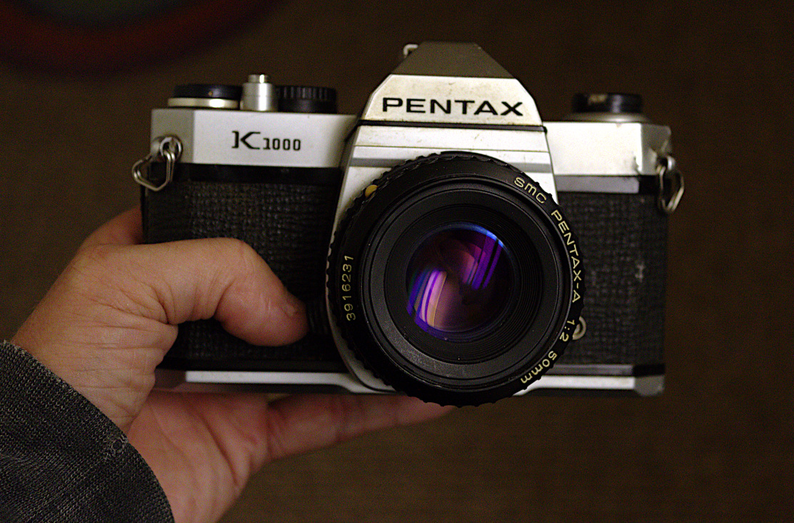

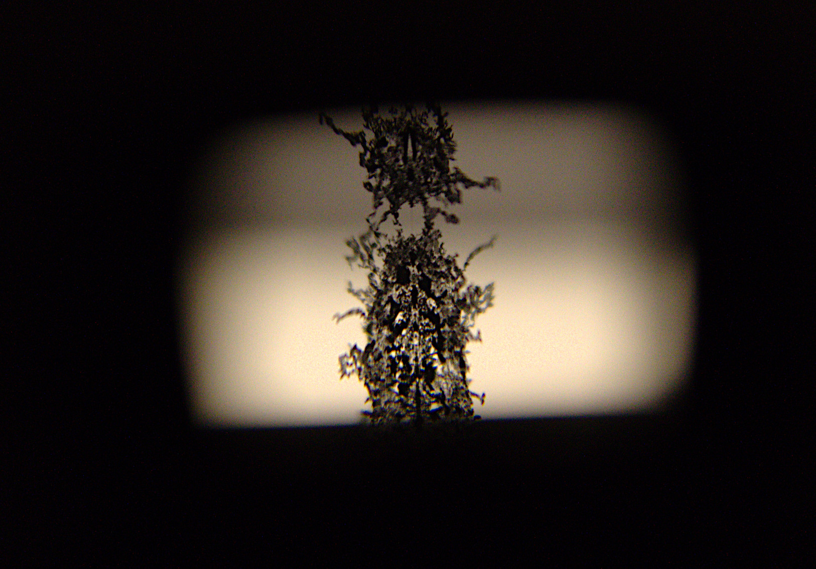

About five years ago I brought out my K1000 that was in storage for a good 20 years. It had film in it. Bulk loaded roll of Tri-X from 25 years ago. When I inspected the camera I noticed some black objects inside of the viewfinder. I removed the lens but didn't notice any black marks on the mirror and upper glass. Must be on the viewing side? I have included a photo of the black marks.
The camera was packed in a closed box, in my closet, away from humidity. There wasn't anything wet in the closet.
At some point I am thinking of getting the camera serviced. It also has a slight ding on right hand corner of the metal, no idea how that got there. The ding was there some time before the camera was stored in the closet for all that time. It appears that a very slight part of the metal is lifted up where the ding is. I'm thinking I might need a whole new frame part and viewfinder system? Is this camera even worth getting fixed? This was my very first SLR. Bought in 1992.

That could be some sort of fungus in the viewfinder. Does it move about when you shake the camera?
Black marks do not budge when shaking the camera.
I'd say it's fungus. If it doesn't completely clean off, you'll need to replace the affected part. Fungus thrives in warm conditions and when there's a lack of oxygen. Air flow over the camera may have prevented that contamination, in other words, if the camera itself was left in the open air, even in the closet.
To me, the black bit looks more like the kind of foam which is commonly used for light seals and mirror bumpers. These bits are often somewhat sticky.
Only you can decide how much a used camera is "worth" to you.
At various times, the Pentax K1000 was made in Japan, then Hong Kong, and finally China. Personally, I would be willing to invest a little more money in a Japanese version than a Chinese one. Yours is probably not Chinese because I think those had a plastic top plate(?)
I send my old Pentax cameras to Eric Hendrickson in Loudon, TN. I think Eric is well respected for the quality of his work, and his prices are very reasonable. According to his website -- https://pentaxs.com/process.html -- he is still servicing the Pentax K1000 for $88 US. If any significant parts are needed, that will add to the cost.
I agree with others who say keeping a camera in a closed-up closet may promote fungal growth. But as I said, I don't think that looks like fungus, and foam bits are more likely. Is your lens clean and clear?
I believe that the answer given in post #5 identifying the debris as deteriorating light seals or mirror stop-pad material is the more likely explanation. The material is most likely polyurethane foam, which can dry out and crumble, and sometimes become “gooey” like asphalt.
To me, it looks nothing like the type of fungus that occurs in cameras and lenses. The view through the finder shows a structure that, although magnified, is far too large to be fungus. It looks like no fungus growth I’ve seen.
Totally agree. As a former employee of a clinical laboratory with a microbiology department, I've look at a fair amount of fungal hyphae under the microscope, and it looks quite different from what is shown in the OP.

You can see the type of material I referred to in the photos in Richard Haw’s camera servicing site where he disassembles a Nikkormat EL. One shot shows the material in the retainer atop the prism. Several pages later, there is a good photo of the deteriorating mirror pad next the focus screen showing a green circle superimposed over a screw head.
https://richardhaw.com/2018/01/27/repair-nikkormat-el/
This looks exactly like the material shown in post #1, but at a lower magnification.

Yep, totally agree. My cousin stopped by last week with an early Spotmatic, mirror had black bits from the the gooey degraded mirror bumper foam. Every brand does it Nikons etc. New foam seal kits are available on Ebay. Meanwhile a cotton swab in a bit of lighter fluid, just a drop, will usually clean the mirror (temporarily)
I think this is prism desilvering.
I looked up that word and the effect does look like what I have. The example I saw didn't look as severe as what I have going. Few have commented that Chinese made K1000's have these issues. .The fix is a either a new coating or a prism swap.

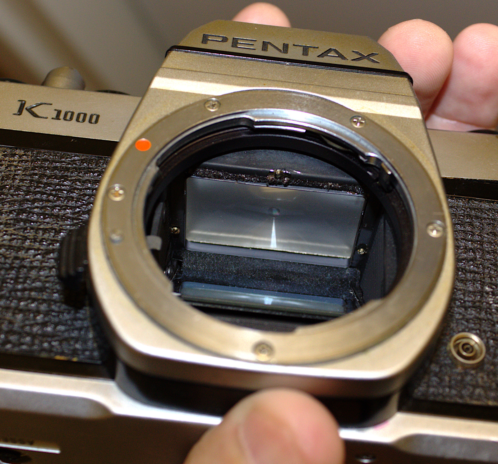

Seals will mostly be around the back, shouldn't need to disassemble. Mirror bumper you just reach in with your fingers and a tweezer. Easy. Don't worry about the shutter if it sounds OK.
A lot of cameras have foam light seals under the top cover, not easy to get to
Thing is would the pieces that are showing in the viewfinder be connected to that top seal so that by removing the top seal with tweezers that the marks get taken out from the finder area? If the pieces in the finder area are dislodged from the actual seal then I might be in for some fun.

If it's a vertical line down the center, you'll want to replace the pentaprism, as it's become de-silvered, probably due to deteriorated foam cushioning. In order to prevent it from happening again, I'd stick a piece of Kapton tape (silicone adhesive) onto the new prism, so the replacement foam doesn't touch the prism directly.
I'm looking into parts on eBay. I think I'm going to take a crack with doing the repair myself, some point in the near future. Thanks for the tip on the adhesive..
