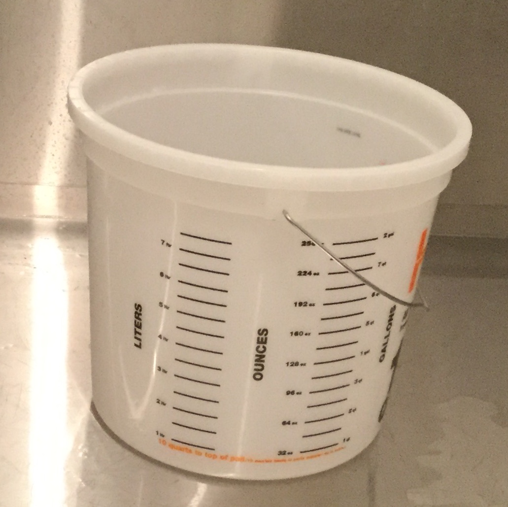

I went to Home Depot recently to find a bucket for mixing the 5 liter batches of XTOL. I found this graduated bucket in the paint department. The markings are pretty accurate, too.
Ed
Ed
That's a great idea. My bucket has no markings so I have to measure the resulting volume of 4 litres + the dissolved powders to accurately make up the volume to 5 litres.
Ed
That is what I have done for years.
