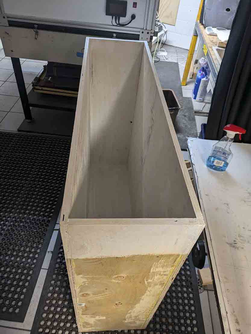

We are in the process of building a 33inch x 44 inch six slot washer for big murals, I will post as I move on this project, hope to complete in two months
Looking at the Gravity Works 20"x24" I have here sitting in storage that is going to be a massive undertaking. It would be close to having 4 of these units set together. Good luck with the build and I am looking forward to seeing the final build.

Oh yeah, of course, I remember you inquiring into this a couple of weeks/months ago @Carnie Bob . Good to hear you've gotten started on it. Looks like a regular vertical slot print washer on a massive dose of steroids. It's going to contain, what...a metric ton of water or something?

Yes I have a 20 x 24 Calumet washer we are kind of basing it on, this unit when empty would be put on 4 x 4 or 6 x 6 blocks and drain to the floor drain.

So we figured that we would be around a ton in weight when filled with water , therefore the unit will have castors to move when empty but when ready to use it will be lifted onto huge blocks to hold the weight.

I used your dimensions and figured 20 inches wide and came up with just over 1100 pounds of water at 70F. I actually plugged in 34x45x20 inches. Then you add the weight of materials and you're still under 3/4 ton. Impressive undertaking to say the least.

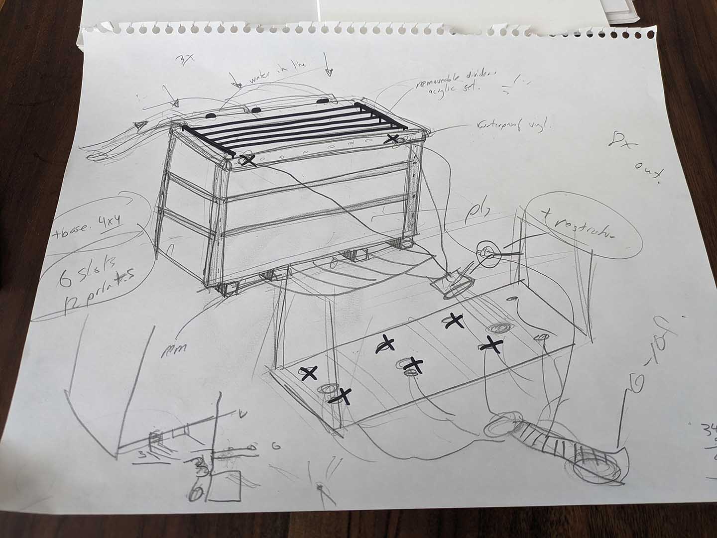

I got my idea from a Clyde Butcher video , one of his assistants was using a big vertical washer next to the sink. for the life of me I could never find that video . We are going to McGuiver this one
I think at the end of the day it will be around 2-4 k to make happen, its worth it to me as I do have clients asking for murals 30 x 40 but I have been hesitant as I can only at this time horizontal wash big prints and
it takes forever to do this and wastes water and energy to heat the water.
Yes it won't be pretty but it will be solid, if not I will have a lot of mopping up to do in the darkroom- I figure it will be 34 x 45 x 16 inches , we will be using 1/2 inch plexi on the inside to separate the prints

1/2 inch plexiglass for the dividers is way overkill I would think. I think you could use 1/4 inch no problem as it’s fairly rigid especially in a vertical orientation And would cut your weight in half. Just spitballing here, good luck with it!

Hi, I would suggest to keep in mind that things like this don't scale up directly. (The same reason that ants have proportionally skinny legs compared to elephants.) So your outer frame, holding the sides together, should probably be more robust than directly scaling up.
Also, instead of setting it on blocks why not just use a wooden pallet? If your floor supports the use of pallet jacks this is a convenient way to move it around.
FWIW I would estimate the total weight closer to 1,000 lbs. Maybe a bit more depending on the frame. Roughly the weight of 6 or 8 husky guys squeezed close together. I have no idea what your building was built for, but it might be worth going to a lower floor and having a look at the structure (assuming you can see the ceiling). This might affect where you would locate your washer?

We have considered the outer shell and how it needs to be robust.
the 4 x 4 pallets are to fit precisely under the unit, no room for pallet jacks and pallet
It is on the lower basement floor we will make sure its not over the floor drain channels
we plan to roll it into place (empty) right next to the sink , when finished drain and move to a less important location.

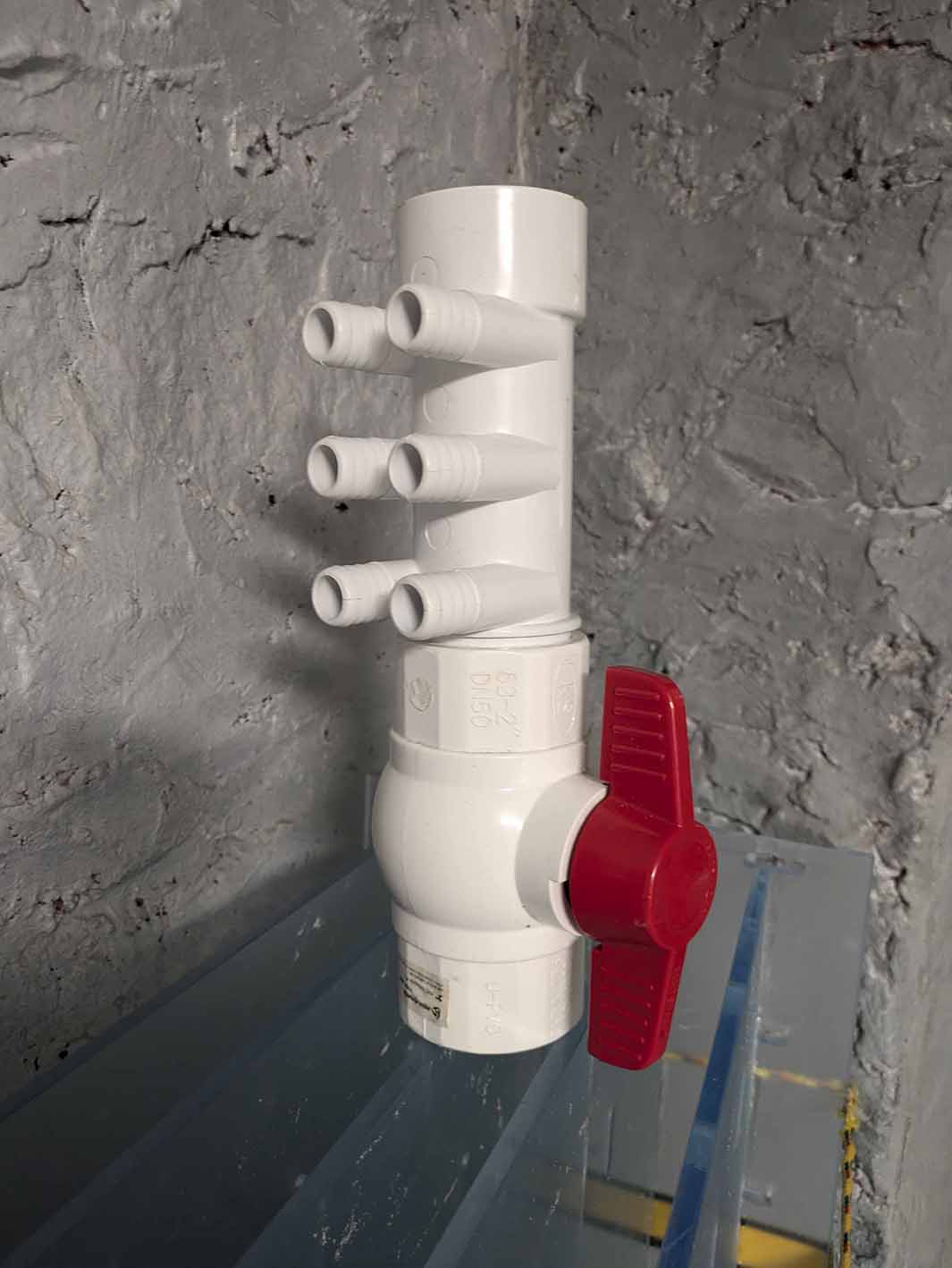

Ok so I now have delivery of the washer needs to be put together , this will same us time and water usage, 6 slot for 34 inch x 44 inch silver prints.
