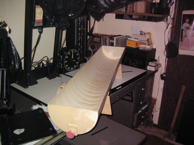

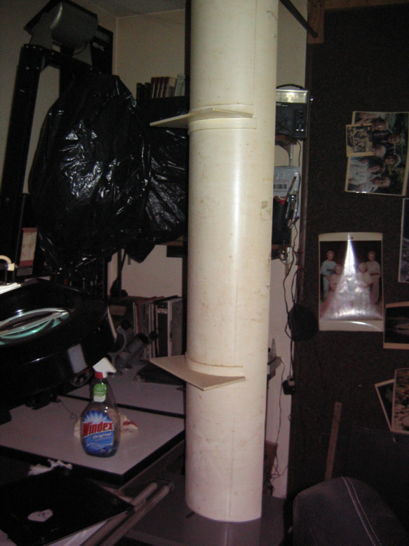

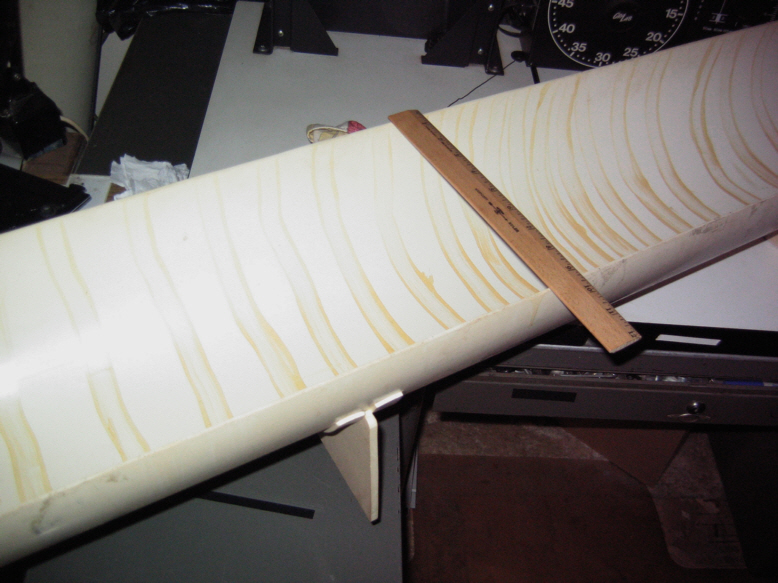

Dear ic-racer;
The troughs I use, I made from 10in diameter PVC with PVC end caps and a 3/4in drain and are 50in long and 4 1/2in deep. I used PVC glue across the bottom to form smooth ridges that keep the paper from sticking to the bottom when rolling. I think the troughs cost about $15 to make, but that was thirty years ago. I'm including some not too good pictures that I just took with a d****al thingamabob.
