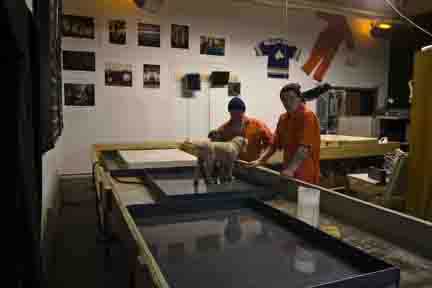

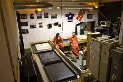

I built my darkroom and sinks around the ability to print a maximum size of 30"X40" by tray processing. Paper is enlarged vertically to max by use of a 36"X48" drop table and wall mounted enlarging head. I gave up on processing large prints (> 20X24) by roll processing as the potential to crease and damage emulsion (fiber only) was simply to great for me. I print up to 30X40 from 40 and 42" rolls in large (32"X44") plastic Cesco trays, the same as with smaller sheet sizes. It's a bit tight with 42" roll paper, but still reduces handling only to moving from tray to tray. I use 5 of these large trays, committing one to wash by installing a homemade water distribution manifold and drain:
I shuffle up to six prints in the wash after toning and clearing baths (Permawash replacing water in the stop tray (TF-4 Fix)), while filling and dumping every 5 - 10 minutes as well.
This is how they come out:
18X30 (left), doorway, 30X40 (right)
24X40 & 30X40 on hanging walls (6'X8') in backroom
20X24 on far back walls
and
30X40 flanked by 20X24's
BTW, the warehouse personnel at Calumet LA, where I purchased the trays, laughed at me as I squeezed them into the back of my Toyota 4-Runner, quipping "Are you going swimming?"

The lag time between dev and stop would be impossible to predict, flow lines and uneven development issues would be tremendous. I know there are those out there using single tray method for smaller prints , but for murals I see it as a very problematic way of working.
I would suggest a series of troughs that hold enough chemistry to completley immerse a rolled up mural and by rolling it through your hands and then rotating it back through the chems will work.
We run lambda murals this way in complete darkness.
For safelight work we use monster trays.
Single tray IMO would be nasty.
Bob.
Is this what you are referring to?
http://www.youtube.com/watch?v=i3syVdV6XbY#
Do you notice four troughs dev, stop fix , fix I would imagine.
the big burning in card is cool,
In my setup the prints would not be made horizontally but vertically which I think is easier.
40x60 and above would be done horizontally.
Thats pretty much how I roll the prints , make sure to hold on the sides.
