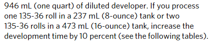

However, it is a Kodak directive that one film requires 250ml of STOCK D76, regardless of dilution.
If a person chooses to dilute 1:1, then the official way to do it is two rolls of film in a 1000ml tank completely filled with a 1:1 dilution. This indeed costs you 500ml of stock solution.
500ml for Two films.
Or one single roll into a completely filled 1000ml tank of 1:3 dilution... which still requires 250ml of stock. You see, you can’t get away from the 250ml minimum Stock.
From the horse's mouth © 2017 Kodak Alaris Inc. December 2017 • J-78
