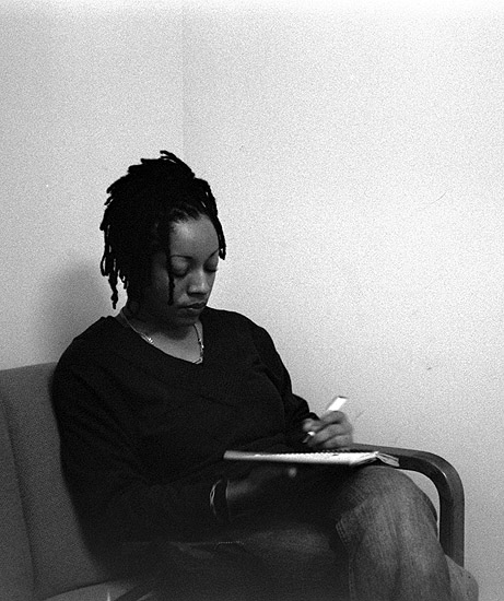

Hmmm. I wonder if it's the film or the scan?
.EDU Ultra 100, EI 400, Parodinal 1:50
This is about a 3/4 frame crop -- from 35mm, with a two stop push.
The sharpening algorithm post scan, even that in the scanner driver, can make the grain look way worse than a wet print would look. Takes a bit of careful fiddling to get results that approximate the wet results.
That's a good suggestion; the full frame (and the rest of that roll) shows some grain in the scans, as well, but I've never wet printed these. This was scanned with my old (made ca. 1998) Arcus 1200 back around 2007; if I could find those negatives it might be tempting to try rescanning them with my new-this-year Epson V850 Pro. Four times the linear resolution (= 16x pixel count) and better focus management...
