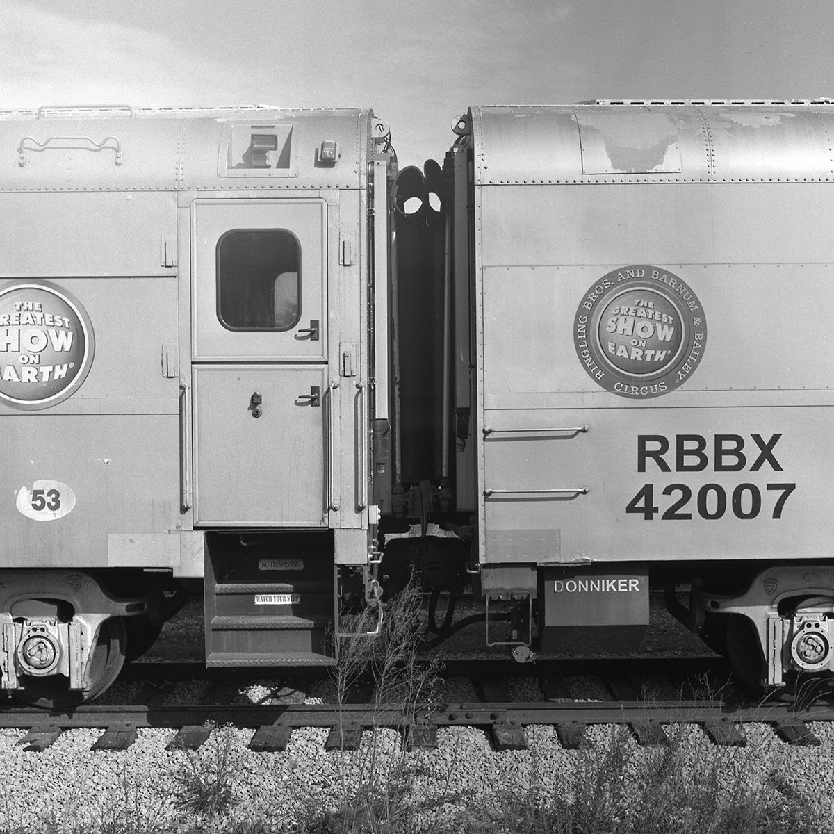

I like this grain much better.
Bronica SQ, 150mm, f 3.5 1/4 second exposure. Ultrafine Extreme 100, Rodinal 1:50, 20C for 13 minutes, minimal agitation. V600 scan. Minimal enhancements in PS, cropped to 4x5.
