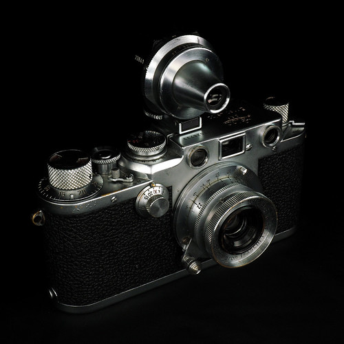

The Summaron is one of my favorite lenses. I don’t think it matters what Barnack you put it on, just get one that’s in good condition, preferably with a CLA. I use a VIOOH finder but there are many others that will work just as well.
Leica IIIf with Summaron and a VIOOH universal viewfinder.
Leica IIIf Summaron 3.5cm f3.5 by Bryan Chernick, on Flickr
a few examples with the Summaron.

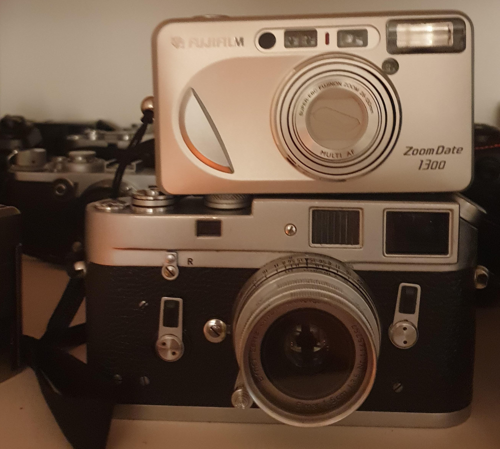

What I use often as a second camera when traveling (Leica or Nikon as first) is some P&S, like Pentax Espio or Fujifilm P&S. It costs next to nothing, has a self timer, wide angle. For lens quality - Pentax Espio is best kept secret - cheap P&S with excellent lenses. You can give it a try, it will cost you like 20$ or even less.
Edit: here is how my travel kit looks like, it is really small:
