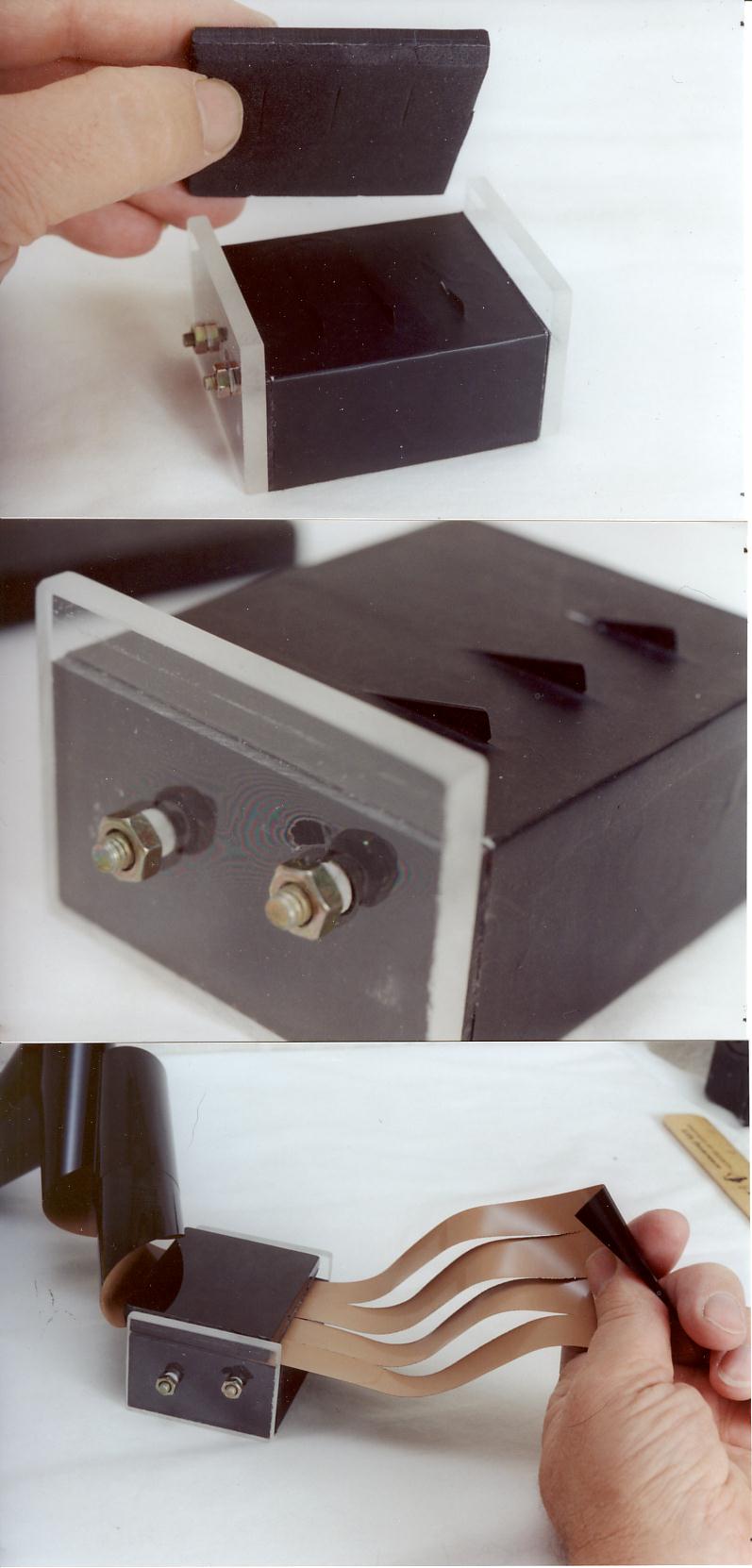

There are two inch film slitters that will cut 120 film into 127, or 127 PLUS 16mm, or 127 PLUS Minox. Same with 65mm or 70mm film.

I know plenty of people who have made very simple film cutters using a piece of 2x4 with markers & holders to use it in the dark. These can make sense for occasional short strips of submini film. HIT cameras, for example, only need about a foot of film, so this approach can make some sense, but cutting long rolls, such as127 film from 120 film, using this approach is another story. A film slitter the size of a pack of cigarettes is all you need.
I am not sure how to operate this slitter. What is the purpose of the screws on the side? Are they just holding the blades?
And to slice a film roll you first lay the film ontop of the blades, then press the black plate from the top and pull the film through?
