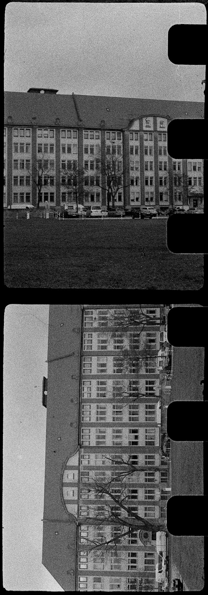

Even though it is quite scary to insert two blades in complete darkness, this instruction manual worked quite well the first time:
I just changed the blades to be 16mm from the left and right side of the matchbox, leaving a 3mm gap between the two cut strips.
I put the first roll of Ilford HP5 into my Mamiya 16 Automatic. My guess is the perforations will be in the image definitely but I wanted to find out how much they bother me.
The image of the Mamiya 16 automatic starts at 3mm from the bottom, the perforations of 35mm are 5mm high so I guess I'll lose 2mm of height.
So in the end I am going to have a 14x8mm image - is that correct?

Wow I just spent an hour walking around taking photos only to find out in the dark that the film has come loose from the take-up spool after the first picture.
After respooling and making sure the film is properly fed into the take-up spool, I found that I couldn't wind past 3 or 4 frames after it got continuously harder to wind with each frame.
How can this be? As far as I know the Mamiya 16 can handle all kinds of 16mm film, perf and unperf.
This is Ilford HP5.
8min D96, 10min Fixing.
It is pretty much as grainy as Kodak Double-X but the sharpness is better. Maybe D96 just sucks and makes everything grainy as hell.
