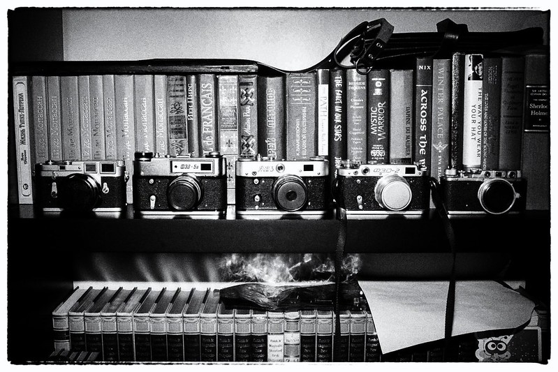

Lately I was having... no, FSU RFs are having me.
While my M4-2 was at long repair I decided to try FSU RF alternative. I never liked Zorki-4, so I decided to explore FED3 and FED5. FED3, because I like how it looks and FED-5 because everyone is saying how huge are heavy they are.

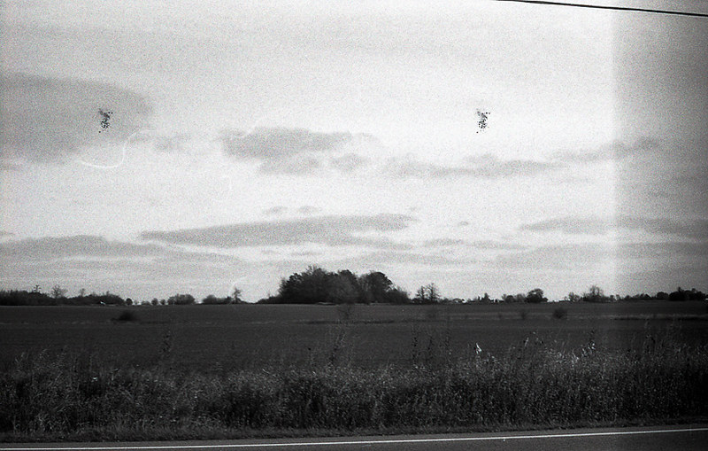

FED-3 was purchased on ebay as serviced and tested with film. It appears what Ukrainian seller just making copy-paste of these words. Camera was not serviced and has problems. And this is the camera which is having me for over that one month now. I completely re-hauled it. Still, at some shutter speeds it gives this:
Something is dragging the shutter. Can't see, feel it. All looks, operates normal. So, it will be for sale as rear cap for very good Industar-61 lens on it. It is sharp and has ten aperture blades (with plenty of oil on them, which is as usual for FSU).
Lens is good on digital Leica M as well.
I haven't checked FED-5B, yet. But it not big and it is not heavy. I have purchased Zorki which was serviced by one known in FSU person. With Leica 50mm VF it is very interesting camera. VF is tiny, but shows 1:1, it is very impressive. And Zorki RF window is also showing exactly 1:1. It is actually better than M3 VF.

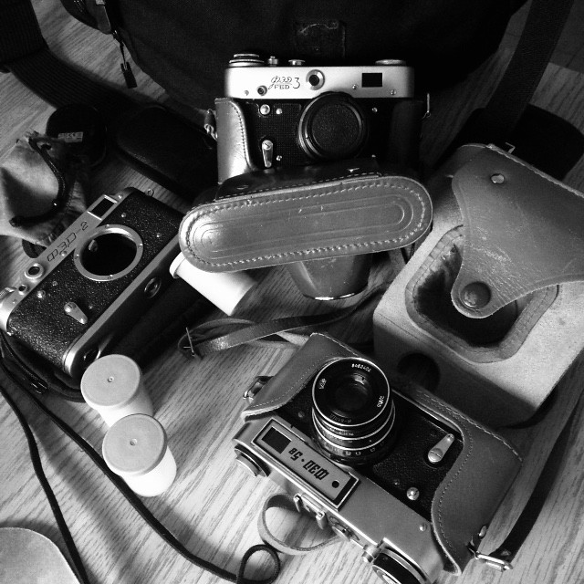

Today while in camera shop, I was asked what I was shooting lately. I opened my bag and showed them this:
And I told them what I mostly shot and re-shot sky to check if exposure is even....
FED-2 I purchased broken and for parts, was with all original parts and jammed shutter. I have it fixed, the only thing which is not fixable is the "soft" spring in the delay mechanism.
I remember how I asked the founder of this store and ex-Leica Midland technician Bodo, if he is working with FSU RF cameras. The answer was - no. Because once you start with FSU RF, you never know then you will finish and how it is going to turn out...
