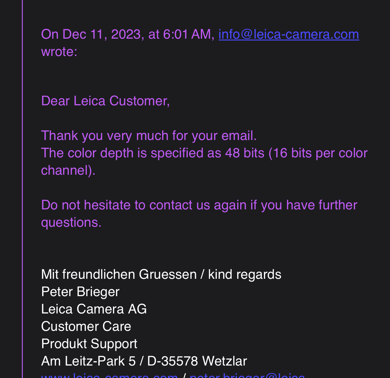

16 bits per color channel in the Leica! We need to understand how the bits are employed differently, to understand what that actually translates to...does 14 v 16bit matter?, if there is a relevant difference in dynamic range between the two. For example, using Leica information...

How does the same product have fewer bits of DR (14 vs 16) yet achieve 1 stop wider dynamic range (15), in the same Leica S typ 007 with difference of 2 bits of width?! One needs insider understanding how the 16-bit standard digital word is actually allocated.

I fully comprehend the fact that allocating 14 bits as a holder for data is fully dependent on the DR of the input unit...if you have two different units, one with 13-bits of actual differentiable data whlle the other has 14 bits of actual differentiable data, the bucket is identical (14 bits) but the data itself is better from one of the two units. In the case of Canon, we have an entire generation of product, the dSLR of the 2002-2019 period, with increasing DR even though all use the identical 14-bit of data storage allocated, because the sensors and processing circuits got better over time.
My question was how does the SAME PRODUCT description from the same company have two different specifications both for number of bits allocated and in the Dynamic Range?! and in the lower bit count of the two specifications it is stated as having a wider DR? That contradiction itself illustrates the 'take quoted specs with a grain of salt' unless you fully understand the foundation of the claim.

I could find no Leica-provided information on the topic. Lots of speculative discussion by Joe Average and his cousins.
You probably have to ask Leica as I did…🧐
